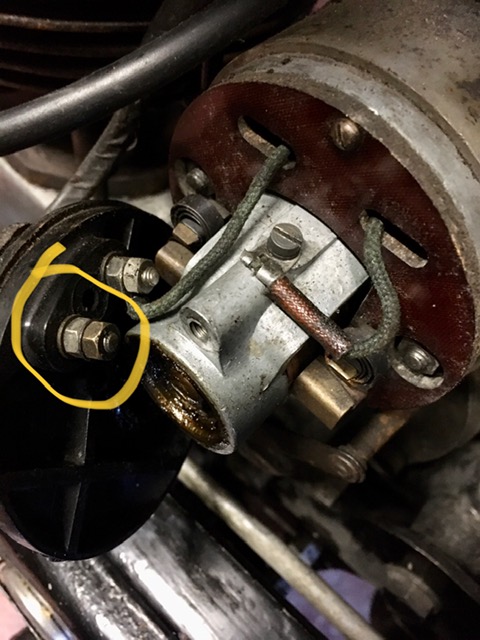

My ES2 magdyno has never had brushes in it although I have them. My question is what terminal(s) do they attach to?  Attached is a photo and I have highlighted the only vacant terminal I can see....do they both attach to that or ???
Some guidance would be appreciated!
Cheers, Ben Tomlin
... attaches to that terminal (which should then  go to the "D" terminal on the voltage regulator); the other to the earth screw along with the field coil which is already there.

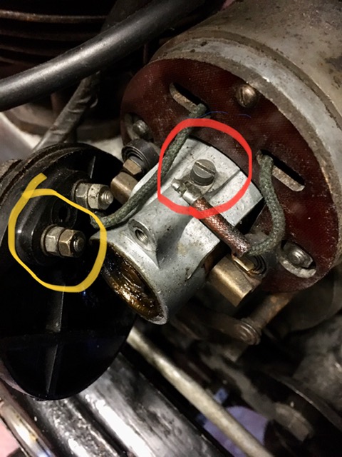

Thanks Ian, I assume the earth screw is the one highlighted in red on the attached photo?
The rotation direction is anticlockwise looking from the same end of as the photo, hope someone can clarify which brush goes to which terminal!
Cheers, Ben Tomlin
.. that's the earth.

Thanks Ian, much appreciated....now just need to know which brush / which terminal if somebody can help....
