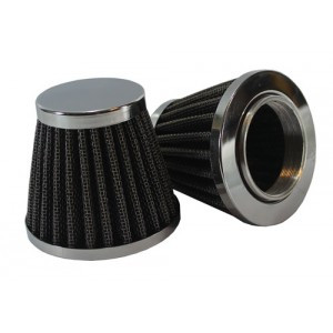

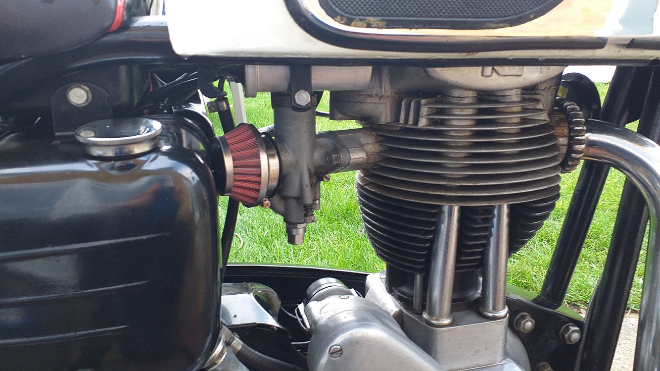

Air Filter fitted on Featherbed ES2
Hi to all following this subject. Thought I'd share with you the filter I have just managed to squeeze onto my 1959 ES2 carb. Bought it this week on Ebay for £3.99 inc. delivery. The bike is awaiting a test ride but I don't recon I'll notice any loss of performance! Yes it is forced in place up against the oil tank and slightly deformed in shape but should still filter the air as intended.

ps I like your filter Alan

Hi,Not knowing what these…
Hi,
Not knowing what these things are meant to look like, this is an air filter for single carb Featherbed Twin. Will it fit or possible to adapt?
Available from the NOC shop.

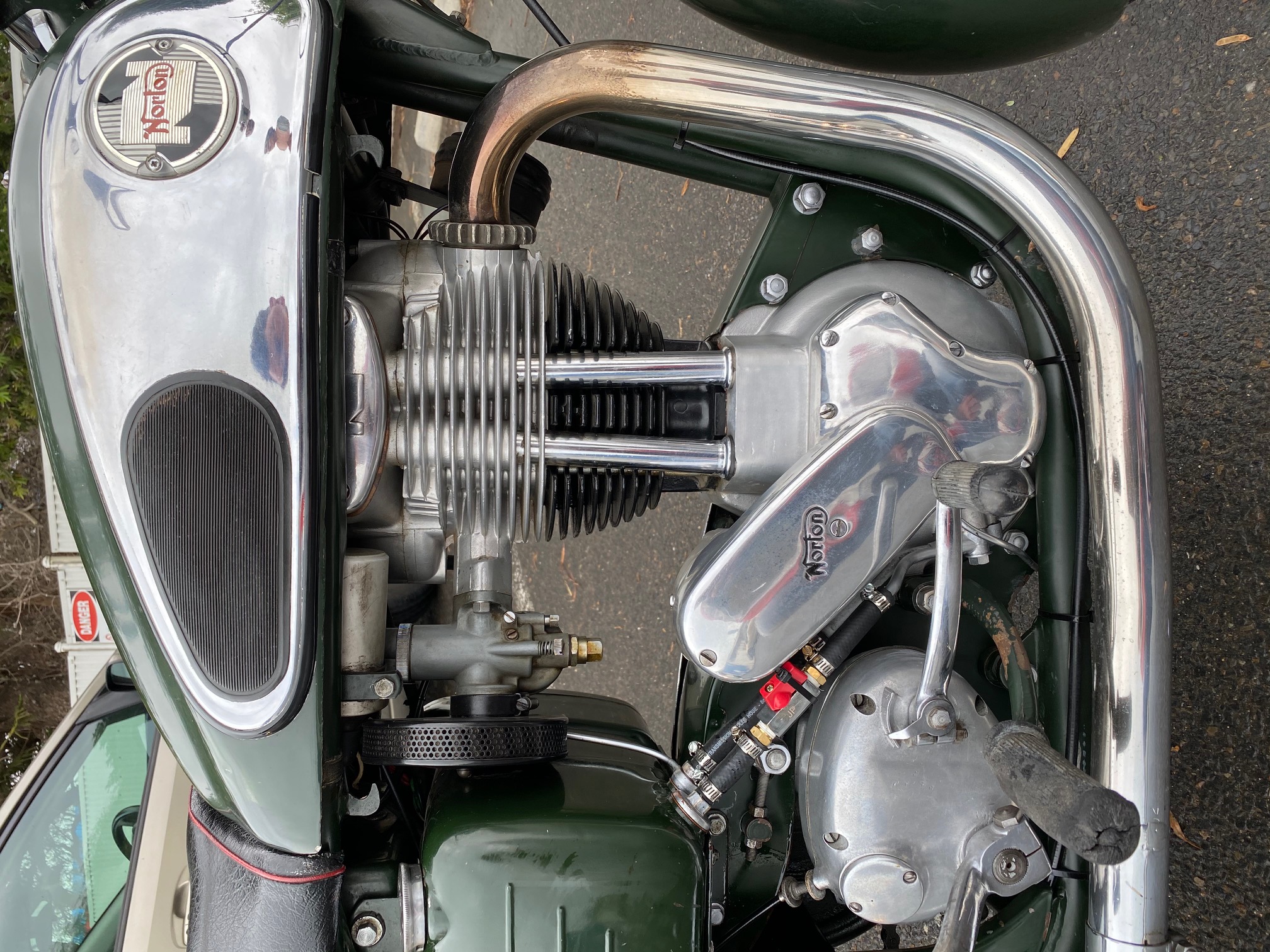

Hi, My 1959 Norton ES2 has…
Hi,
My 1959 Norton ES2 has a Vokes air filter, which I believe to be original.
See attached photo.
Jerome

Alan - that ebay filter which you say is bearing against your oil tank will surely vibrate its way through the paint and maybe the metal?
George
Ebay air filter
Yes good point George, maybe it would after a very long time!

Jerome - The picture of your ES2 is what I was hoping to see. I thought it could be done and your picture proves it. I don't see why some of these couldn't be manufactured, I will think about modifying a filter to fit like that.
Many thanks Jerome for your post.

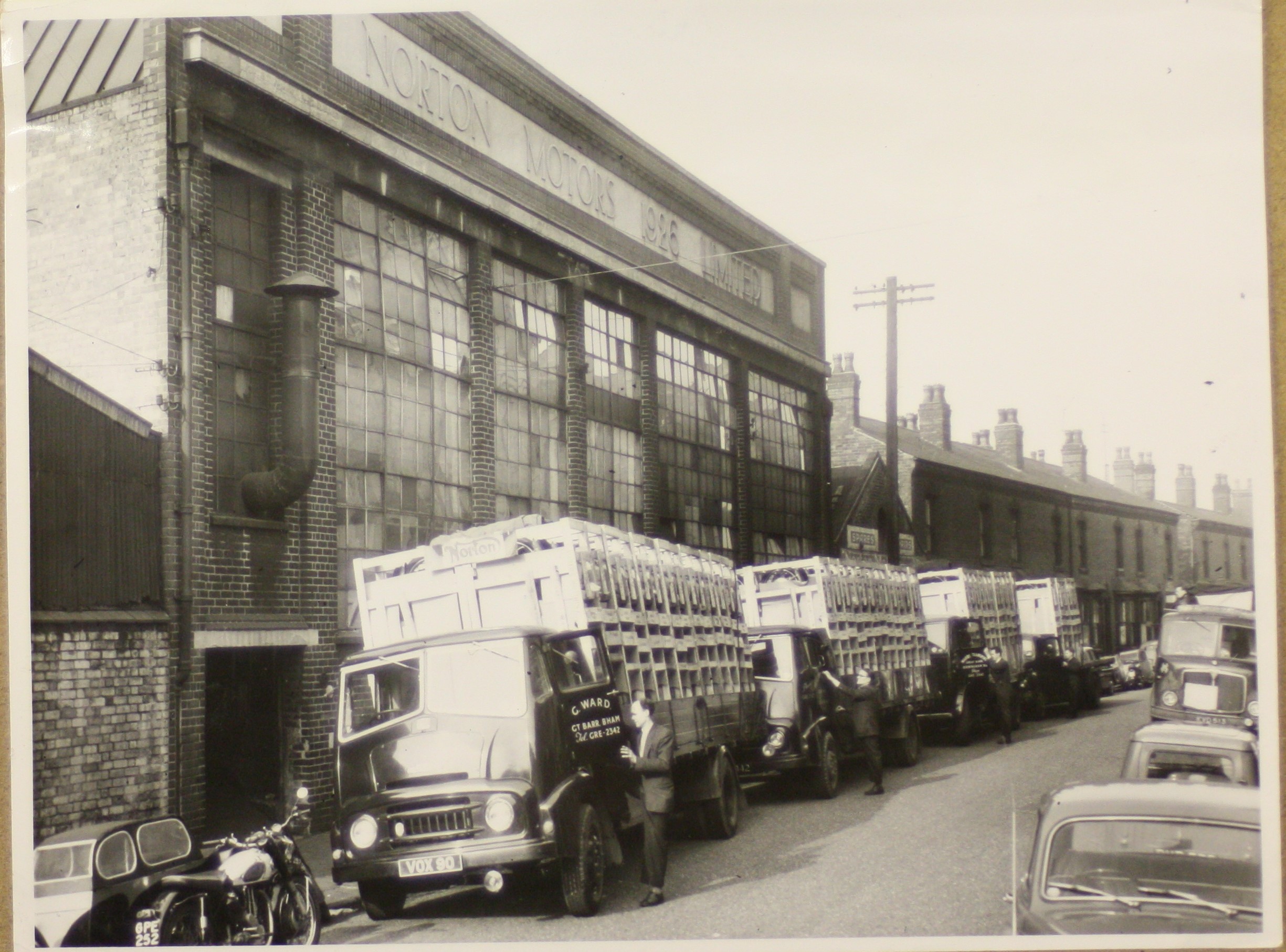

I hope that I have tracked down an original filter in the Czech Republic. ES2's were supplied to their police force in the 50's so perhaps air filters were fitted to the export and/or police versions. Peter Holland is also investigating the Vokes filter. Hopefully we will have some progress in the new year.
Air Filter for 50s ES2???
Tim:
Wouldn't the ES2s that you mentioned as being supplied to the Czech police in the 50s, have been the "garden gate" or single downtube framed units?
There is a large difference in regard to the available clearances between the single downtube units and the featherbed models.
Czech ES2s
They were delivered in 1959...I'm sure that they were Widelines and a couple were in regular use when the NOC held their first INR there. I don't seem to have photographed any though. The contract was widely reported in the press at the time, but I only have a scan of the crated photos.
