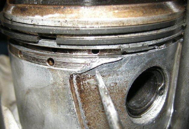

Finally, I have tracked down the knocking !!!
And this has been confirmed by two wiser and far moreexperienced friends.
Two circlips have been incorrectly used to retain the gudgeonpin and THREE of the eyes have broken off. These bits of shrapnel had theneroded the aluminium piston and parts thereof appear to have found their way tothe crank pin bearing and totally wrecking it. Despite 1/8â of vertical play(notice Iâm not measuring in thou!) the piston has not damaged the valves.
At the same time the oil control piston ring had becometrapped by a burr from the damage caused by the circlip eyes. This then seizedthe ring which then consequently broke.
So, all in all â?.. Iâm finally going to get my hands dirty!
