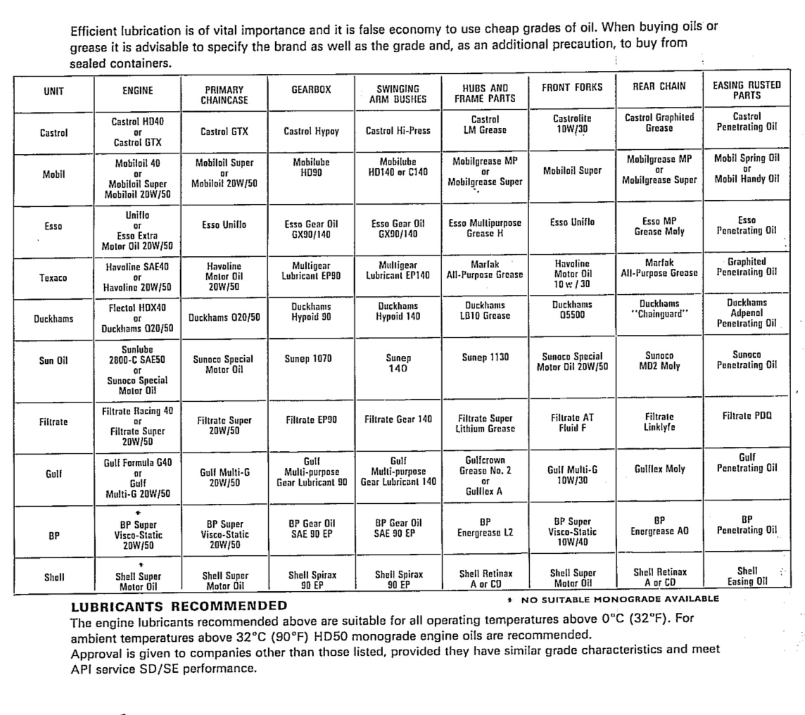

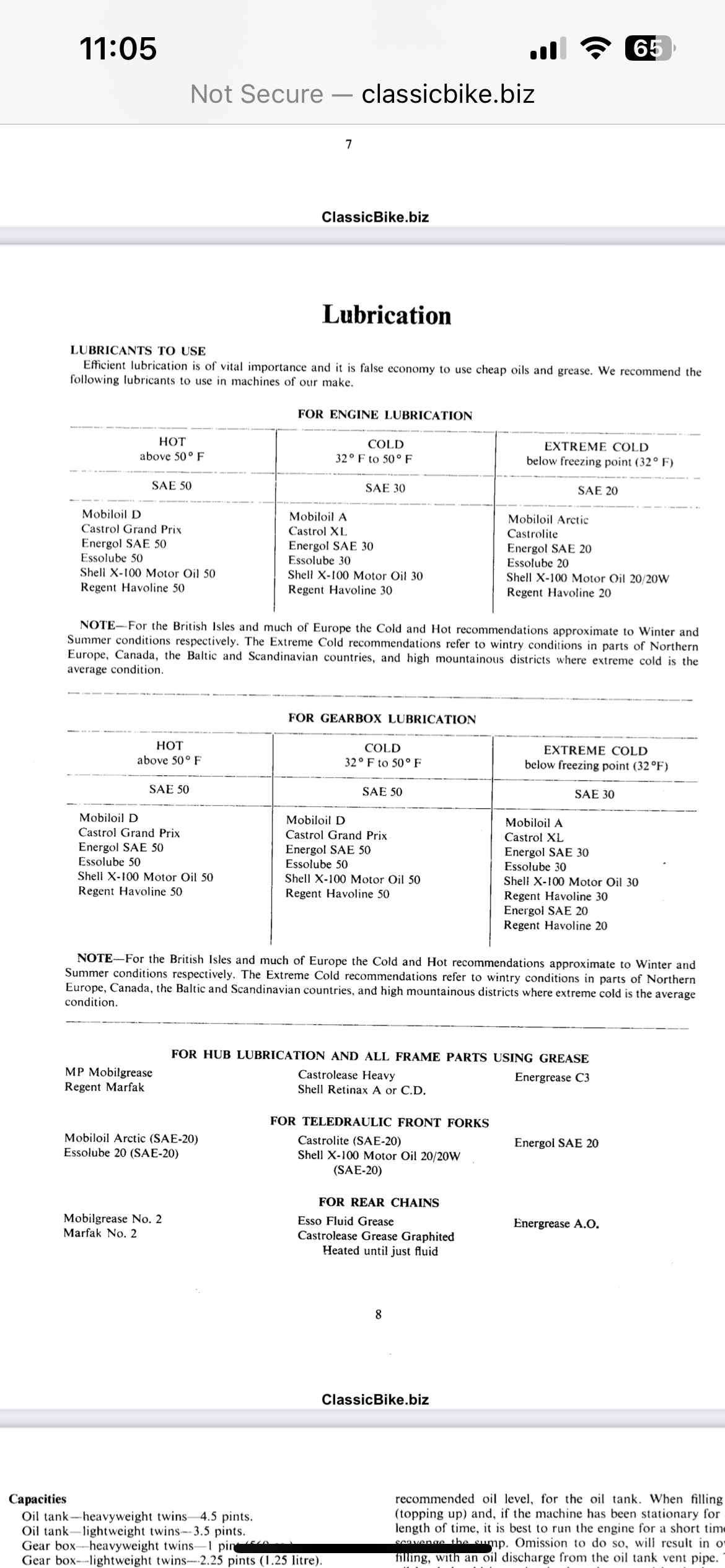

Please can someone advise me as to the best engine oil for my 1963 Norton 650ss to accommodate easy kick starting without compromising wear and tear ? Has anyone had experience with Castrol XXL40?
They said this:
Then they said this for…
Then they said this for Commandos, once 20W/50 multigrade was readily available and well-proven.
XL 20/50 came out very well…
XL 20/50 came out very well in tests on the Access Norton site .

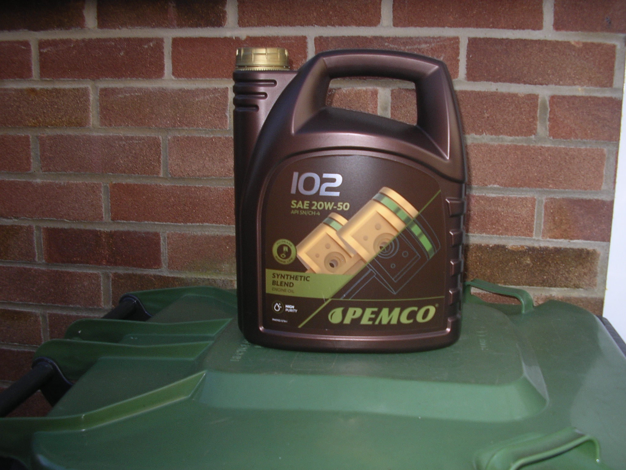

I have been trying out a fully synthetic 20W/50 oil for the last 3 months.
It is the B & Es of oil and solved many of my previous problems.
Firstly.......my 650 Dominator no longer lays down a smoke screen on a cold start-up each morning.
Secondly.......the engine has stopped burning oil. I am now topping the oil tank up with just 250 ml every 500 miles. With all other mineral 20W/50 oils I was waving goodbye to a pint for the same mileage.
On the back of the pot it says product of West Germany and prices vary wildly.
I managed to find a dealer having a sale and got 2 x 5L for just £32.
Thank you Philip I had not…
Thank you Philip I had not heard of Pemco before. If it is made in West Germany I think it is worth a try. Bit expensive but I noticed on the label it is a synthetic blend.
