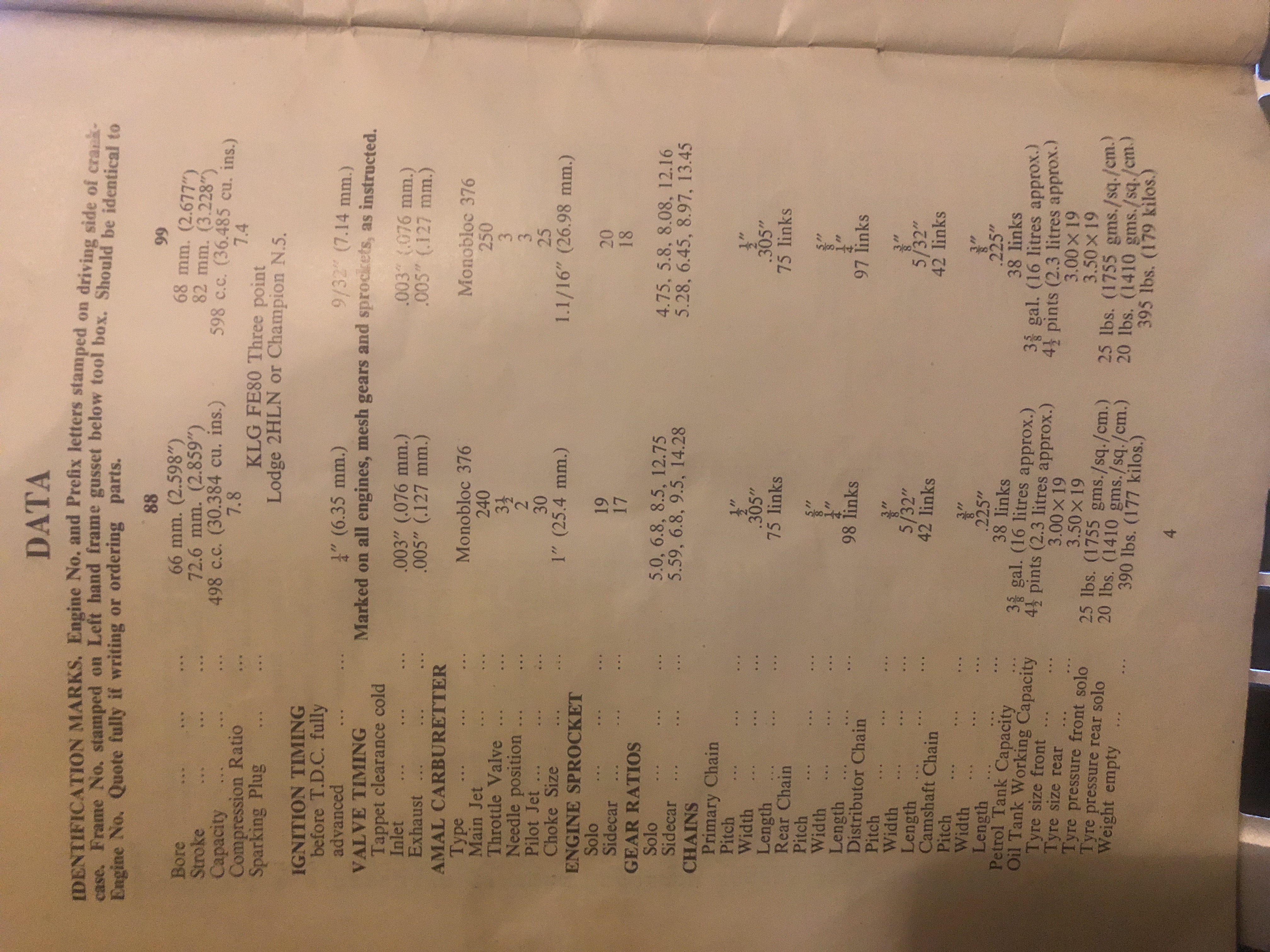

I want to check the ignition timing, Because it is electronic I am going to have to use a strobe light (for the first time). Can anyone advise what the degrees figure is fully advanced BTDC? The book I have assumes static timing only. (9/32" BTDC)

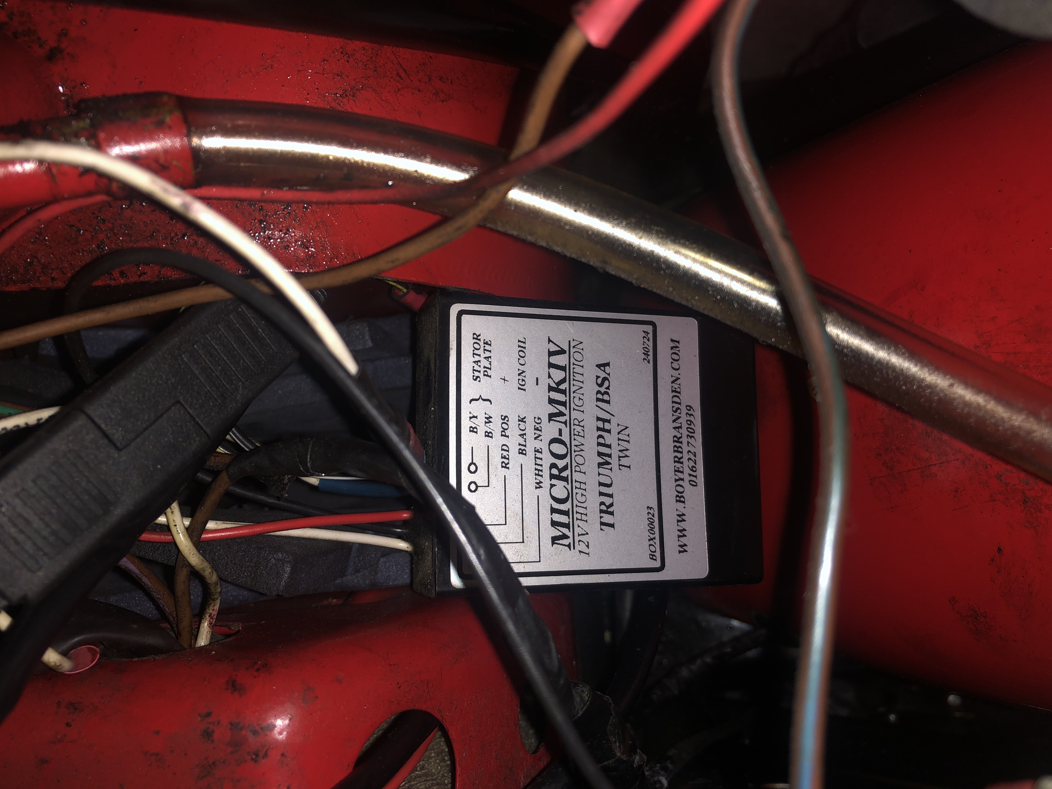

If anyone else has fitted electronic ignition to a Dominator 99, what product did you use. I was s bit disconcerted to find that the kit fitted to my bike is for a BSA/Triumph. I am wondering whether it is retarding as the revs increase instead of advancing?

Static means retarded . The book only quotes fully advanced .
I am no expert but the way I…
I am no expert but the way I have always timed old bikes is to statically time them at the fully advanced position (e.g. 9/32" BTDC). The figure given in the handbook is nearly always for the fully advanced position. It would either be necessary to wedge open the bob weights on an old auto advance/retard mechanism or set the manual adjustment on the magneto to fully advanced. With the piston set at the specified position, the contact points are then set just about to open (often using the traditional fag paper). In my understanding 'static' does not mean retarded it means what the word means. i.e. stationary, not moving.
Timing a bike with a static…
Timing a bike with a static engine is a common way of doing it with a mag or distributor and involves artificially advancing the timing to replicate what will happen at high revs.. it is however not the static timing . this is the measurement of the point of firing when the engine being turned over slowly as in starting. Not used much except sometimes to ensure that the bike will not kick back too much. If you ever owned a Ducati single built with 28 degrees advance static timing you would appreciate the difference ! . Bump start only . Not suitable for the road.
Look again at the data.and…
Look again at the data.and what you said. it states fully advanced , NOT static . if it were to quote static it would be closer to TDC perhaps 5 degrees before . Its not used or often quoted.

It seems we just have a difference in understanding what 'static' means in this context. For me it means timing the engine by setting the piston at the measurement figure given in the book BTDC. In tihs case 9/32" BTDC. This being the fully advanced position. Non static timing in my understanding is done by fitting a timing disc and marking up with pointers etc the number of degrees that fully advanced firing should occur BTDC. This for my bike I have been told is 32degrees. A strobe light is then used to check this with the engine running (i.e. not static). Degrees BTDC were not usually given in original books of machines of the 1950s because owners did not have strobe lights and timed their machines statically not with the engine running. I therefore believe the two figures are synonymous. Winding the piston down by 9/32" will indicate as 32degrees on a timing disk if it was fitted.

Regarding timing..out of curiosity, which manual do you have? My Haynes gives 32 degrees. My F Neill also has 32 degrees, as does Bacon.
Since the plugs at 30 degrees off the vertical, piston drop gets complicated to calculate and to use.

Further-the BSA/Triumph ignitions from Boyer Bransden and the Norton ones are exactly the same, the advance curve suits both engines.

First you'd better strobe time it to the recommended figure at Boyer's recommended RPM. Retarded timing will certainly limit your speed.

I am loath to take the primary chaincase off. It is oil tight and I want to keep it that way as long as possible. So I set the engine at TDC and the electronic stator plate seemed set up in the correct position. I then wound the engine back until a rod down the plug hole indicated that the piston was down by 7mm which is as near as dammit the correct figure. I then made a little paint mark on the plate where the spinning sensor thingie should be when fully advanced. I then fired it up and put the strobe on it. It seemed to me the sensor was not reaching my mark. There is a small adjustment on the plate and I slackened the nuts and advanced it as far as it would go. It is still not quite reaching my mark with the strobe but does seem much more willing to completely rev its nuts off.

When fully advanced the timing should be 32 deg. which probably equals the 9/32 advanced setting you (mistakenly) quote as the static setting.
