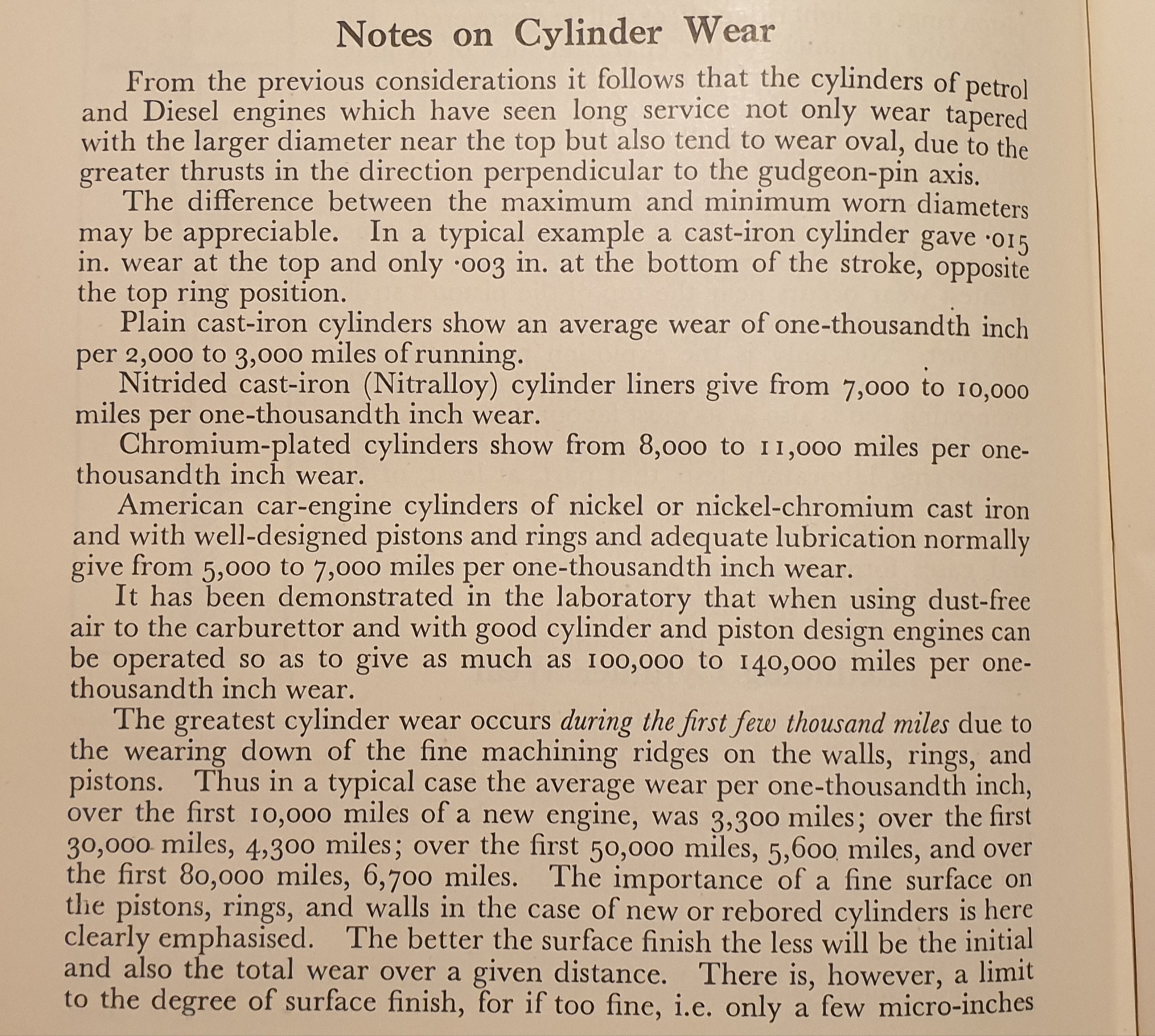

This is from "The Modern Motor Engineer" , 1952 edition. It suggests it might be as little as 16000 miles. Modern oils (and air cleaners) have made massive changes to engine lives.
