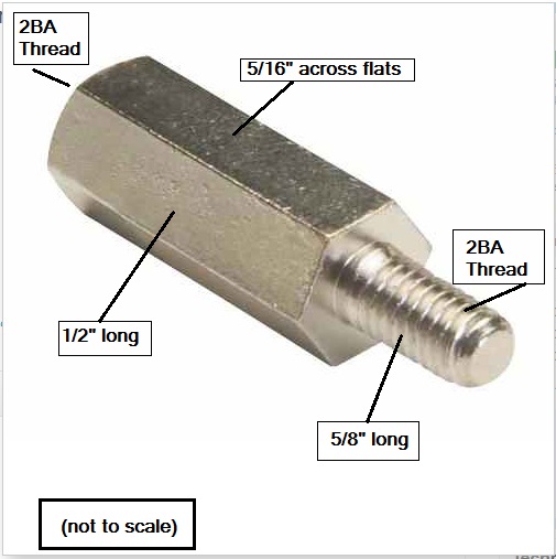

Here is a photo (not to scale) with dimensions.
From memory - the Commado one is different & cannot be used (I tried).
stand off
