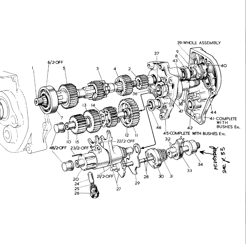

I am currently only able to get two gears when shifting my '65 Electra.  Since I'm not sure the gearbox was assembled correctly before I received the bike, I'd like to take everything out of the case and put it back in together properly.  While the assembly instructions in the Norton manual are pretty clear, about where each gear goes it doesn't specifically say which striker fork is supposed to engage gear (3) shown in the assembly diagram (fig. 45) and which engages gear (14). I was wondering if anyone had a photo that shows the assembly together outside the case that would show the striker forks in place?  Or can someone look at fig. 45 in the manual and tell me where each striker fork goes?

  I did mean the selector forks, although the manual calls them "striker forks."  Also my shifting problems are occurring while riding the bike.

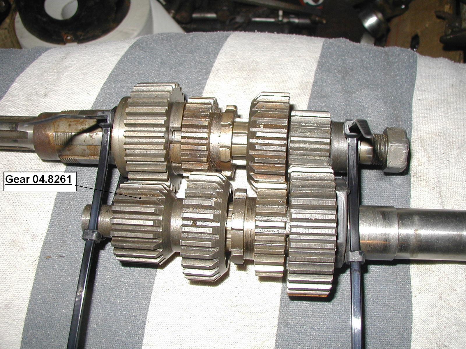

However, I can see by your earlier photo that the nearest fork (when looking into the gearbox) appears to be engaging gear 3rd gear (14 in the figure) on the layshaft and the farther one points upward and appears to engage gear 2nd gear (3) on the mainshaft.  This basically answers my question.  However, both your forks and the ones in my gearbox seem to be installed in reverse of the pair shown in figure 45.  Are the two interchangeable or is the illustration in error - like it is for spacer number 34?
The selectors are interchangeable but I’m away from my manual at the moment to make a comparison with my photos!
I see what you mean, I think the problem is that the manual has put the selector shaft in front of the other shafts when it is actually behind. They have used artistic licence to show the gears better. If you move the shaft to the other side the selectors have to rotate and the locating pin moves to the top, if you see what I mean!

The thread started with how to assemble this gearbox, and is there a picture of it outside the gearbox. The timing thing, as explained in the first two pictures is important. There is a mark on the drum (20 on Plate G) as shown on the lower pic above, and a mark on the ratchet plate (27 on Plate G) - visible in the first picture above. Plate G refers to the Parts List.
Instruction 52, 2nd Line (in the Electra Manual) tells you to line these up.
If you are using the Twins manual, then on page 45 "The Footchange assembly" explains
The two selector forks (21 on Plate G) are identical. The two grooves they sit in can be plainly seen.
