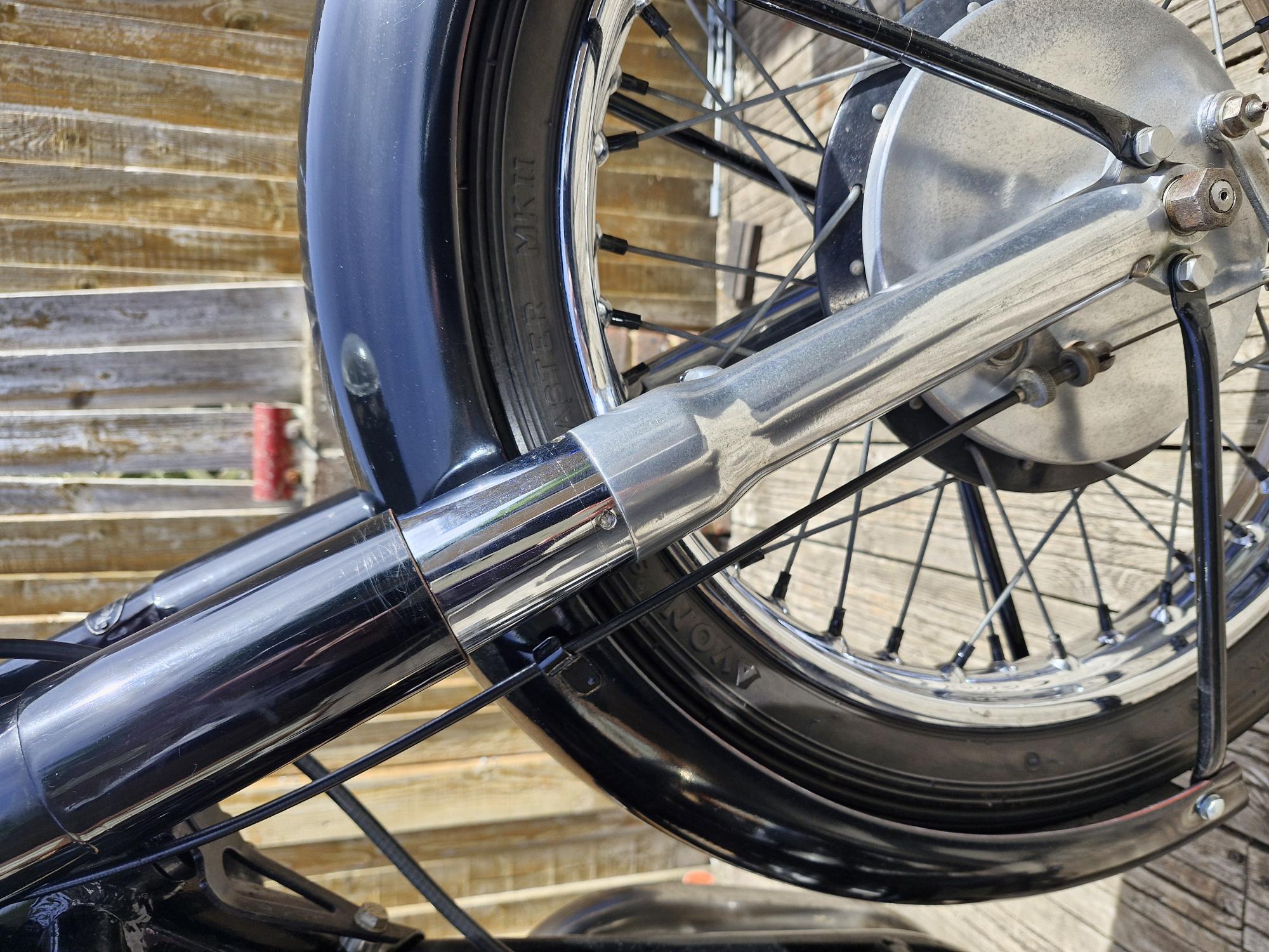

Has any body had this on a Dominator.
Where a gap opens up below the fork shroud .
Any info on this would be appreciated.
Andy
Hello Andy - It looks as…

Thanks Howard, I tapped out…
Thanks Howard, I tapped out the top nut as deep as it would allow, then reduced the width of the lock nut.
This has made a difference. There is a tiny gap now. I'm going to reduce the length of the damper rod only by 3/16" / 1/8", run the thread down a little more . Then it will tuck under fully.
By doing that you are…
By doing that you are reducing fork travel, I'm sure I read somewhere about the different length shrouds that were used, and I guess its possible that yours aren't the right ones? Or that you've got longer damper tubes. I think RGM give dimensions if it helps!

Hello Andy - It looks as though you haven't got the damper rod screwed properly into the top nut. It needs to be as far into the top nut thread as possible before you tighten the lock nut. Are both sides showing the gap ? Have you just reassembled the forks or has this gap just suddenly appeared ? The damper seems to have bottomed at the extent of the rods travel and the weight of the forks and front wheel are held by the damper nut alone. As you screw the damper rod further into the top nut the damper rod effectively shortens and the gap will disappear. I assume that the top nuts are fully engaged in the stanchion tubes. Good luck, Howard
