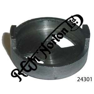

Is my cam, rotating and fixed plates all matched to open the breather at the correct time.
If not which of them is correct?
Will a correct match be obtained if I purchase a new rotating plate from RGM/Norvil?
I bought this as a box of bits and not everything was correct for the bike but these items looked ok. The cam, rotating plate and or stationary plate could be out of an earlier 88, Model 7, 77 or who knows what?
Any advise appreciated to finally eliminate this problem.

The breather should open whenever the pistons are on the way down so every 180 degrees of camshaft rotation and for a duration of 90 degrees camshaft so the arrangement in your photo looks right to me.
The holes in the rotating plate are in-line horizontally at every TDC and the slots in the static plate are just getting uncovered.

Thanks for your reply Jonathan.
Do you mean my assembly would present the holes in the rotating plate horizontal at TDC or that's the way it should be?
The camshaft rotates clockwise looking from the RHS and the static plate holes sit diametrically from 1 o'clock to 7 o'clock so if the rotating plate holes are horizontal at TDC then the breather is closed as the Pistons move downwards until about 90 deg rotation when the holes start to line up and open. That doesn't seem right? Thoughts?
Sorry, I am wrong about camshaft rotation it is rotating anti-clockwise of course. Looks like from a horiz position mine would just be starting to open!

Hi Jon...I have the later timing disc in my early 500 Dommi engine which I also noticed had different timing but as Phil said above and Roy Bacon in his restoration book this was changed. My old disc was mutilated so I had to use the new version, but after reading this was a later mod felt comfortable with it. In my case, the engine has been so far absolutely oil tight so the new disc must be working OK. The only problem with my engine is that the wet sumping oil gets pumped out of the breather if it has collected but I'm sure it would do this with the old disc fitted too.
I can only assume the late timing allows just enough pressure to build up so that when it does there is a definite spurt of positive pressure out from the breather, and just like valve timing, the slug of gas discharging due to momentum continues to exhaust as the piston rises. Another thing is that the actual opening period of the valve crankshaft wise is the width of the slot in degrees multiplied by x4* (cam runs at half engine speed)..not just when they are completely open in line. Should you wish to test the opening period you simply have to blow into the breather pipe and turn the engine and you will be able to sense by mouth pressure when the valve starts to open and then fully closes.
You have to remember that the engine is revving at most times from 2000 -5000RPM so the shot of expelled gas is traveling at some force, but I have also to say there should be a partial vacuum created as long as there isn't too much blow by past the pistons.

It is actually width of rotating slot PLUS width of static slot. Remember the slot rotates past another slot not past a line.
Yours looks correct. The driving slots in the end of the camshaft are always vertical at TDC so the plate slots are horizontal. I have only ever seen one kind so Phil or Les will tell you if yours is preferred or upgradable.

From the above info and assuming the rotating disc holes cover about 45 deg each, then my current disc would have the vent opening from TDC and would have closed around BDC. Apparently no pressure would thus be able to build up. With the new type, the crank would be around halfway down before the vent starts opening so some pressure would have built up before opening. Much as you said in your 1st response Les
I am currently feeding the breather pipe to the oil tank which, I believe, came in early 1960s. Perhaps I should vent directly to atmos

I have now checked the opening of the breather on my bike which has the original disc fitted (3 and 9 o'clock type)
My dial gauge only covers the first couple of mm of travel so not much use. My figures using pen and paintbrush are a bit rough but I think it serves to indicate the difference.
Opening appears to start around 15mm BTDC and appears to be closed at BDC. From my calculation this means mine opens around 55Deg BTDC and is closed at BDC - the point of highest pressure!
With a 5mm BTDC opening yours appears to open at 30deg BTDC and closes 30Deg ABDC which sounds quite good. Looks like the new type is the way to go!
