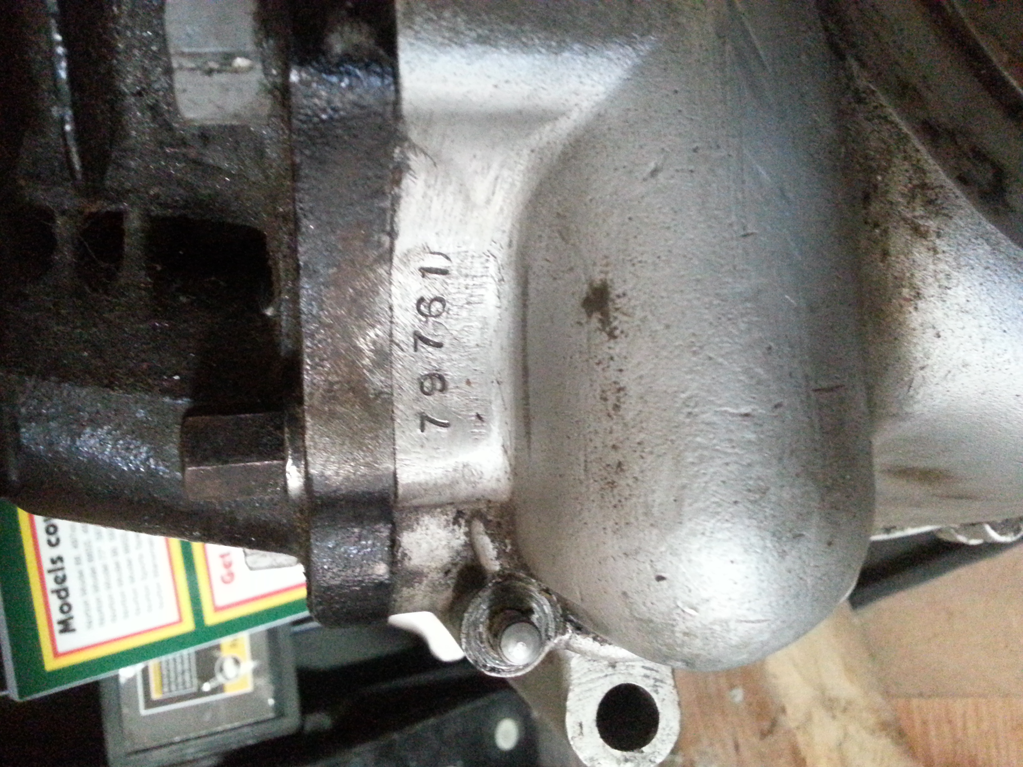

Hi, I bought a collection of Norton stuff on Evil Bay in 2017 & have just got round to looking at it properly! On one 99 engine, the Crankcase number has, (because I now know a little more, a little knowledge is a dangerous thing), been re-stamped in non- Bracebridge Street font! Is there any way of identifying the cases from Internal numbers or "X" ray scan technology?
I am trying to be positive as a Life-long motorcycle enthusiast, BSA, Honda, Kawasaki 70s & 80s , BMW 2000s, now innocently sucked in, (lack of research on my part), to the now often seemingly "dodgy" world of Evil Bay and 21st century, Classic bike Ownership!
Any suggestions appreciated!

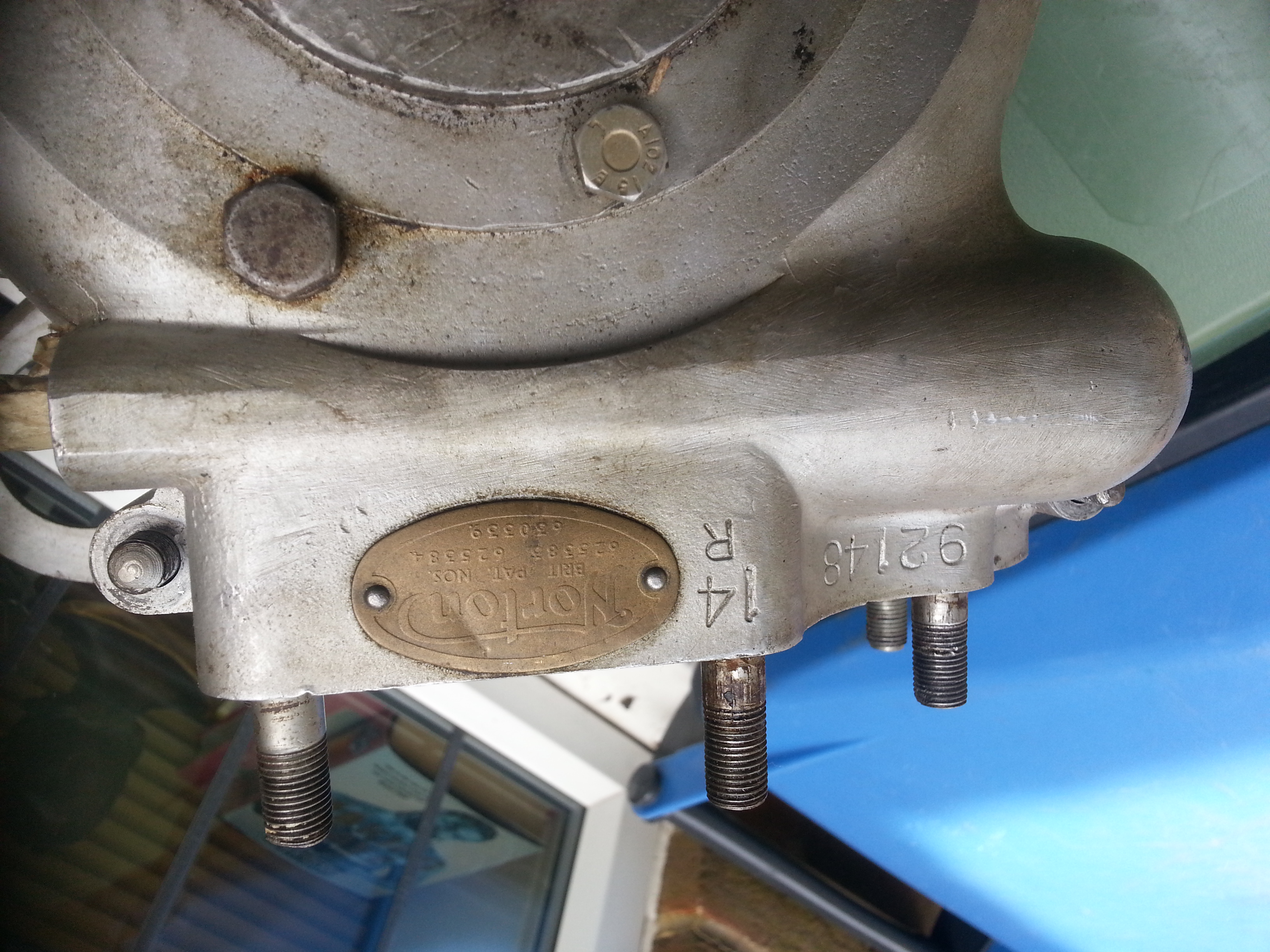

Photo shows I believe authentic stamping of Engine type, Engine number not so
John H
The image you've shown seems…

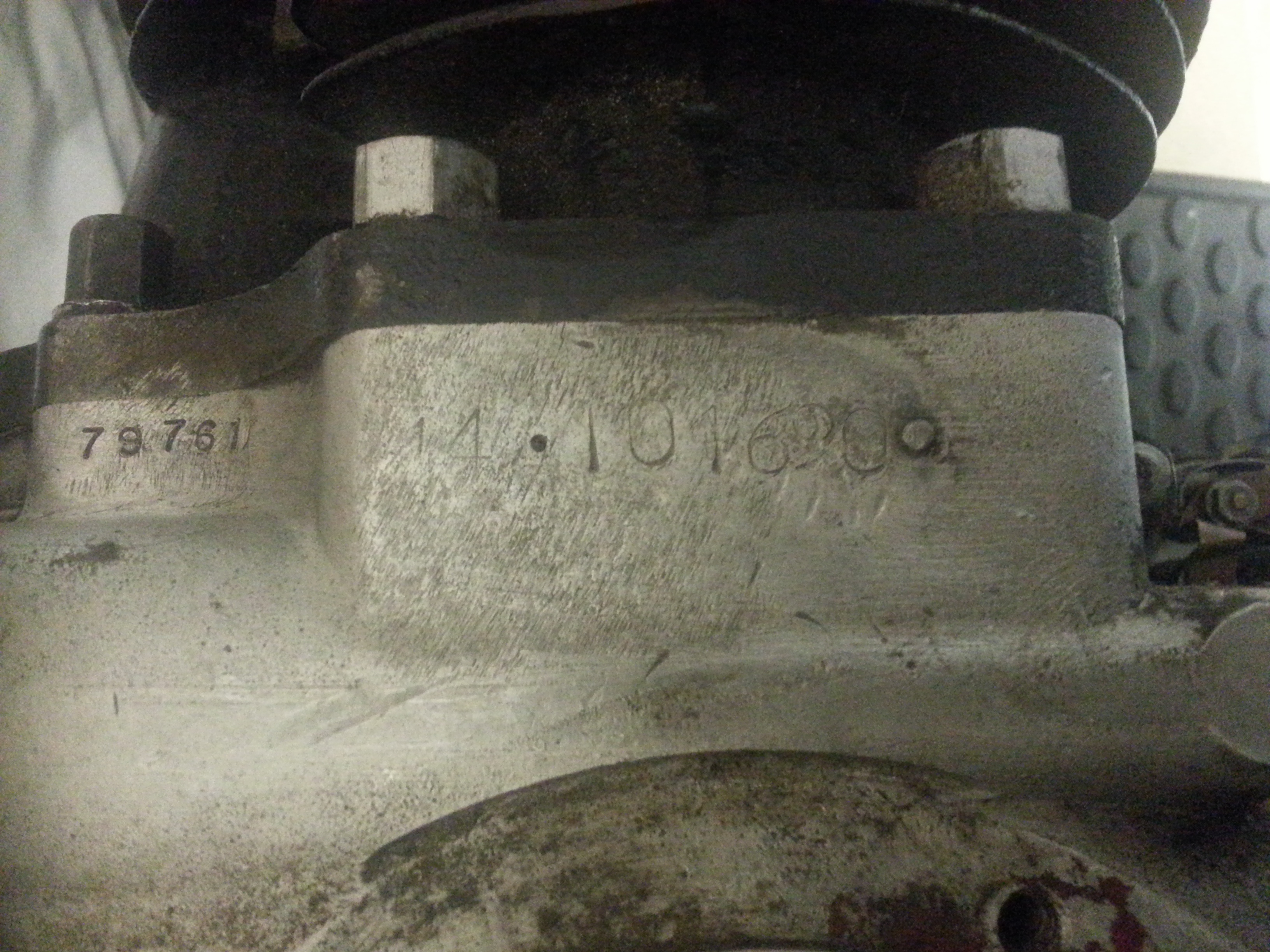

Engine number
The engine number that you have shown is the Engine Shop number, so your 99, must have been the 49th one built. I saw a 1958 500 Norton Nomad on Ebay, once and it had a 132*** Commando number stamped on it. If you contact the NOC twins records officer, he can look through the factory dispatch records, for your 99 49 Engine Shop number, and find out exactly what your engine number should be, as well as to who and where it was dispatched to.
As you say - it doesn't look…
As you say - it doesn't look good. The engine number was assigned to a late 1955 600cc Model 99. The engine number would have had the Code L14 somewhere around the Patents badge. The actual number will have been approx 15000 units earlier than the number now shown - 79761. I would be inclined to look for a more complete and useable set of cases. Have a look at your frame gearbox etc and decide what you want your Norton to be. If you decide on one of the first Model 99's with dynamo, Burman type gearbox and clutch etc then you should find suitable replacements. It your frame is from a later period with alternator, AMC gearbox and clutch etc then buy to suit that choice. Have fun and be careful buying from e-bay. Cheers, howard
Barrel and cases. look…
Barrel and cases. look alternator type to me likely from 59 to 62 ish. Is it registered ? Could be stolen or unmatched case halves. Could work ok but may be a problem getting it registered. What frame do you have.?.

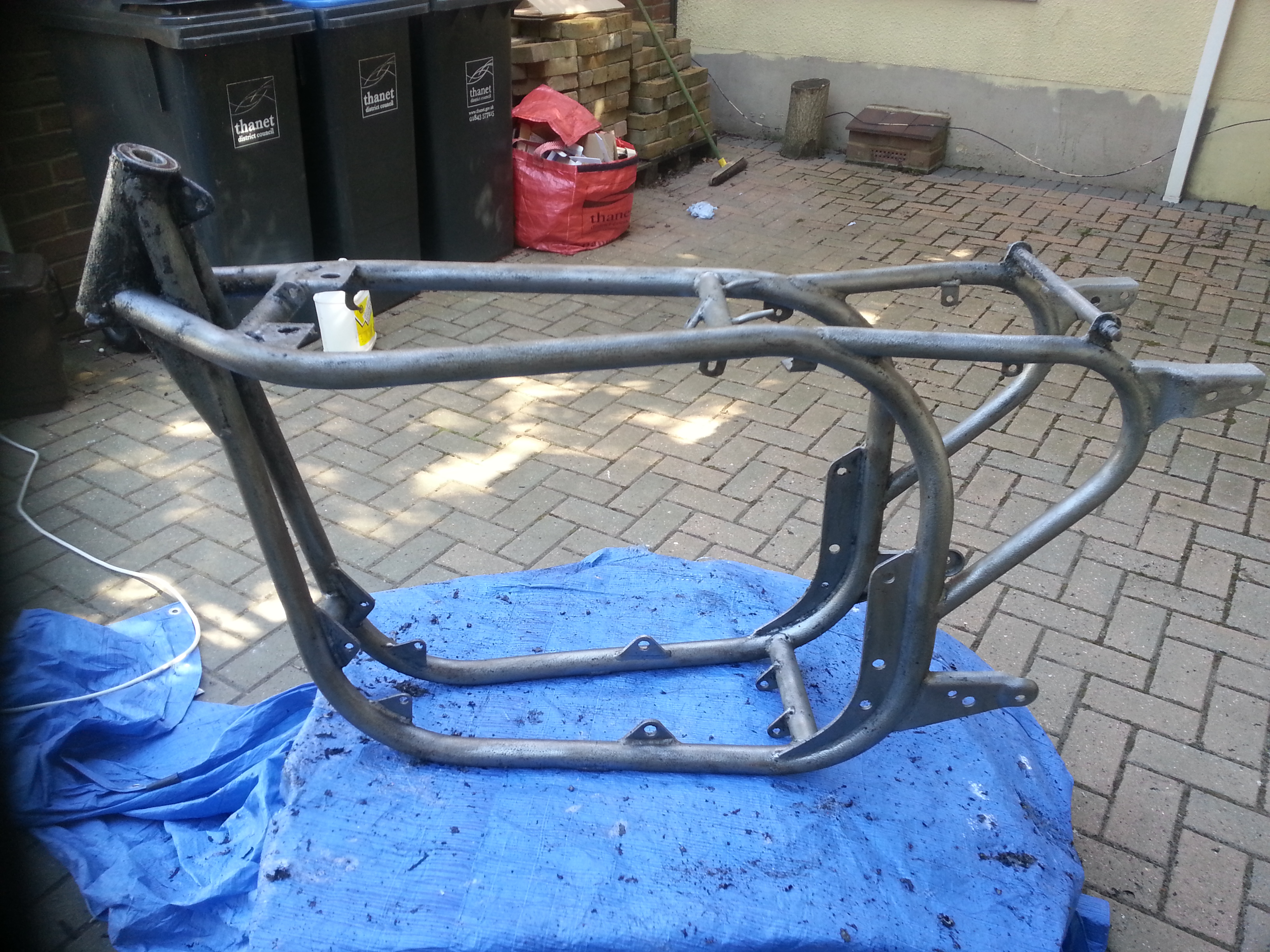

Frame
Some electronic correspondence was eventually passed over to me, after I bought it and found out that it the frame had never been registered in the UK! Again someone had tried to alter the Model designation code, to a 14, but it has a 1 and more+ of a cross stamped on it, it should be an 18 of course.
From Dave Catton to previous owner "The frame you have with number 101690 is from a 650SS and dates from 22nd February 1962. The machine with this frame number did go to Hamburg when new. Someone has tried to make them a matching pair by stamping the frame number on the side of the crankcase. This is the wrong place for the engine number.

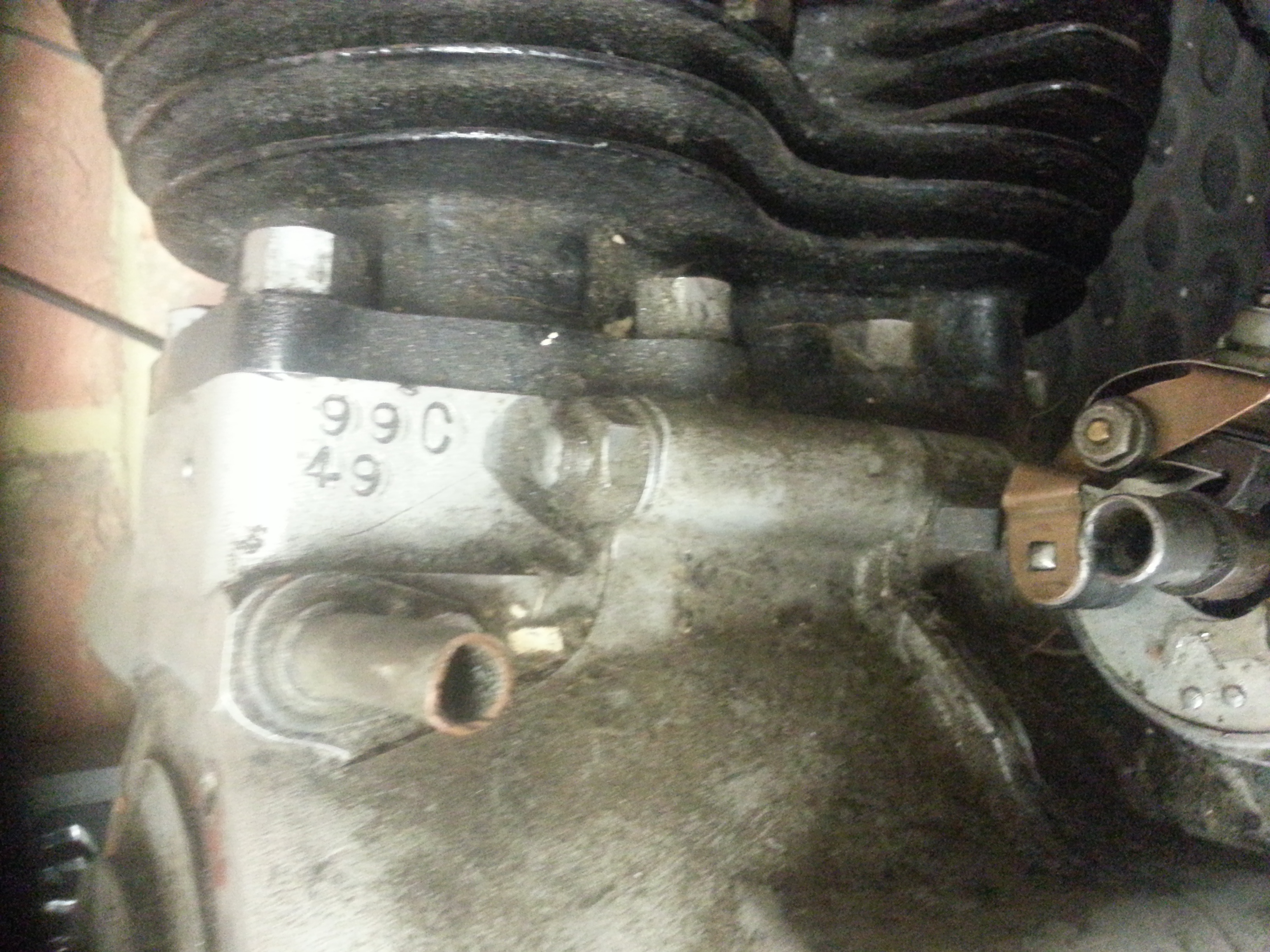

The number that is in the correct place 79701 is from a Dominator 99 and dates from 22nd October 1958, but the Shop No. you sent me does not equate to this engine number. This engine went new to a UK dealer.
The Shop No. 99C 49 dates it from 5th September 1957 and obviously has a different engine number!

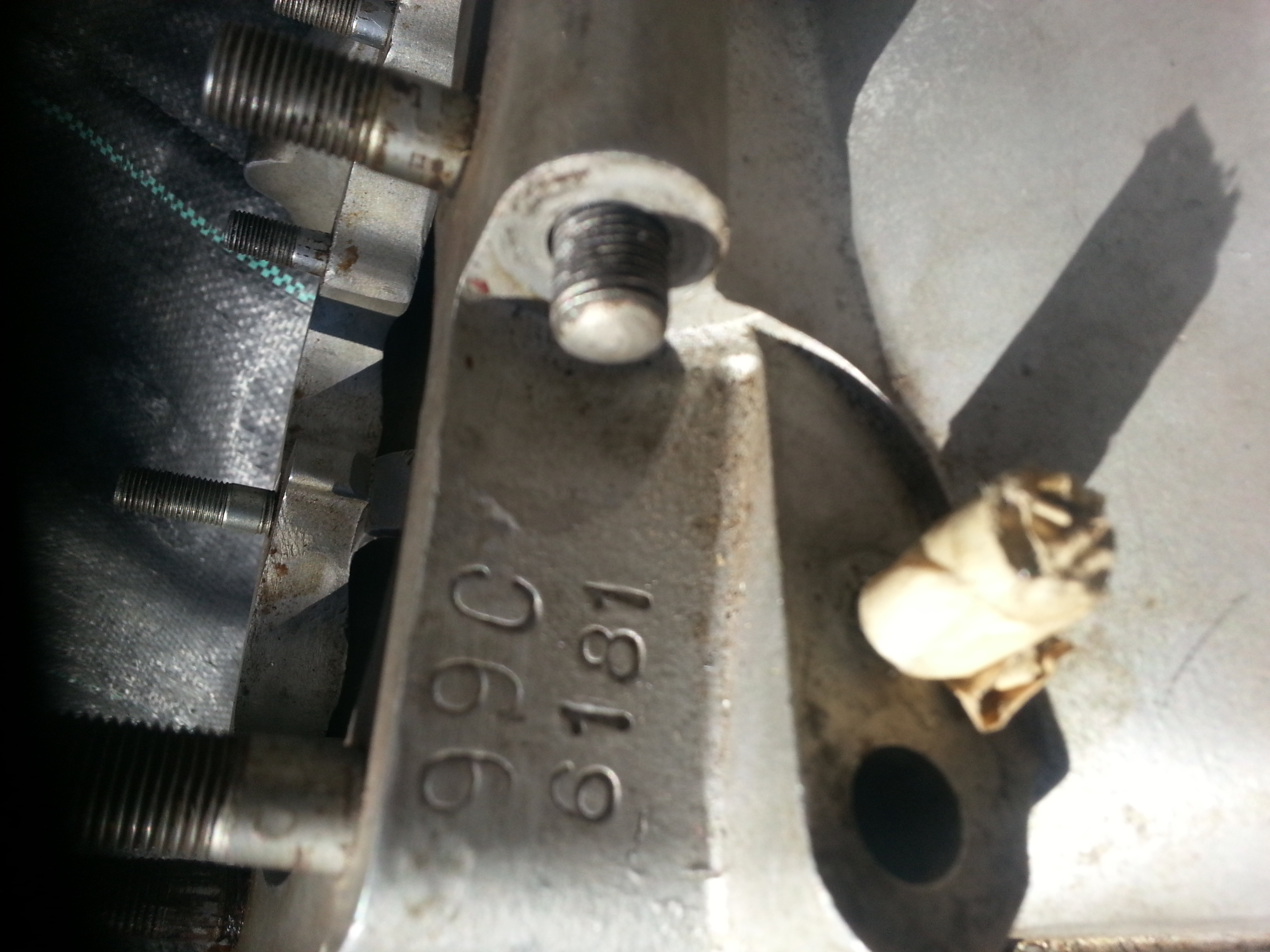

If you just register it with the number it now has, I doubt if there would be any problems. But now you know a bit about it, it has become something to worry about. Pity you cannot register (or try to register) it before spending time restoring it just to protect from the remote possibility that anyone at DVLA knows or cares about Norton's numbering system. After all...we can retain the registration on a pile of parts that used to be a bike, but not as far as I know vice versa.
Sounds possible that they…
Sounds possible that they are matched case halves, Made in late 57 and would have been logged as a 58 model, normal practise for Norton. So you can build a 99 engined 650ss . Must have been one of the early coil ignition Dommies .What type of head do you have?.

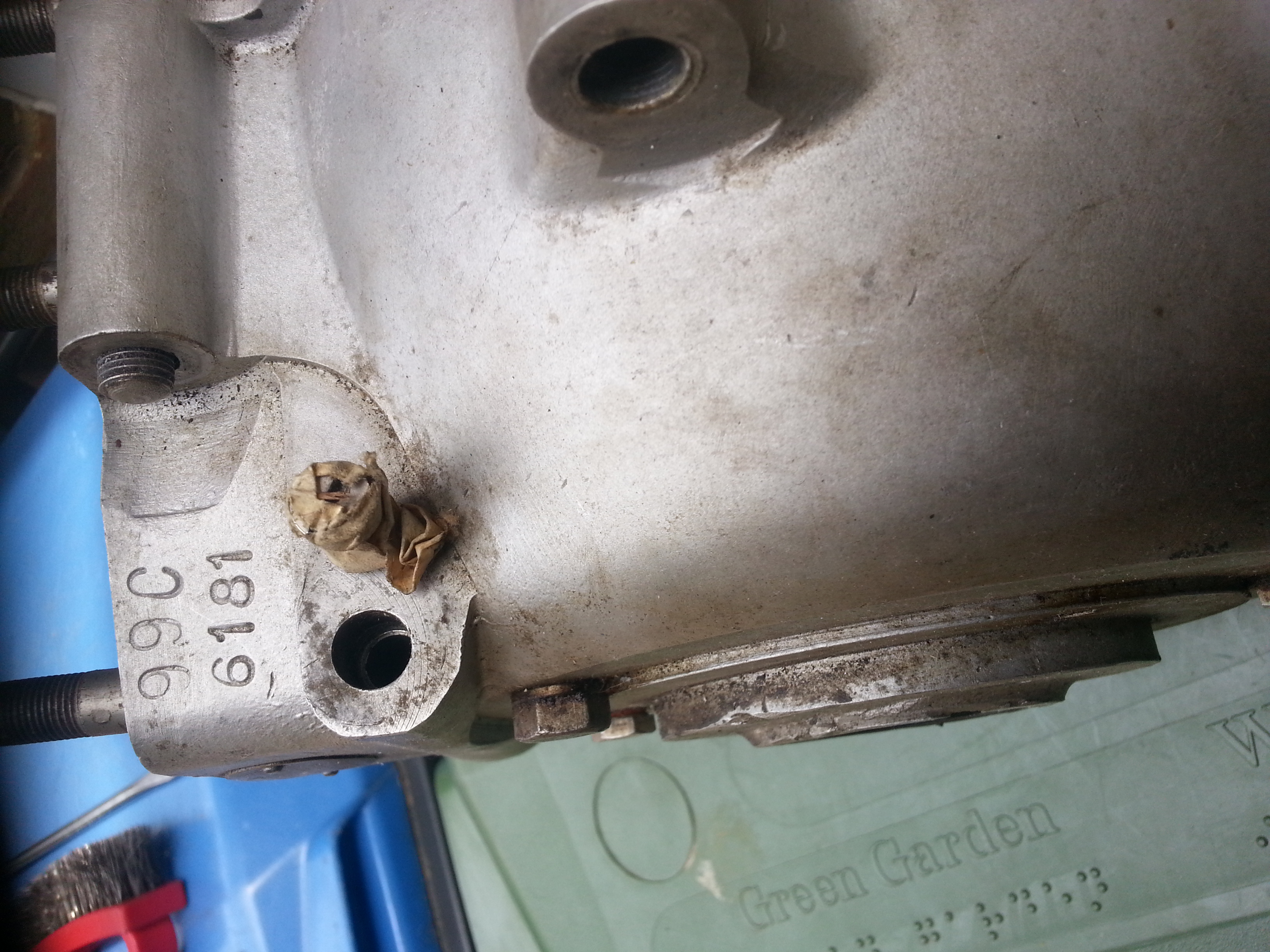

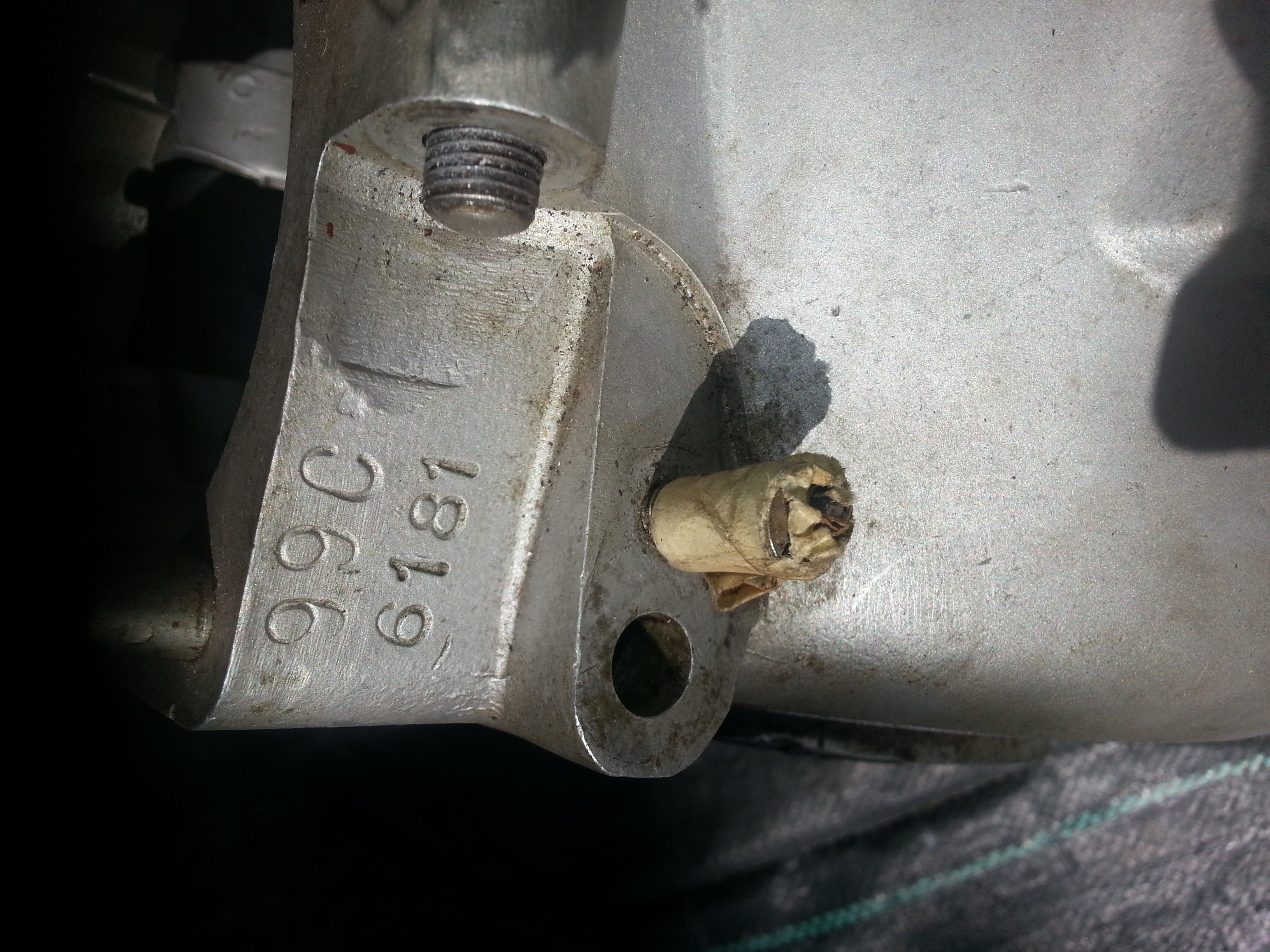

Plus some 99 C crankcases 92148 14R, 99 C 6181, it is, just the complete engine that has the dodgy stampings!

Looks like a nice straight…
Looks like a nice straight frame. Worth a few basic checks with straight edges and string lines before painting. The early engine will need a dynamo and mag and really should be in a wideline ,so I would build another bike !, The 99c motor could run a dissy or mag and 12v Alternator , And look like an early 99SS if that's your style. I would buy a 650 crank and rods ,mix with what you have ,(modify a case for more room) and build a 650 with a bit more reliability than the 99. All to his own.

99 C engine mis-stamped;

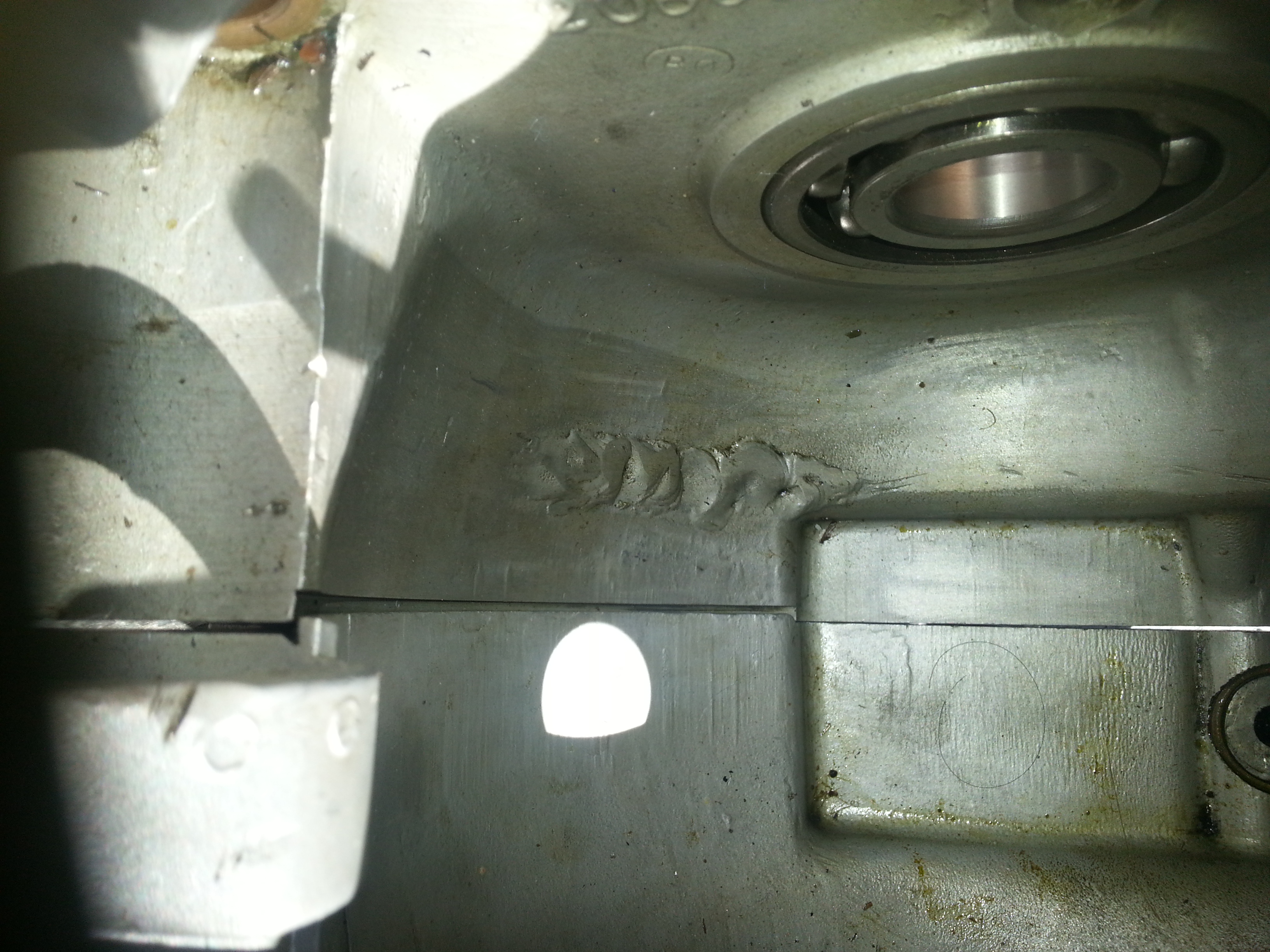

New cases some repaired damage! Thrown a rod maybe!

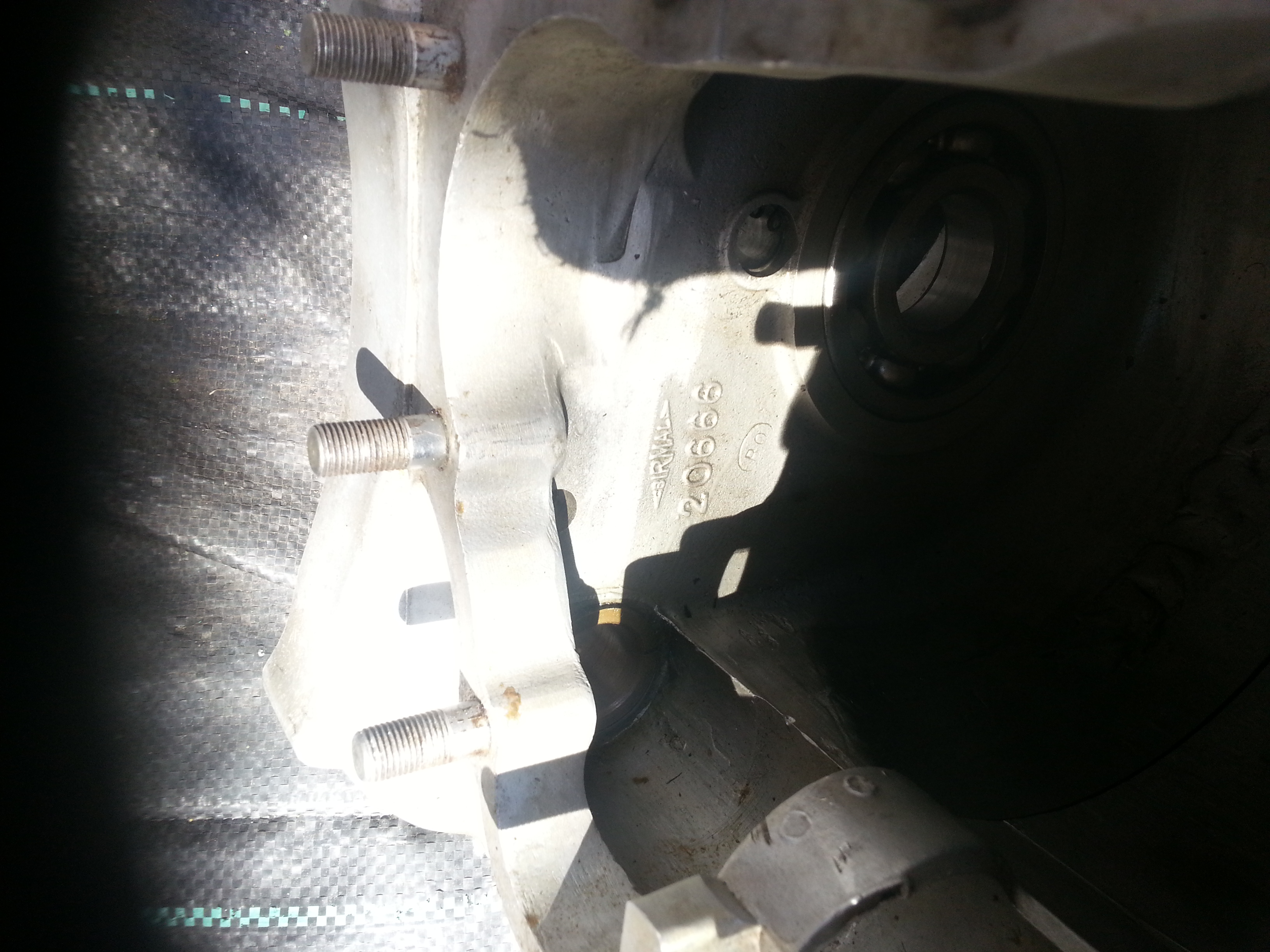

Got found my spare set of Cases see numbers!
John

The image you've shown seems to be ok to me - but what is the number like on the left-hand crankcase curved part ? Cheers, howard
