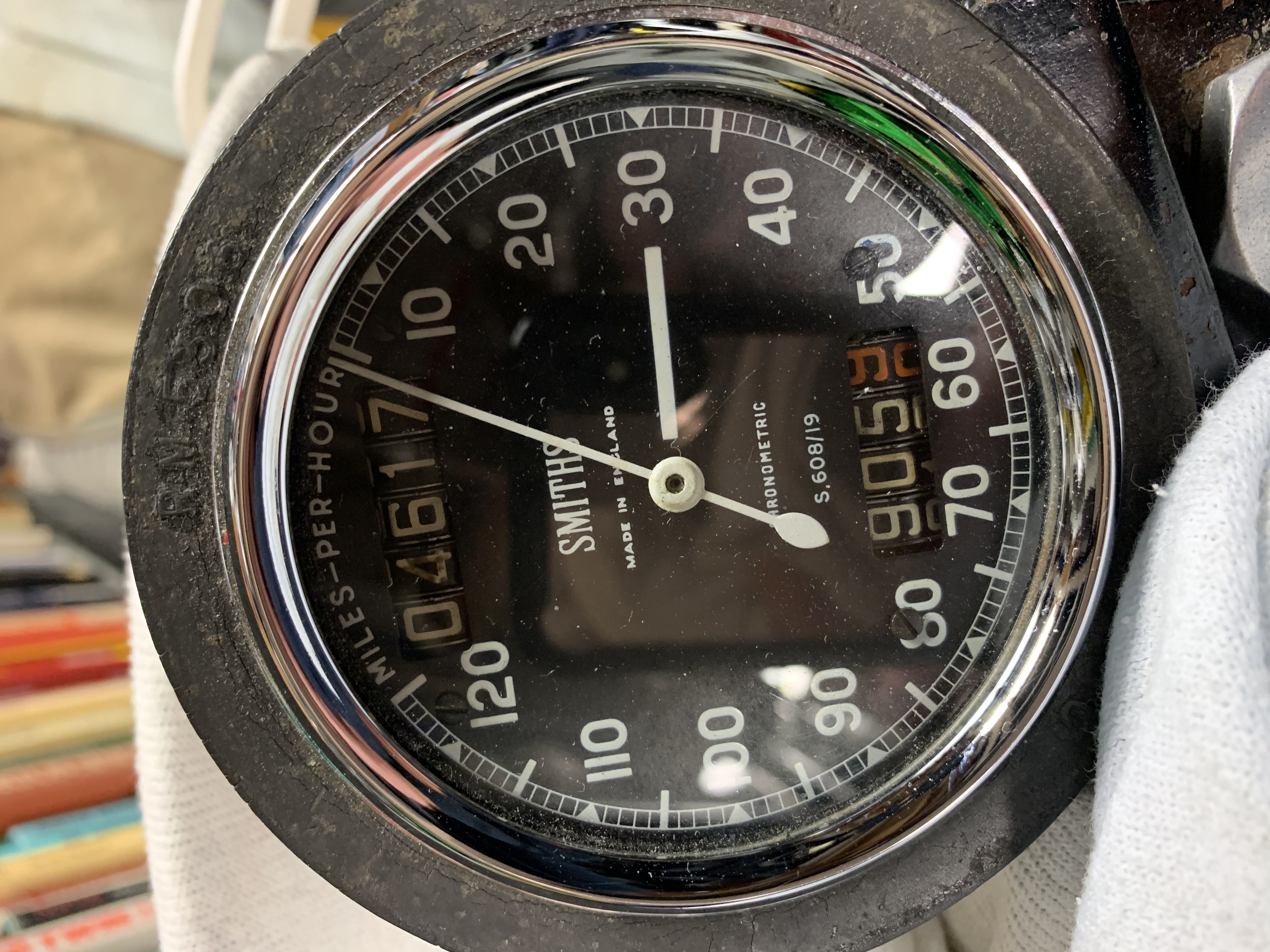

Inter Speedo
This is the Smiths one I have on my Inter engined ‘49/50 plunger Manx. same face but different model numbers

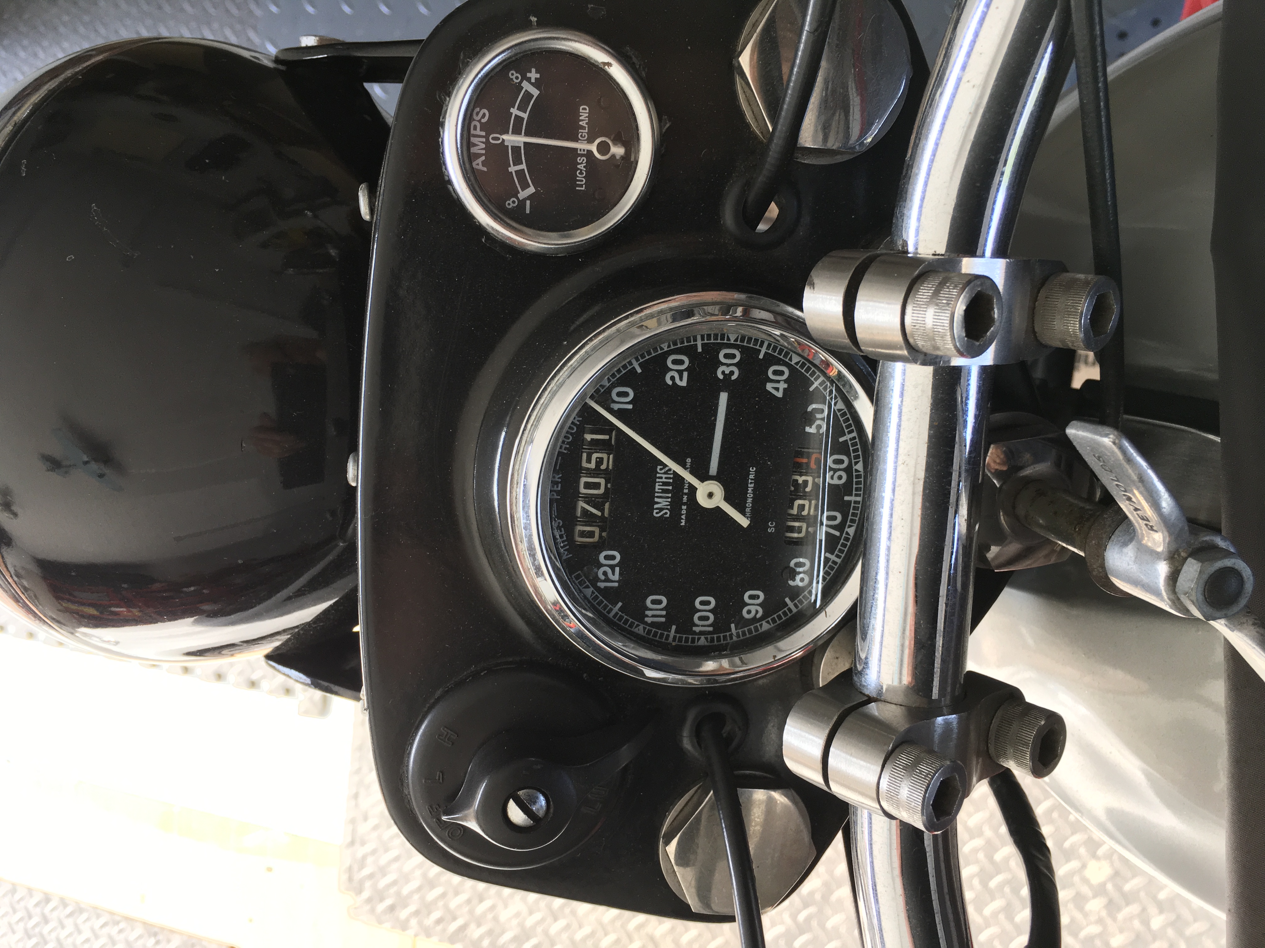

SPEEDO DASHBOARD PHOTO FROM MY ‘53 INTER
James,
Please find below a photo from my ‘53 Inter Clubman’s Special showing the “dashboard” arrangement and speedo. As far as I know it is correct.
Anthony Bolton
James,
I have a 1953 Inter whose speedo looks exactly the same as the photo you posted.
Anthony Bolton
