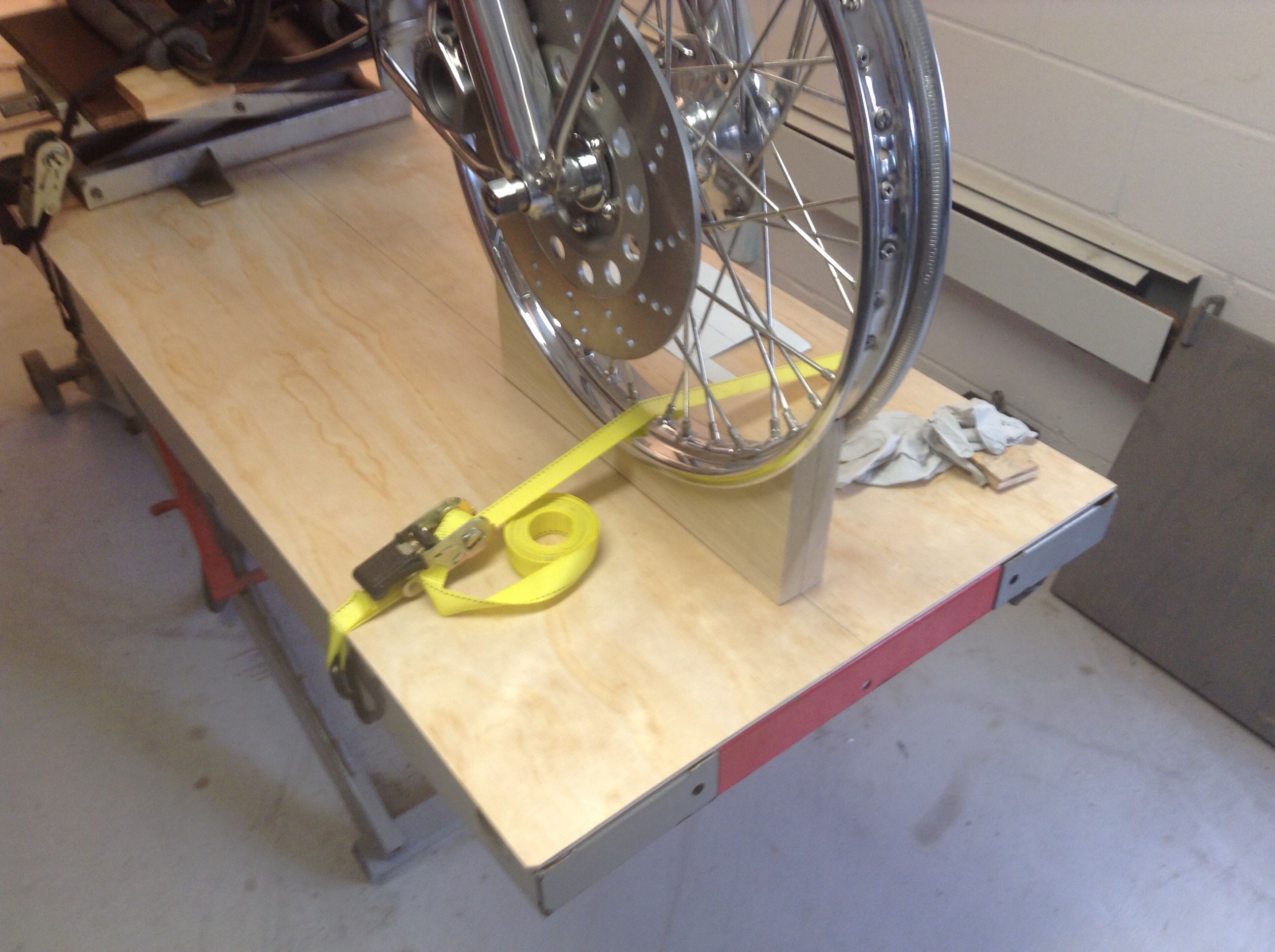

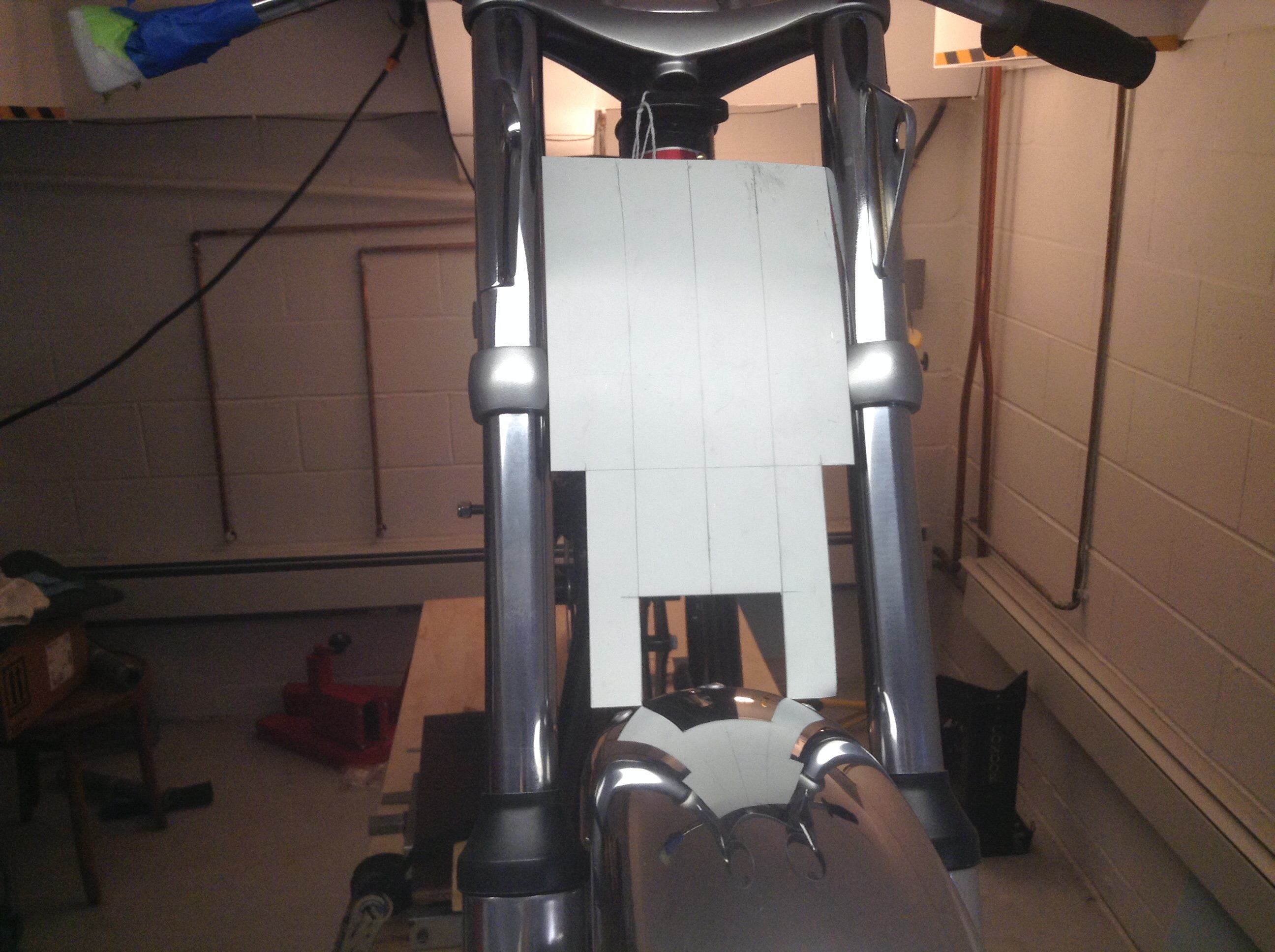

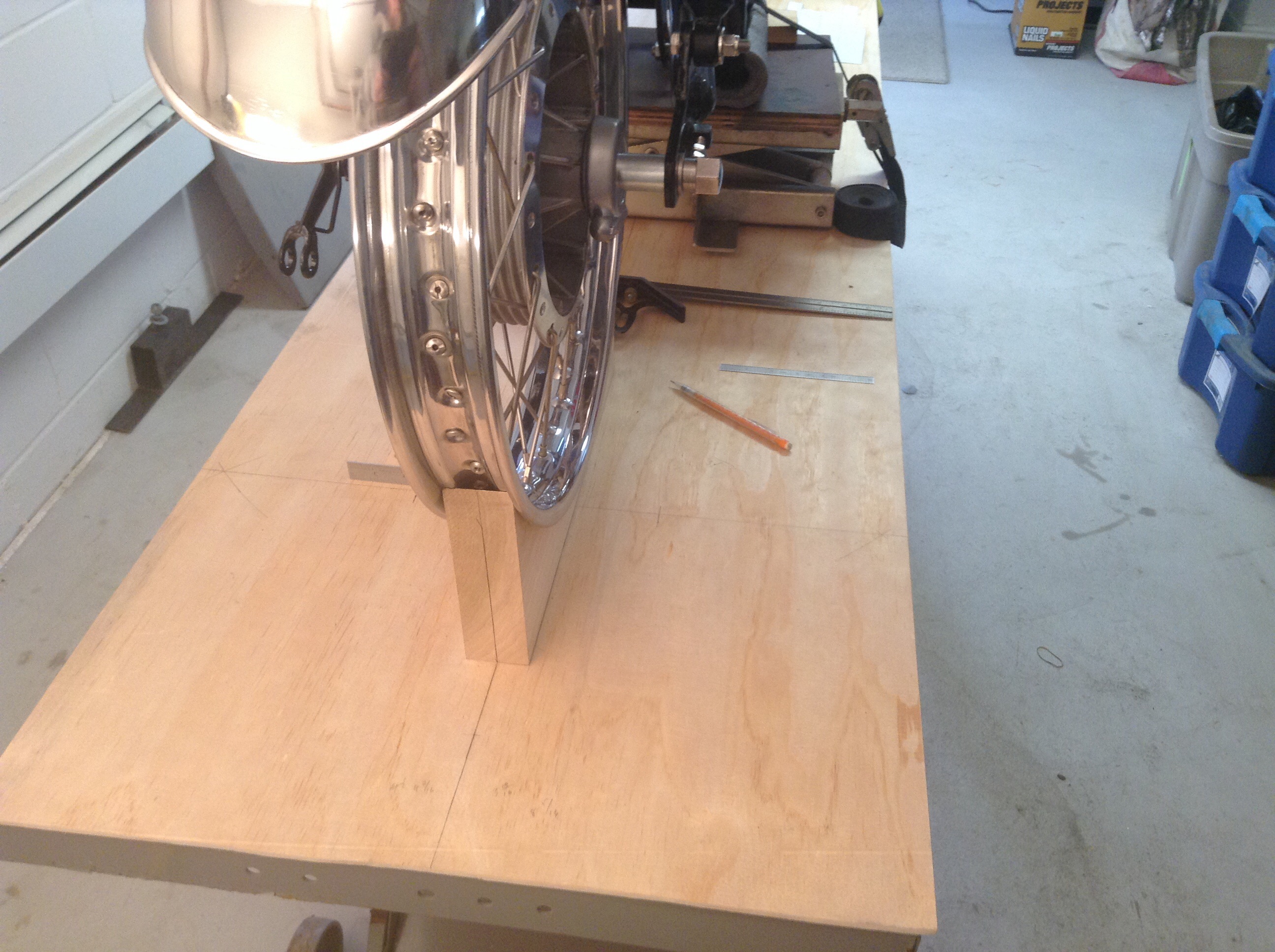

I did it this way . I cut two wooden shoes with parallel sides square to the bottom, the widths of which were made equal to the tire seat on the rim and the top cut with a radius to match the tire seat . I scribed centerlines on these shoes and laid out a straight centerline on a piece of ply . I first checked that the front rim was central to the fork stanchions with a gauge cut out of aluminum coil stock . This was done before the front mudguard was installed - the photo was taken after mudguard installation only to illustrate the gauge itself.  After mounting the wheels the chassis was set upon the ply with the centers of the shoes aligned with the centerline on the ply.
 All seems in order . I built the wheels with rim offsets to match the originals before disassembly - the offsets check with those listed on RGM's site and the centerlines on the shoes lie perfectly on the centerline on the ply .

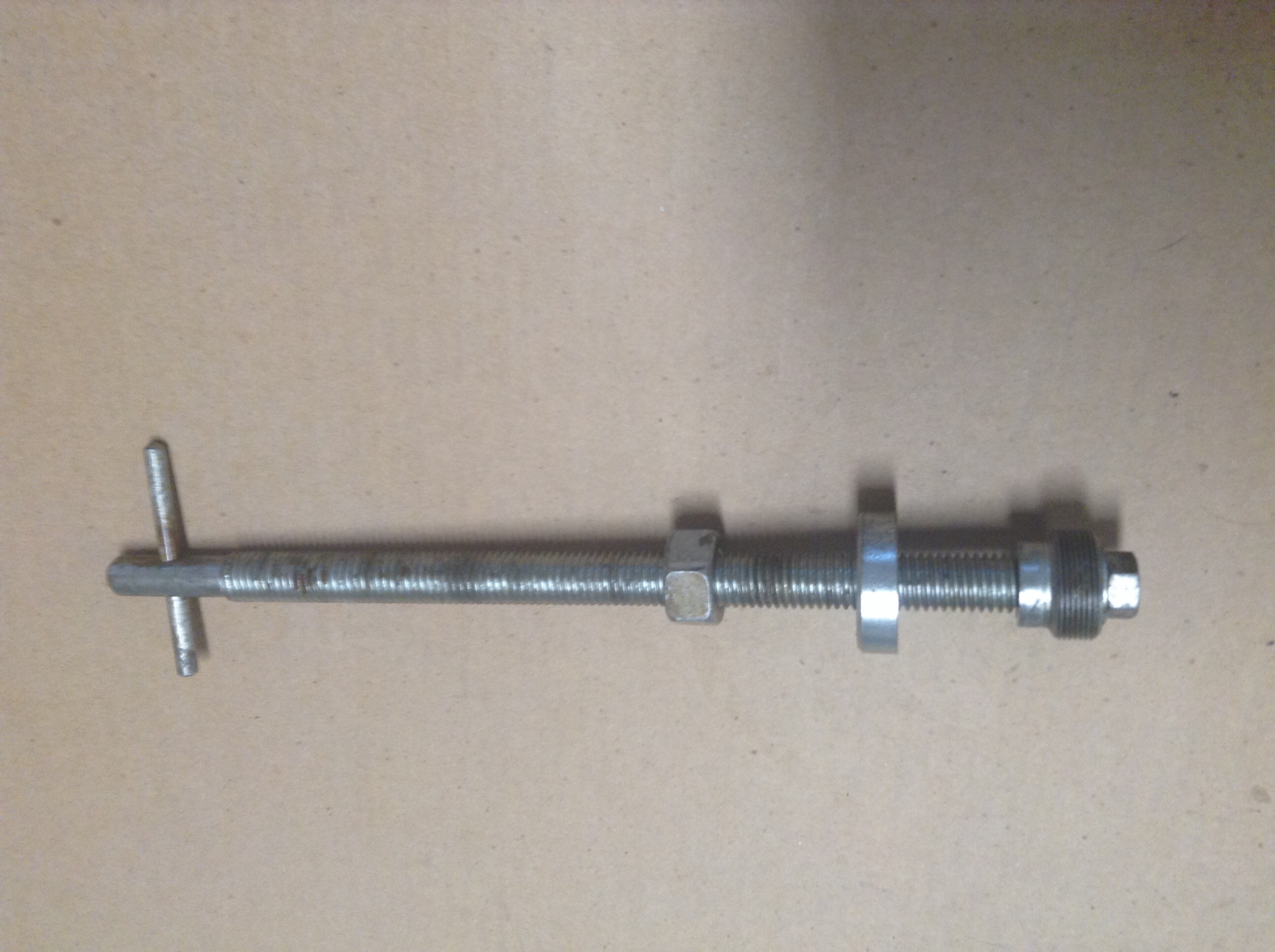

Draw stanchions into the tapers in top yoke - I am including a photo of the tool used for this . If you can't buy or borrow one you may be able to do it  with the top nuts and a spacer of some sort - the damper rod may interfere though .
