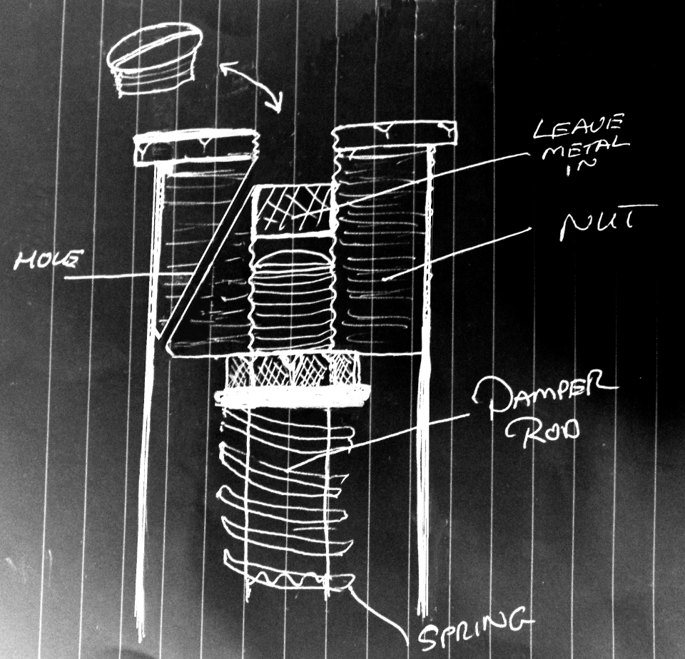

Hello chaps. a Cornish company, CPC Engineering, manufacture fork top nuts modified with a screw-in removeable cap whereby the fork oil can be topped-up/changed without needing to remove the entire nut. I've obtained a pair for my BSA, they are very nicely made. On their website they show similar nuts for Roadholders but not specifically for Commandos. The Commando nuts have a blind threaded hole in the underside for the fork damper rod. Having looked at the diagrams for the Roadholder forks the top nuts don't appear to have this threaded hole. If this is the case then:
a) The modified top nuts for Roadholders won't work on Commando forks.
b) I'm wondering whether this modification will be feasible with the Commando top caps - I'm sending one to CPC for them to use as a pattern.
Any thoughts?

Another thought; after loo…
Another thought; after looking at the nuts supplied for my BSA wherein the 'centre caps' are hollow and quite deep, I reckon they could thread the centres of these caps to replicate those of the original nuts and allow room for the fork oil to run through into the fork leg.

i have seen the ones for sale. i suppose a hole could be added as shown in the photo then you could use a big syringe type filler with measurements to add the correct amount of oil , Baz
Hmmm ...... snake oil meth…
Hmmm ...... snake oil methinks! Take the front wheel off, undo the cap, push the slider up and measure the level properly! Bit harder with external springs I acknowledge. These bikes are worth a bit of time in my book. You can also experiment with oil levels, it will be guesswork if you are just slopping it in!
I'm with Dan on this. How…
I'm with Dan on this. How do you know how much oil is in there? What's the point of sitting on the bike while you top it up. The ride height will not be affected. Start from scratch, empty the old oil out. Jack up the front of the bike till the springs/damper rods are below the top edge of the stanchions, fill with the required amount of oil, have beer while you wait for it to go to the bottom of the forks.
