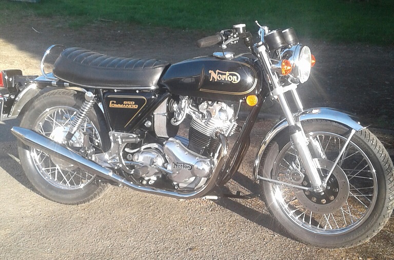

So another old commando is rebuilt and back on the road , I have really enoyed disappearing into my garage at every opportunity over the last 6 months . Just a couple of teething problems worth mentioning , cylinder head leaking oil and spraying it through the middle of head - have ditched the elastic stainless bolts that had been already re torqued 3 times and put old bolts back that i zinc plated just in case . Also gear box moved in the first mile , drive chain slack and primary like a bow string  , how on earth do people cope with the origional set up , i over torqued the adjuster bolt as it moved during build , anyway i am waiting for a double sided adjuster set up from RGM so hopefully that will cure it .
My only other problem is cold starting , took me 15 exhausting minutes last time . I am sure it is a case of getting to know the bike , how much tickle and choke etc , once warm it starts first kick and ticks over lovely . Possible factor is with electronic ignition and duel output coil maybe the spark isnt strong enough unless i can kick it faster - any advice on starting appreciated , thanks Loz
