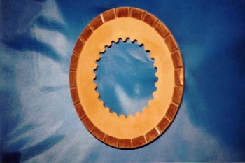

Hi,
I used to have to wash my clutch plates every 2/3 thousand miles until I did a modification to the sintered bronze plates. I reduced the width of the pressure area by about half. Look at.
http://www.rgmmotors.co.uk/images/full/full_65.jpg
And you will see what I mean. Easy to do on the lathe, just a bit messy.
That was about 5 years and 10/15 thousand miles ago and I have not had to touch the clutch since. No slip and no drag.

If you go down the line of using the narrow band bronze clutch plates as Tony has (or modified you old ones) you now have a whole load of surface area towards the centre of the steel plates doing nothing. good time to get back on the lathe and get rid of a couple of pounds of useless ballast. The bronze clutch needs to loose some weight as it's massive. you could even drill some holes in the bronze plates inboard of the friction surface to liberate more weight.
