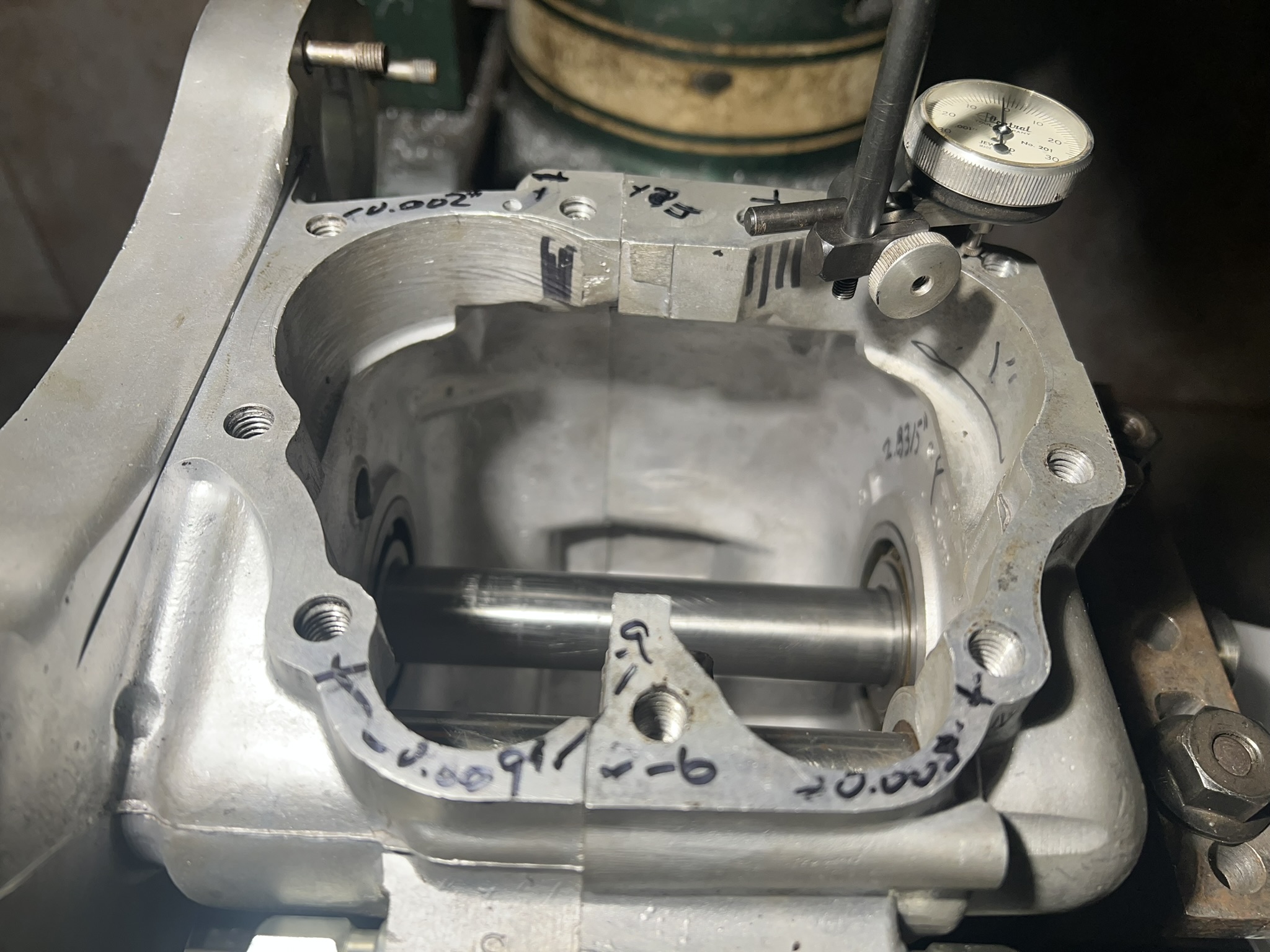

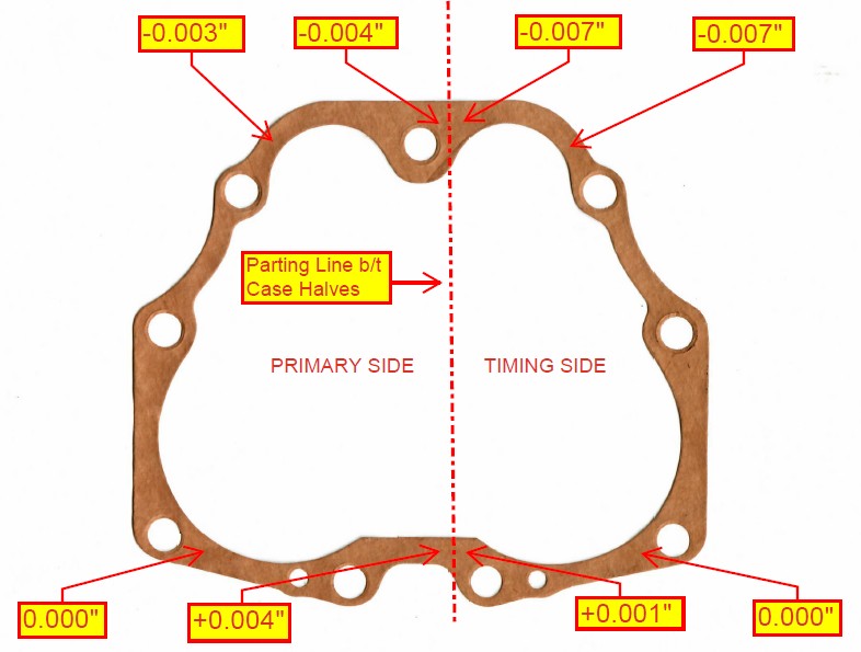

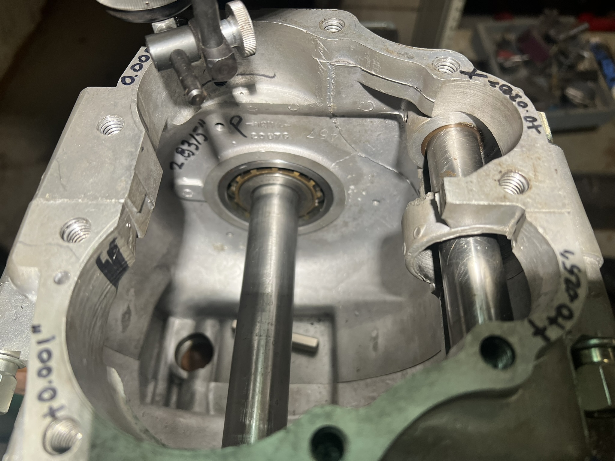

​I have a set of cases in the mill right now that have a total variation across the deck of 0.013" which can be seen in the image below.
Deck Height Variance

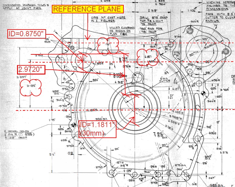

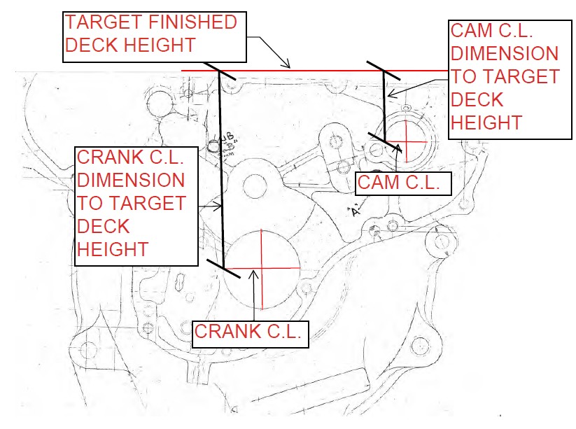

I would like to bring this back into spec. as much as possible, so I am looking for some reference dimensions, namely, the centerline dimensions from the camshaft and the crankshaft to the target deck height.  This is shown in the image below.
Commando Crank & Cam CLs To Deck
Does anybody have these dimensions on hand that they can share?
Thanks!
