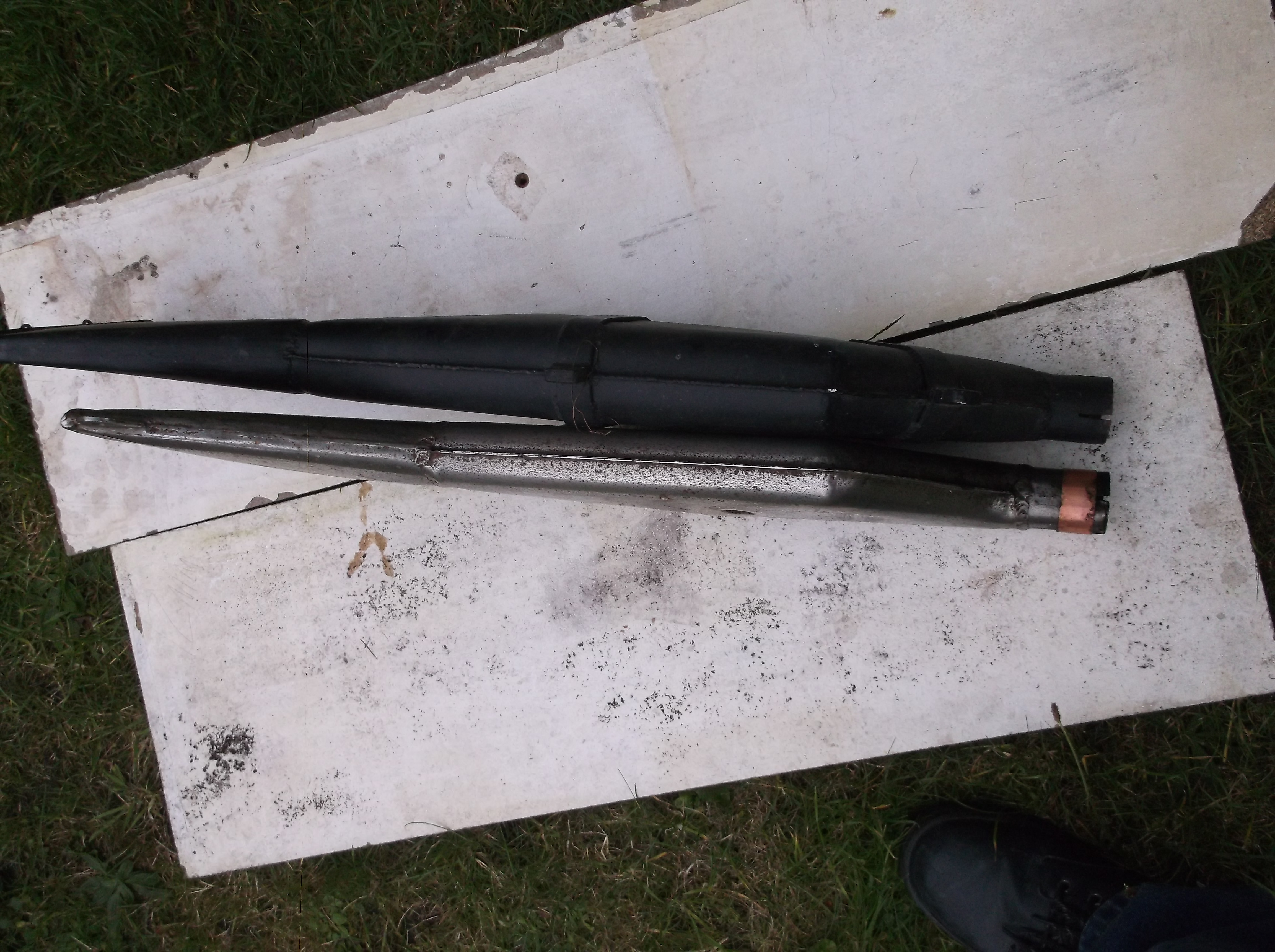

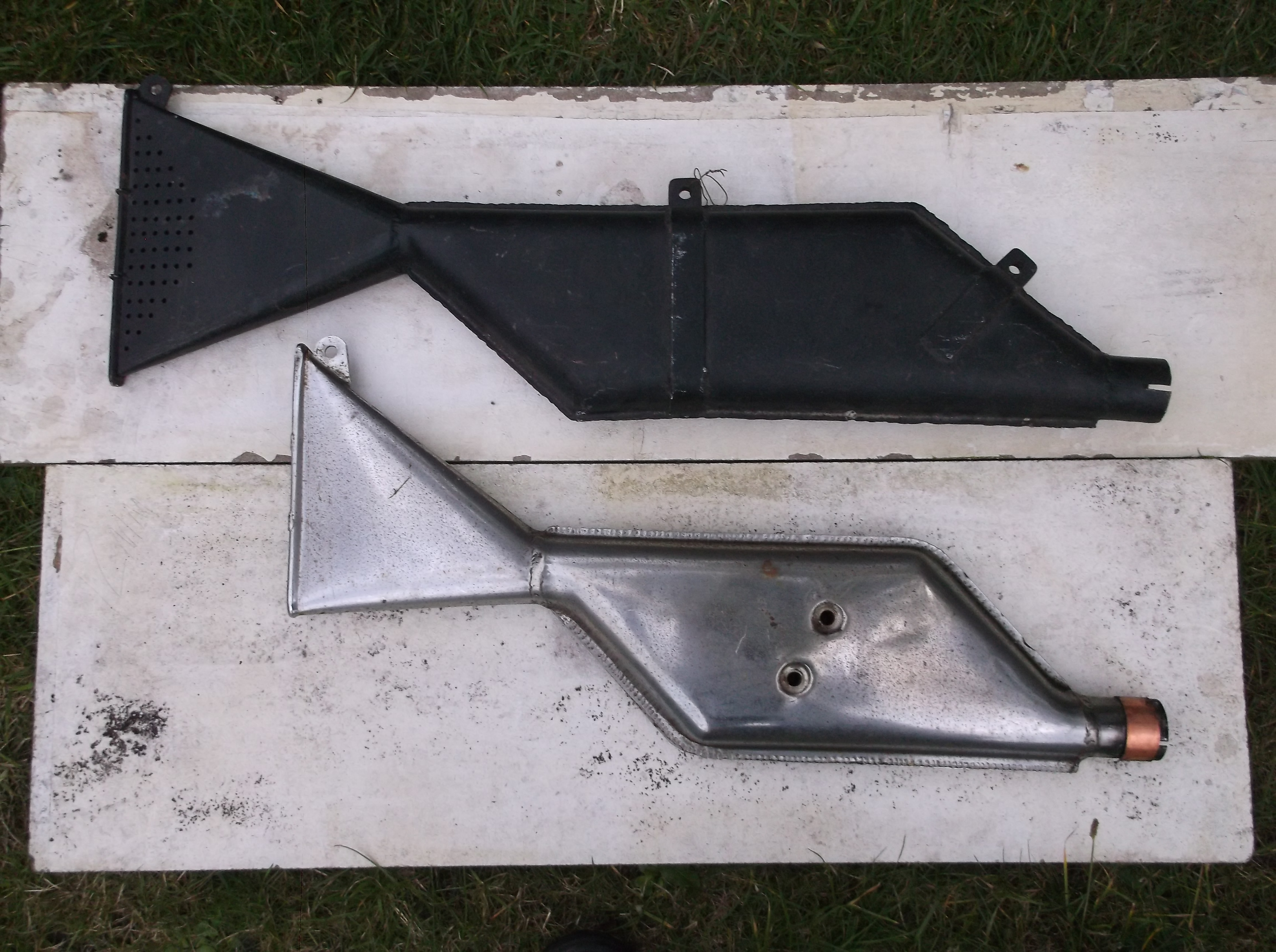

   Attached are some scanned pages from a 70+ year old edition of "Tuning for Speed" showing a few dimensions of the regulation can as set out for official qualification at the Brooklands track. This is significantly different to the modern type as made by Armours. Also attached on my second post are photos of my 1980s reproduction of an original can alongside an Armours product. The early Armours had an internal sleeve with a blind end and multiple small holes in the tube of the sleeve to make a basic baffle. The later type do not have this and the front pipe goes direct into the can. Fitting a more restrictive silencer may well affect your carburation due to back pressure.
