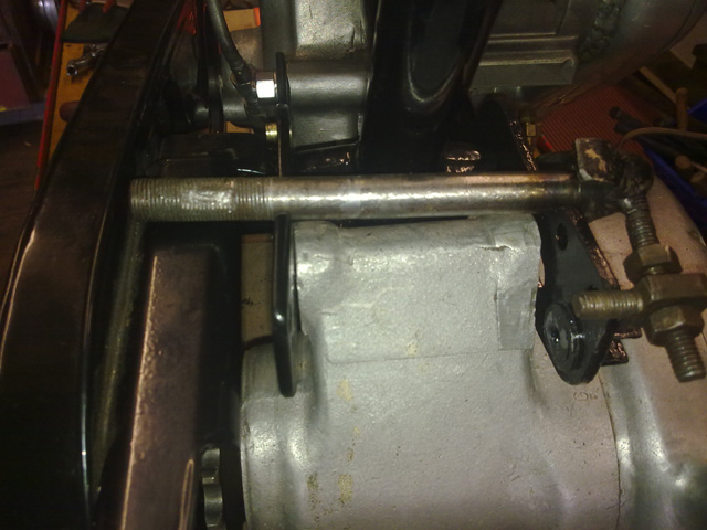

This posting was raised to see if anyone had a good pic of the gearbox adjuster. I have started to make my own version of this as I have had to make new bolts/studs. For interest : Here is a picture of the gearbox adjuster assembly "As fitted" when I bought the bike.
