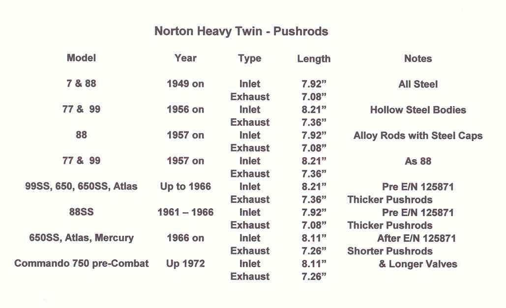

What is the preferred method of determining  as to whether the push rods are the correct length ?
I am going to fit a 0.035" thick cylinder head copper gasket in addition to the 0.035" thick compression plate between the crankcase and the barrel as previously mentioned.
The new liners have spigots and I will indeed check that there Is clearance into the recesses to ensure that the head sits down onto the gasket.
George
I feel that with the added compression plate, it might be Trial & Error. The push rods will fit but will be lower in the tunnels due to the camshaft followers being 0.035" further down. The solid copper gasket should not crush significantly so that should not add to the clearances. The point to check is that the rocker arms may have a changed geometry resulting in the adjuster end striking the inside top of the cylinder head.
