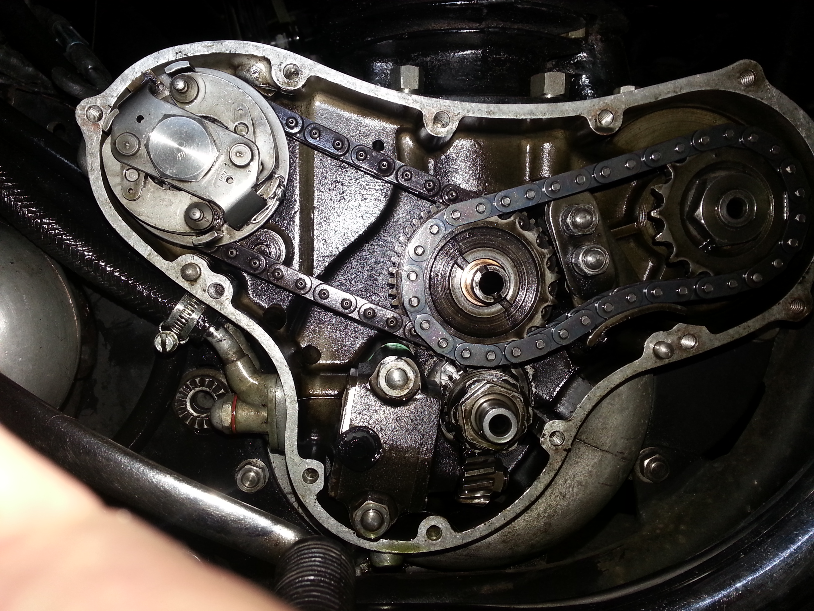

Hi David, Looking at your…
Hi David, Looking at your timing side reminds me its been too long since I checked the cam chain.Thats loose!.
Robert...the tensioning…
Robert...the tensioning slipper is present and correct. Or was, last time I went in there. But it reminds me. About 10 years ago I bought a new .375x.225 cam Renolds cam chain. When I tried to fit it, I found it was bar tight and would not go on. It's still in its box, and I just checked...it is the 'correct' cam chain (not the lighter magneto chain). I have no idea why it will not fit. I kept the old one. Can't feel any wear in any case. A mystery...

Hi David, I did not think…
Hi David, I did not think anything missing ,but the chain looks droopy on the bottom run. I've not done it myself (done plenty of other silly stuff) but I think its possible to fit the tensioner plates incorrectly, which may restrict the tensioner adjustment , a reason why the new chain won't fit?. Like you I have a spare new chain ,but the grapevine said the quality was suspect ,so the old one went back in , its past 60years old now ,think I should take a look!.I intend to do some fine tuning and set the cam timing to the best figures ,plus check the ignition is the same both sides. Like John I bought a thorspark type points replacement,never got it to work, think the 2MC confuses it. Edit,checking the "bible" the chain adjuster has 2 clamping plates ,,thin plate on first long end down,thick plate last,long end up!, I know they will go on wrongly ,worth a check next time you are in there.
The cut away timing case is…
The cut away timing case is not in place, Robert. I'm pretty sure that's why it looks a little slack. Next time I go in there, I need to Loctite that shaft...it spins freely which it should not do. One problem that causes is that it's all too easy to lose the steel washer behind the gear....

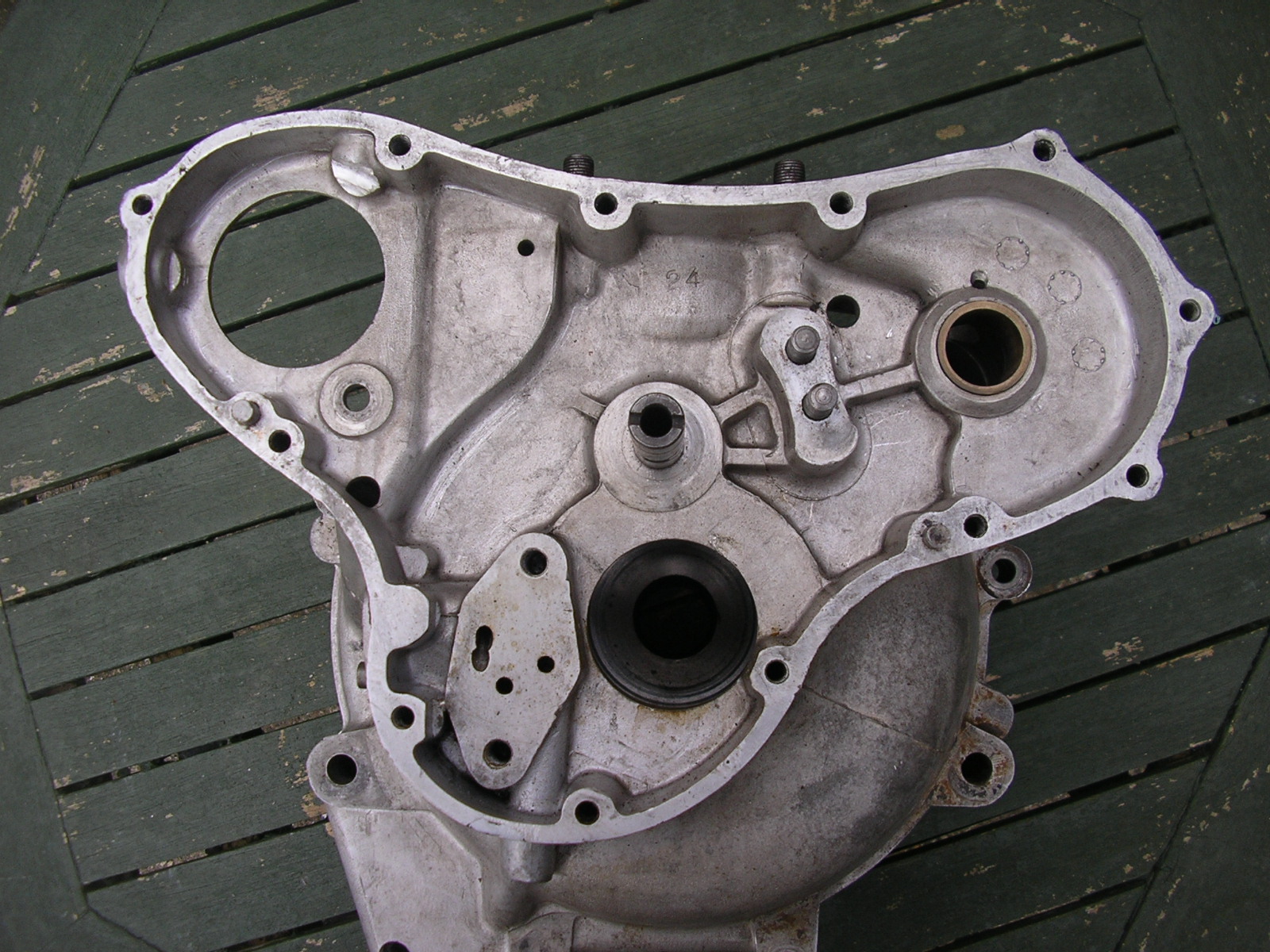

Intermediate Gear Spindle
The Intermediate Gear Spindle should be fitted with with its midway oil feed hole facing downwards. You can just about make this out in the attached photo. This position is very important as oil from inside the crankcase feeds through the end to this hole and the lubes the Intermediate gear/pinion.
If this spindle is very loose it will almost certainly turn when the engine is running. Threadlock goo is one solution. Some people have tried plating the dogy end with Copper or Nickel to bulk it up a little.
The Timing Chest Chain lengths should be - Magneto / Distributor 42 links and Camshaft 38 links. A very dodgy trick for what appears to be an overtight chain is to first give it a good cooking and then fit it. This thins any excessive internal grease and also expands the chain. Mount it while still hot on the sprockets and turn thse a few times. Check again once cold. If still too tight once cold replace.

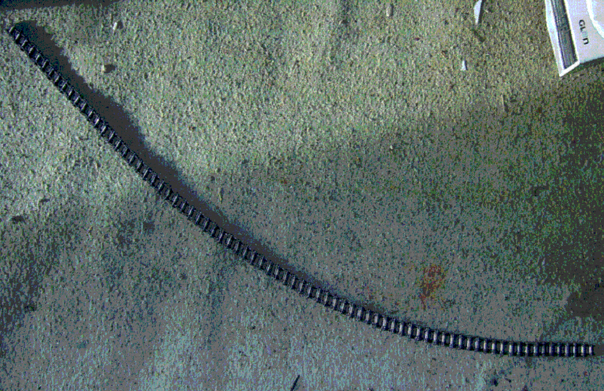

There are many questions being asked, these days, about the quality of British made chains. I have found that those for the rear do not last for very long despite regular spraying with grease or regular dunking in a tin of hot lubricant. Primary chains are no better. Checkout the photo of my primary chain after just 150 miles. That should not bend so much so soon.
