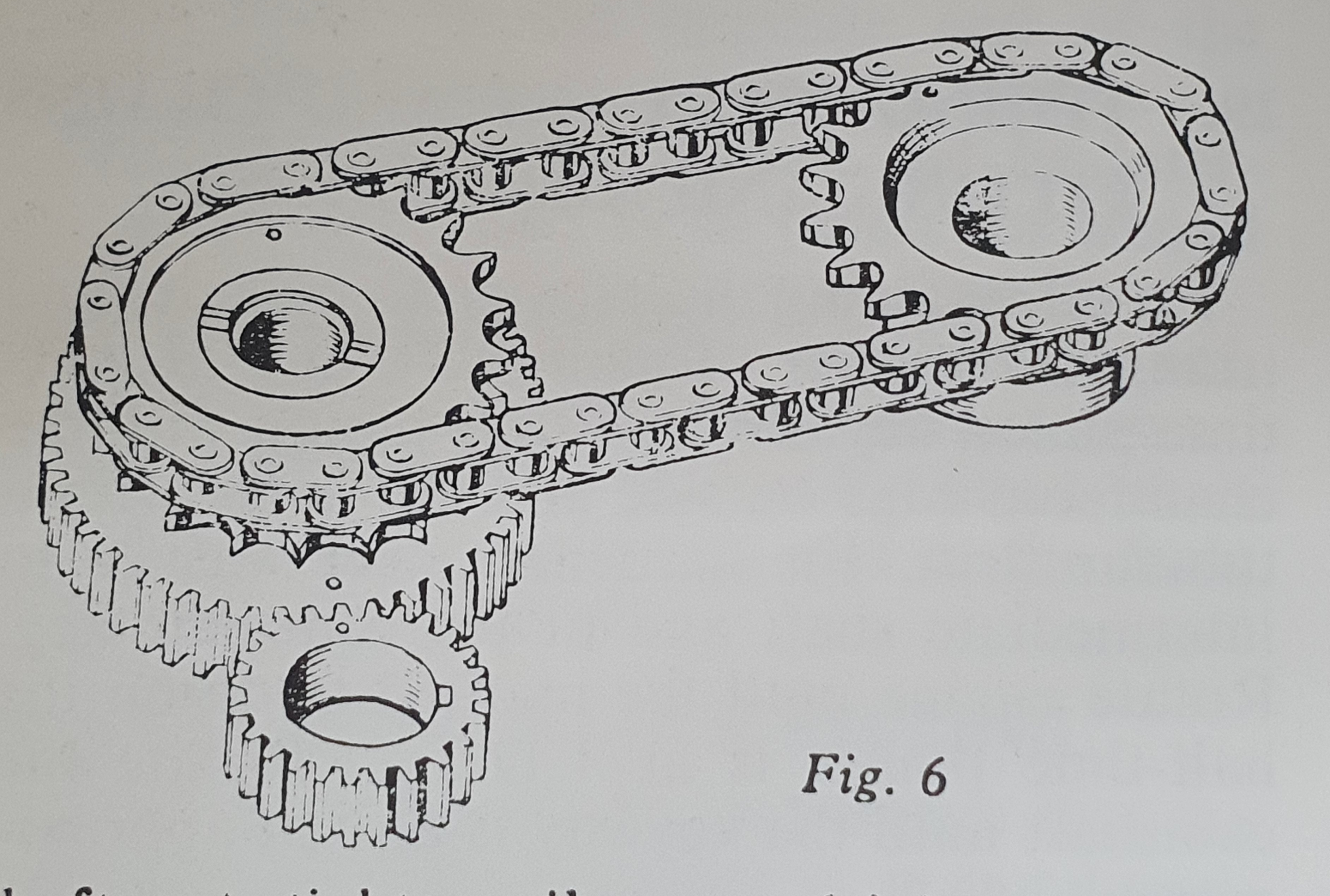

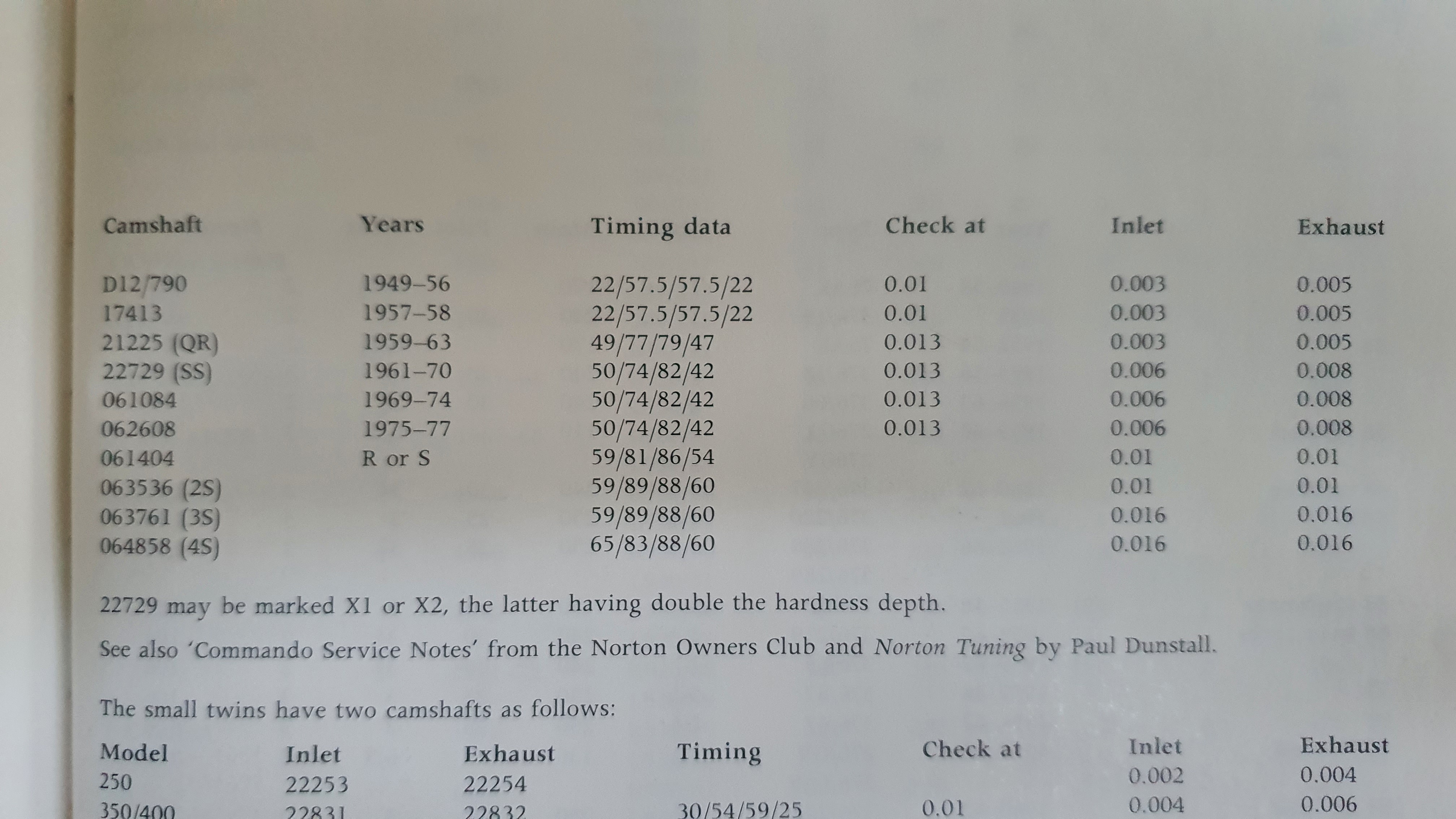

Unless you have reason to believe the camshaft is incorrect and you are looking for more performance, the camshaft is normally set by assembly according to the timing marks.  It is not easily adjustable.  The manual merely says "marked on all engines". Data are listed in Bacon's Norton Twins Restoration.  I'll add a picture.
