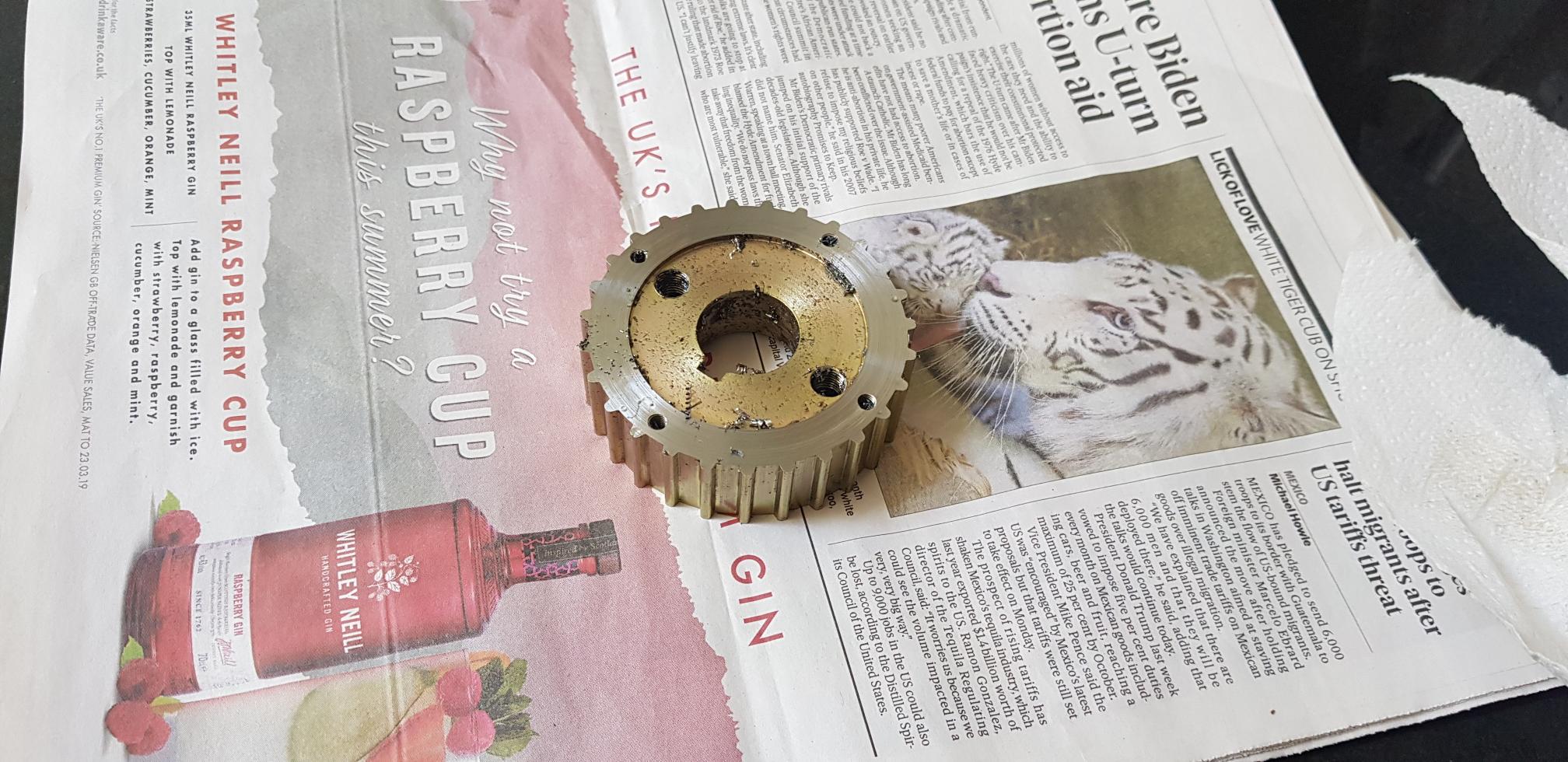

I have a 1959 Dommi 99 to which a belt drive modification has been made. This involves a Commando clutch assembly. With the correct tool I sucessfully dismantled the clutch, but now I have to put it together again. I am struggling to refit the large circlip that secures the sprung diaphragm. Are there any special tools available or is there a technique that I am yet to discover ?

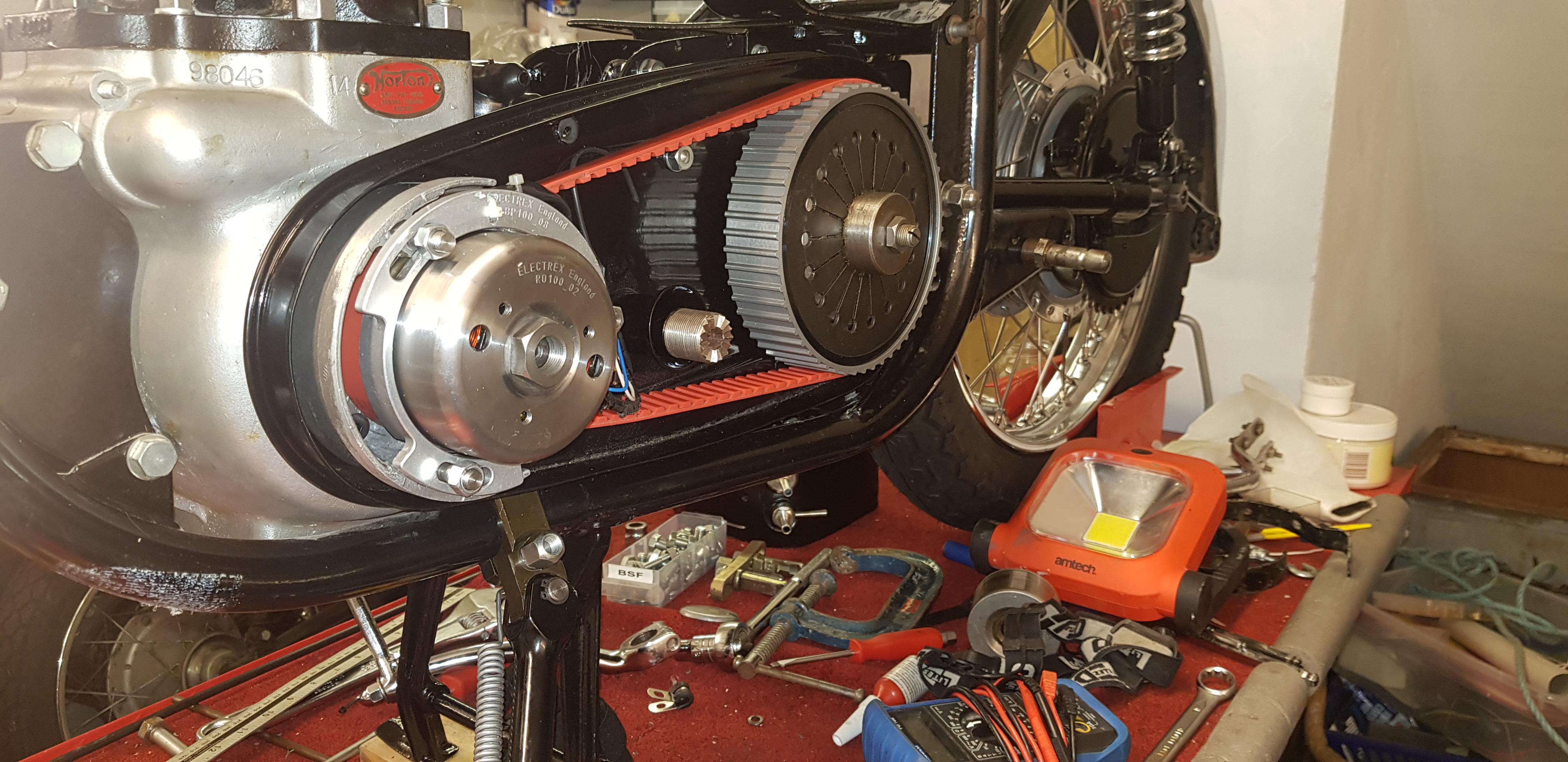

Mike is correct in his reply, I fitted a belt drive for a commando which i got from RGM. This was a decade ago. Other than longer stator studs supplied I was on my own. You will need the commando lever in the gearbox as it is a different profile to the Dommie. I had many issues fitting the belt drive including the studs which were supplied didn't space the stator far enough out from the pulley ( what is this yellow powder inside the case, remove stator to find a neat depression ground into the back of the stator by the front pulley).
I overcame the outer cover problem by fitting a rubber spacer onto the inner case where the foot peg mounts ( I think this was a tank mount of a Commando ). This moved the outer so as the stator didn't foul the outer case but allowed enough threads for that large nut to be done up and the foot peg to be fitted. What you have then is about 15-20 mm of the big rubber sealing gasket showing, a small price to pay for a better clutch and a dry garage floor. I attach an article that I wrote but never submitted to RH. This might help you set up the belt tension and alignment. All this is from memory as I have never had to look inside the primary in over ten years. I did fit an air scoop onto the back of the inner primary to cool the clutch, it does get hot over here in Australia.

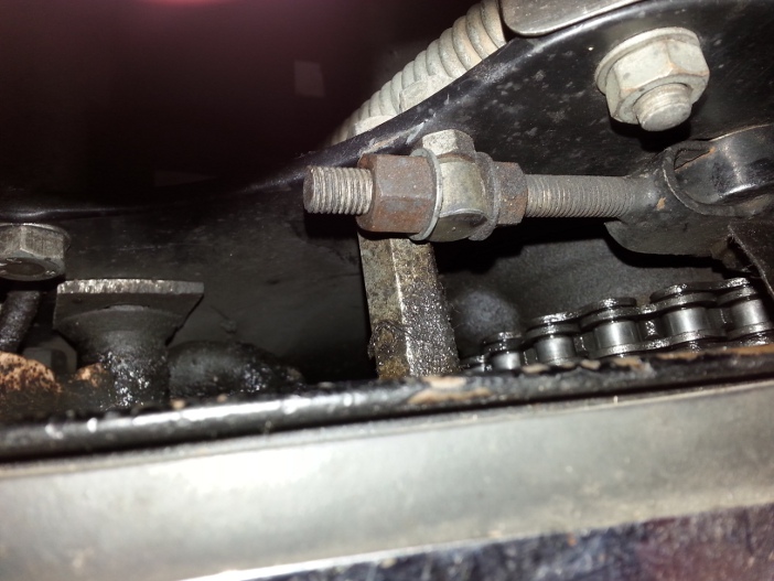

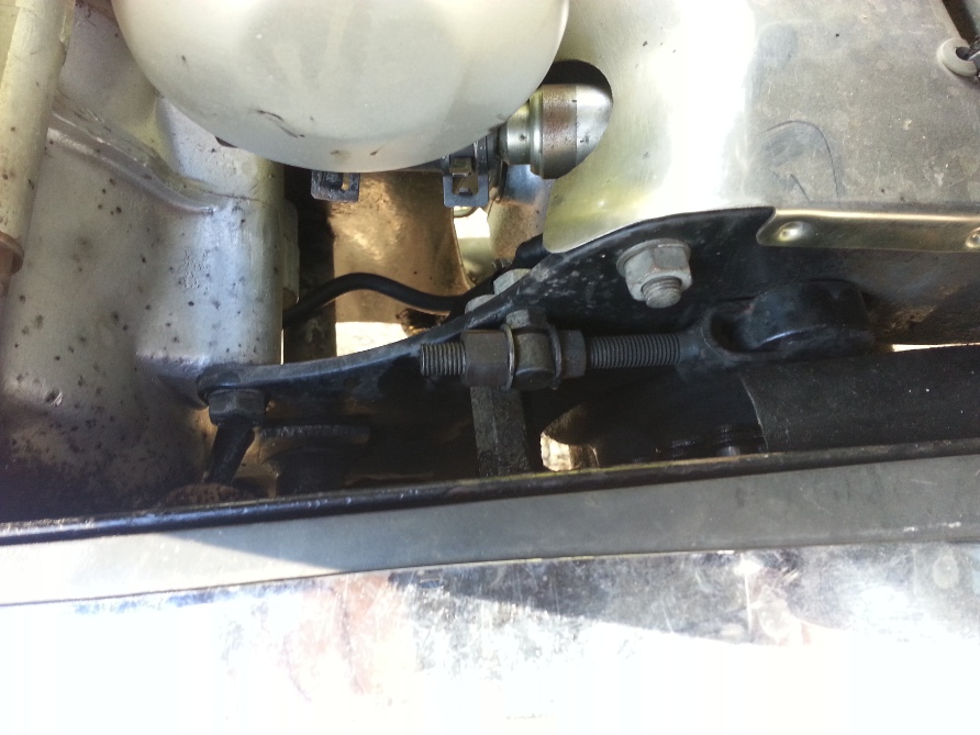

I made up my own drive side adjuster and have no difficulty in using it. I have a small ring spanner that I have ground the end away . This fits over the threaded rod and onto the adjusting nut and locking nut. I can send you a rough drawing and description. I was just too tight to spend more money to get a manufactured item.

I fitted my RGM kit back over 10 years ago, now it seems they are improved with a narrower belt. As mentioned previously I had to pack out my outer primary cover to stop it scraping. I fitted the seal kit onto the end of the main shaft and all is dry. Prior to this there was a small amount of gearbox oil getting through. I'm told that under load the push rod flexes and acts like a skipping rope drawing oil from the gearbox. Maybe someone is pulling my leg! I will never know.
My 68 Atlas has the commando kit supplied with a longer belt and three longer stepped studs for the stator, I cannot remember if it came with a longer sleeve nut, maybe I altered the existing. It did come with a very large spring washer to go under the sleeve nut, this digs into the rotor,no way could it undo! I made a drive side adjuster out of a large socket, a button head unbrako bolt , a Commando rear brake adjuster, a fairing mounting bolt and a couple of nuts. This works well and is easy to make adjustments. If you have a lath and oxy it is simple. I can do a drawing if your interested. I'm assuming that your 99 has the same clearance between the back of the inner primary and the engine/ gearbox plate.

Hi Steve & Mark,
Here ( hopefully) are 2 pics of the adjuster that I made up. I used a commando rear brake adjuster ( modified ) along with an old socket machined to fit on the big through bolt on the top gearbox mount.
The adjuster was welded to the socket. The large bolt was removed, put in a lath and then drilled and tapped to take a 6mm unbrako button head. This secured the adjuster to the bolt.
Next I drilled a hole in the gearbox cradle to mount the adjuster stop. This was an old fairing mount. The threaded rod fits through this mount and has two nuts for adjusting. I have a special ring spanner which has been "wasted" so it will fit over the rod. As you can see it is all easily accessible.
