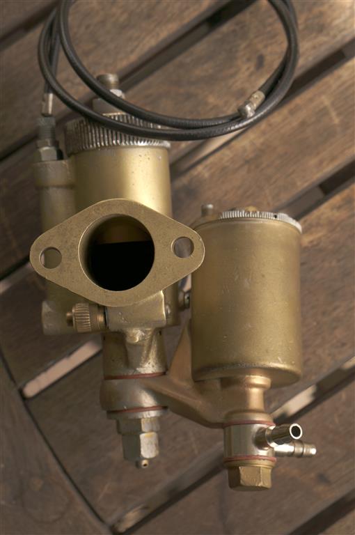

Can anyone assist please: is this a standard Amal TT carburettor? The inlet tube is missing. I'll be in touch with Surrey Carbs later, but the Amal publication says that the air tube must be factory fitted. Obviously that won't happen although I do have access to a lathe.
I can't work out how the air tube could fit on this thread. 1.80 ins outside diameter.
It turns out this seems to be an AMAC TT carb.  So now I need to find out if it should even have an air tube.  The one it had yesterday made a successful bid for freedom on the A3 last night, somewhere west of London.  Looks like a bit of exasperating lathe work...if I can find out what shape it is supposed to be.

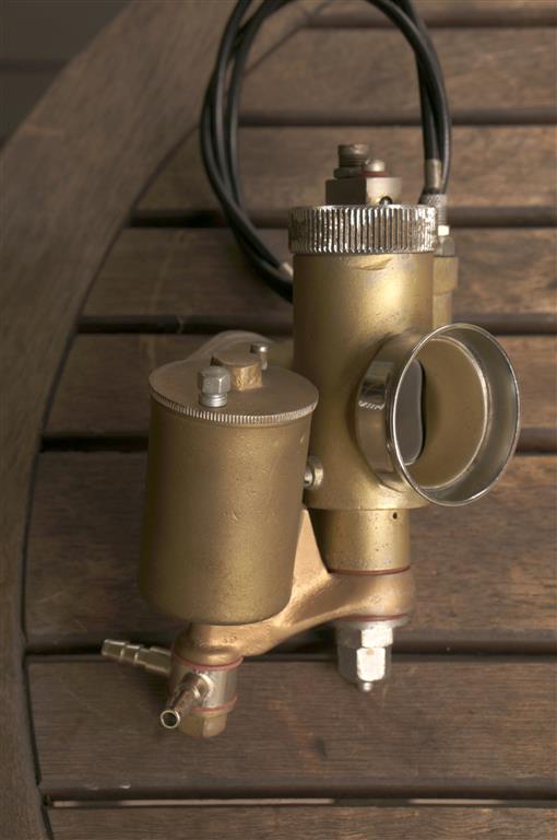

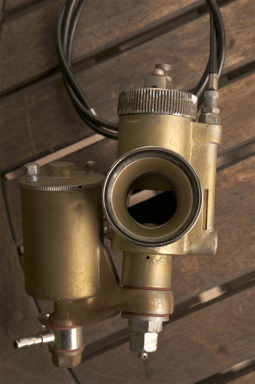

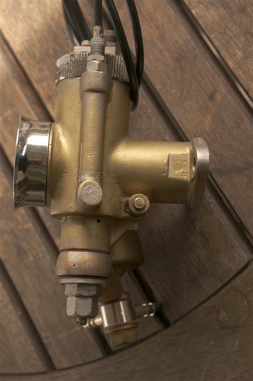

Thanks very much, Michael. So he has no more  but at least I now know what it should look like, so it might justify the presence of my seldom used lathe! I didn't even know exactly what carb it has...Amac or Amal...
hello I do have a Amal parts cataloge in my persestion  and there is a lot of information about the Amal  TT 10 and TT15  and GP  Carbuettors    so anyone needing some info contact me on annajeannette@btinternet.com     yours  anna J
Michael - thanks for the pictures - it appears to be identical.  I can't quite work out what sort of bell mouth yours has.  I doubt if its absence will make the slightest difference on the road anyway.  But I should cover the thread anyway.

Surrey Cycles (the Amal man) told me the current TT inlet will not fit because the new versions of the carb have an internal thread where mine is external.  That's why he thought it was an Amac.
I've found 45mm OD fittings with air filters, which claim to contain a bell mouth, but they are held with Jubilee clips (I think to fit Mikuni).  Not pretty (but probably practical).

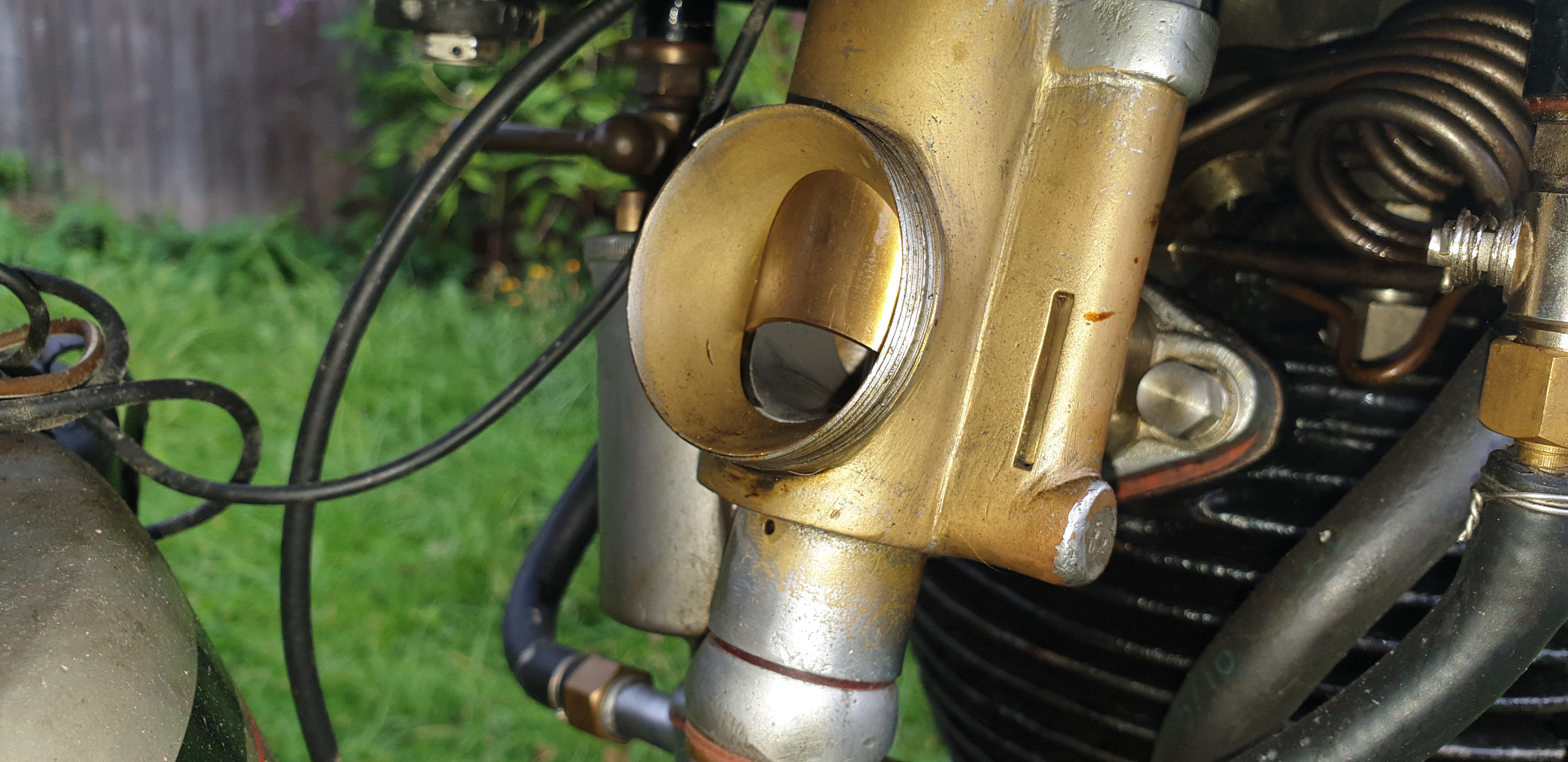

I was just looking at one of my own items on google and it came up with this thread - just to be clear , the early Amal TT's were fitted with 'spun' bellmouths with an internal thread as shown in David Cooper's original photograph and query.
I believe they switched to the more normal alloy bellmouth with external thread in approximately 33 or 34  .. . but dont quote me on this.

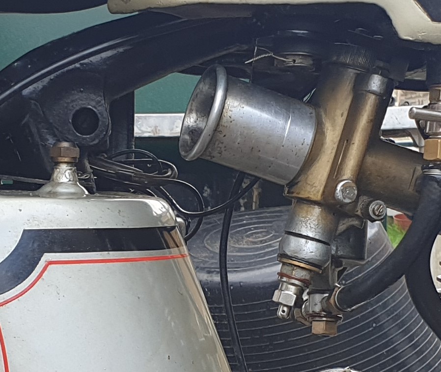

I'm probably one of the few people who might be interested, Paul.  I've not seen another carb like mine, but there must be others out there.  From photos, the early bellmouths were shorter and widened more quickly.  Previous owner some decades ago added the one I now have - which is longer (and thus as I understand it theoretically better), and also had nice rounder inlet edges (also better than sharp edges...).  But it is more or less parallel until it starts to narrow down as a can be seen in my first picture.  I don't intend to race it...
...from various contacts here David. Just wanted to comment on the bike.  What a beaut! Lots of trick bits, very clean and sits so well.  The damper anchored on the tank and the high level front brake adjuster.  The brooklands can sits well on a very nicely formed silencer pipe. The Dunlop seat and inverted levers. I’m guessing it’s about 1934?  Great to see, and here that you ride it. Great machine !
