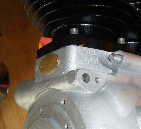

Hi Ron
I have a 99SS engine just a few numbers away from yours (but this is not the number used in the log-book as being the 'engine number') see attached pic.
It has been suggested that the 'SS' was added by owners later (to kind of turn base metal into gold) but the pictures are too similar to make that likely.
My bike was first registered in 24th August 1961 as a 600cc 'Super Sports'
The differences from a standard 99 are,
The cam is high-lift, stamped 'X1'
The inlet tracts are opened out to 1/ 1/16" and polished
The pushrods are fatter, like a Commando.
There is a tiny BSS stamp on the top of the barrels (I think they have wider pushrod tunnels)
There is a tiny SS stamp on the underside of the head
From a road test in 1961 the valve springs were the later, shorter and stiffer 'dual rate' types.
From the spares book it looks as if the pistons could be the same as a standard 99, but the 88SS pistons differed from standard 88's
(this odd - someone knowledgeable will correct this point) Oddly, the spares book offers hi-comp pistons for the 99 Std and D/L, but not the 99SS.
I'm not sure about the bulge issue, not sure what I am comparing with, but I do believe that my engine is exactly like yours.
It has distributor/coil ignition
The pressure relief valve is different (but I don't know how - but they have different part numbers)
The timing cover has provision for a rev counter
There is a tacho drive nut on the end of the camshaft
The valves were the same size as standard 99's.
If you are anywhere near London we could compare them

Hi Adrian, As this thread is still ongoing. The attached pic of my engine block may help.
Attachments Engine_no_small.jpgI have rebuilt this engine from sump plug to head steady and at the time tried to pin down details of the spec. There seems to be quite a bit of âmisinformationâ to put it politely, around.
The 99ss 600cc had coil ignition, as far as I can see externally, the basic 600ss engine will look the same as standard of that year. You need to get inside to check things out, the camshaft was the main difference. Valve timing can be checked but unless you are up on 50/74/82/42 and things its not easy.

The factory built 99SS models, that were catalogued and available to Joe Public for a little under two years,were all stamped with 99SS on the back of thecrankcases. As opposed to just 99 or 99C on the other 600cc engines.
As part of the deal, you got an SS camshaft from the 650 engine as well as 650 barrels, 650pushrods, twin Monobloc 376 carbs plus the option of a siamesed or standard exhaust. The most notable diffference between the 650SS and 99SS was the cylinder head. The 650 had the new splayed exhaust and twin carb job with horizontal carb mounting studs. The 99SS was sold with the old standard 1960 style 99 head with the old exhaust ports and mounting studs for the 2 into 1 car manifold. Although, mounted in this area was now a special adapter which fitted between the head and allowed the use of twin carbs. Strangely, in this head you had the bigger inlet valves of the 650 and some earlier 88 &99 heads plus the shorter but stiffer 650 type of valve springs. Coil ignition was used for these engines.
