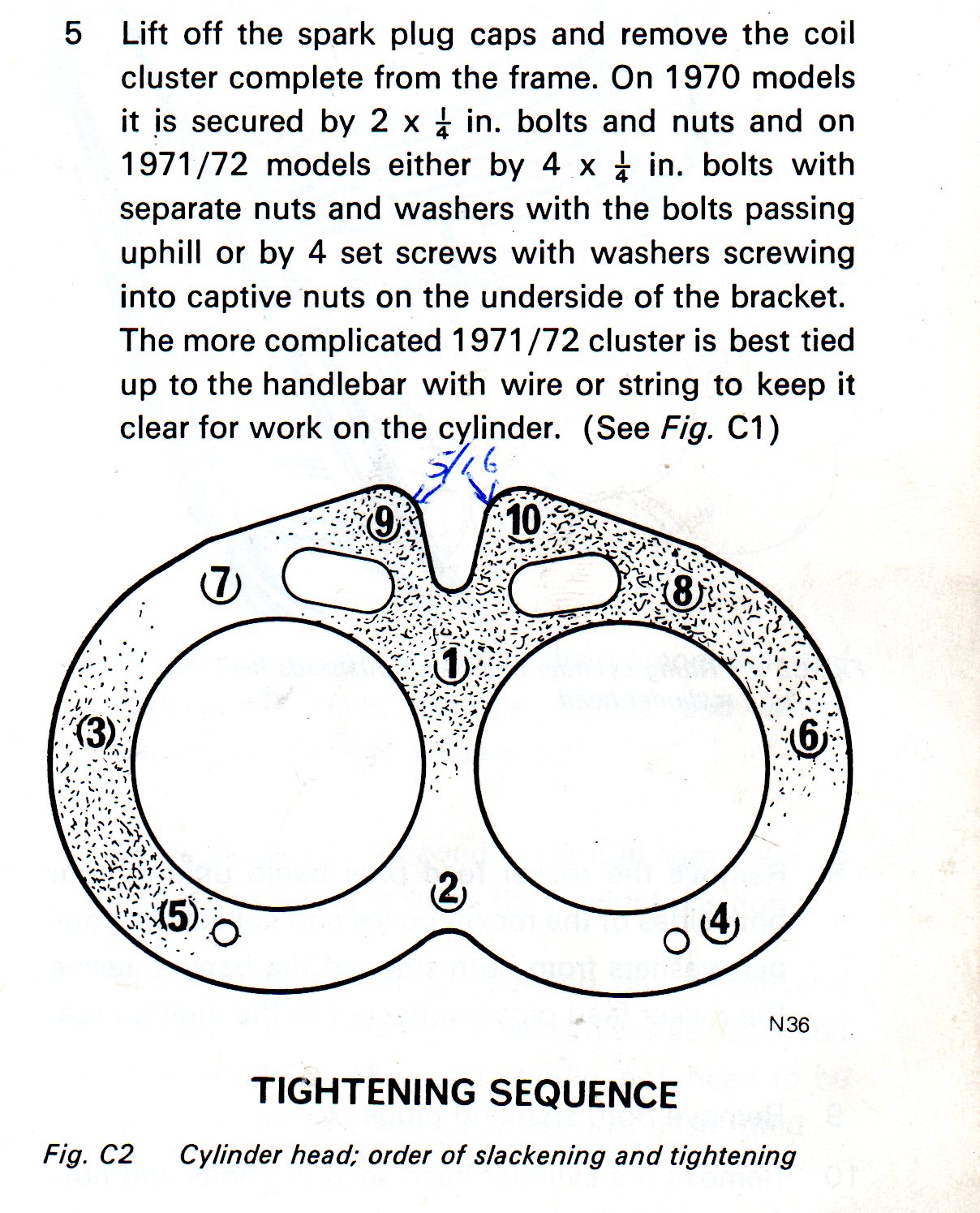

I'm an extraordinarily disorganized person and I can't find any of the three repair manuals I own for my 1971 Roadster. Could someone here take pity on me and post a link to the page that covers the head bolt torque setting and tightening patterns? I just want to get the head closed up before turning the shop upside down searching for the books.
Hi
I've attached the sequence the 3/8" bolts are 30 ft/lbs  4.15 Kg/m and the 5/16" are 20 ft/lbs 2.75 Kg/m
Regards Alan
