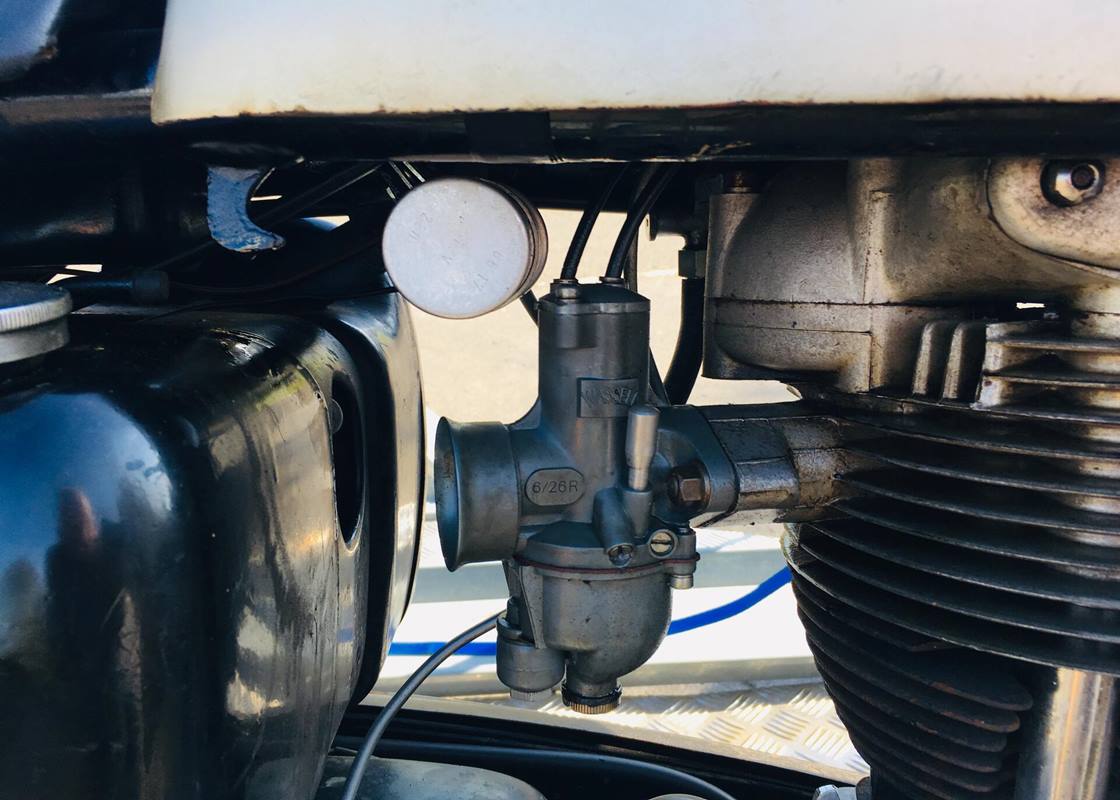

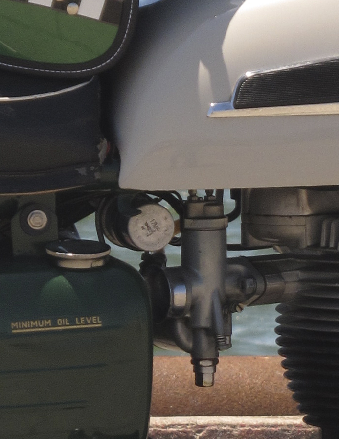

Hi, first post since joining so here goes. Can anyone tell me where the coil is attached on a 1962 slimline model 50 please, thanks   David
is across the fame in front of the battery box. HT cable left side.
Well that's where it is on mine...
So do I.     David, welcome to the club.
You should have a small bracket welded to the frame enabling the coil to be mounted as per Michael's excellent photograph , at least my slimline M50 has.
Regards John O
Same as Jon on my slimline. 626 carb as well.
