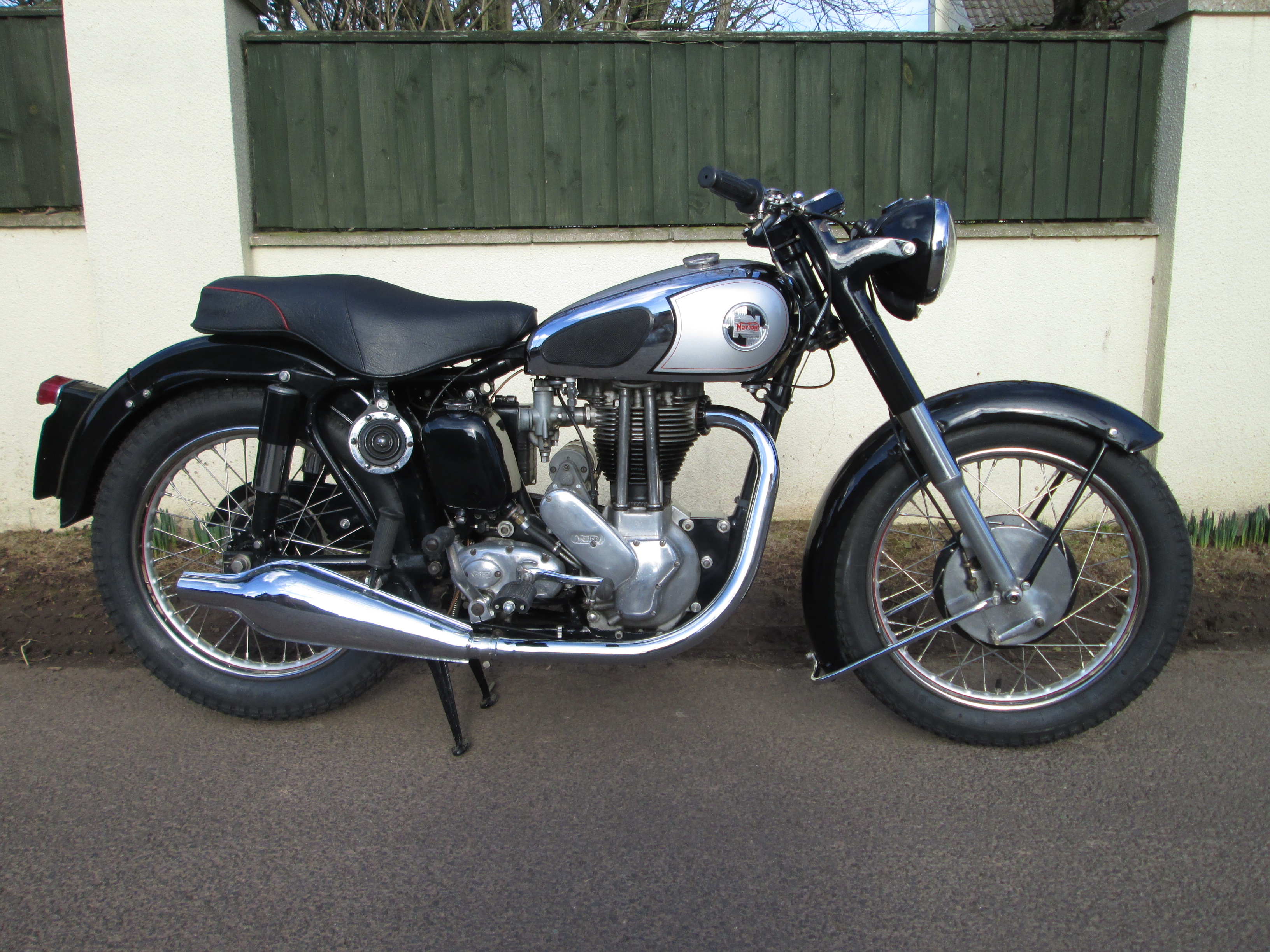

A couple of years ago I bought a new seat from Leightons for my 1955 single downtube ES2.  It is finished very well but the securing nuts in the seat base were questionable.  The nuts between the metal base and the foam were not captive and moved around when trying to insert the fixing bolts!  Also, the nuts were only 1/4", whereas my original seat used 5/16" bolts, so I don't feel the seat is secure enough for carrying 2 people.
On my other similar ES2 I have a BSA seat (see photo) that fits very nicely and is comfortable.  The main difference is that the proper ES2 seat has red piping.  It all depends on whether you want the bike for riding or show.
