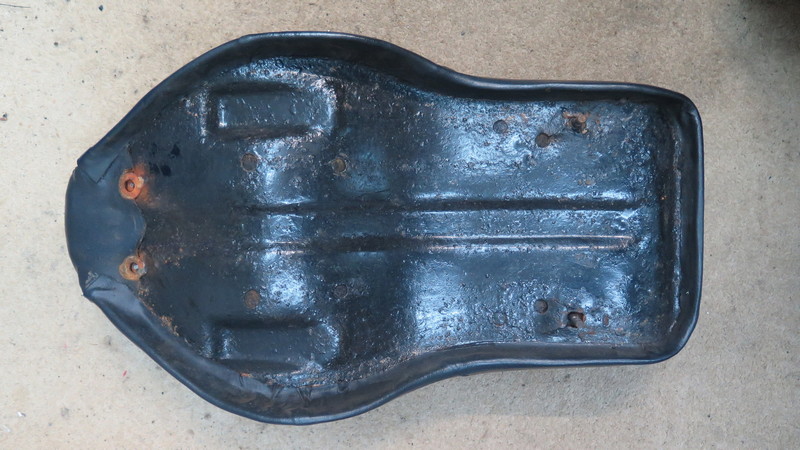

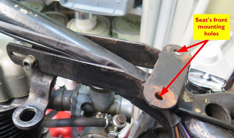

I'm restoring a 1953 ES2 and have a (BMS) copy of the 1950 Norton parts list, together with the supplements for 1951 - 1954. I can't find any mention of the dualseat introduced in 1953 (or even the 1954 dualseat). The dualseat fitted on the bike is mounted quite differently to that on a friend's 1957 19S.
We're wondering if the ES2's seat and its mounting points are original or a later modification / addition.
Can anyone advise?
Cheers, Simon.

That front bracket...
.. looks pretty home made to me. Is it a plunger or swinging arm model?

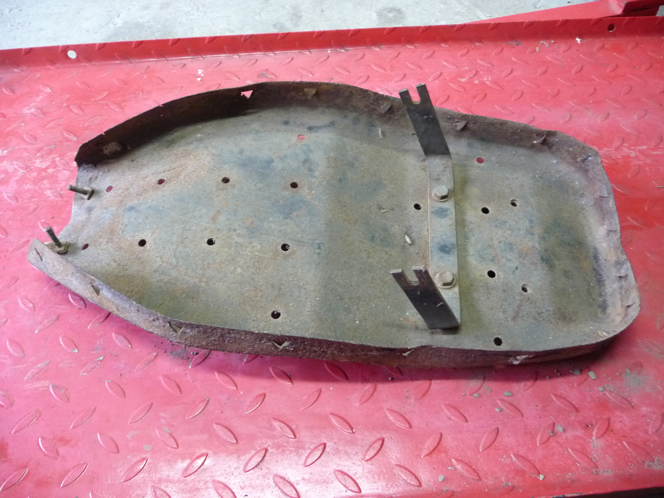

Here are a couple of pics of…
Here are a couple of pics of what i believe is an original 53-54 seat pan ( a bit worse for wear) plus a front bracket taken from a very original 53. much the same as what you have except fot the downward facing tongue that rests on the frame.

Simon. Yours looks the same as my '55 ES2 seat. I have always thought the front mounting was a little crude and over engineered but it works. I ride two up quite a lot and didn't think the rear mounting provided enough support so made a couple of extra brackets that mount to the top shock mount. Probably not needed though.

simon your frame and mudguard fittings are the same as my 19r 1956. Also the seat with the threaded holes is the same.

Thanks Ian, it’s good to know that the arrangement works okay. It does look a bit strange.

Hi all. I have two ES2s -- a 1953 and a 1954. I've had them both over 10 years and I'm still working on determining what's "correct" given the lack of parts drawings for these years.
Anyway while this is not absolute proof, I think both my bikes have the same seat pan, which means they may be the original factory piece. It's similar to Simon's pan but not exactly the same. I have not had the 1954 seat off yet, but it appears to match and the brackets look factory to me. I only have a photo of the poor-condition 1953 one because it's off the bike (I circled the mount points that are actually used in the other photos):
Note the pan is mangled and the mounting bracket shown at bottom is NOT correct - the original mudguard was missing from the bike this came on and the mounting was cobbled up.

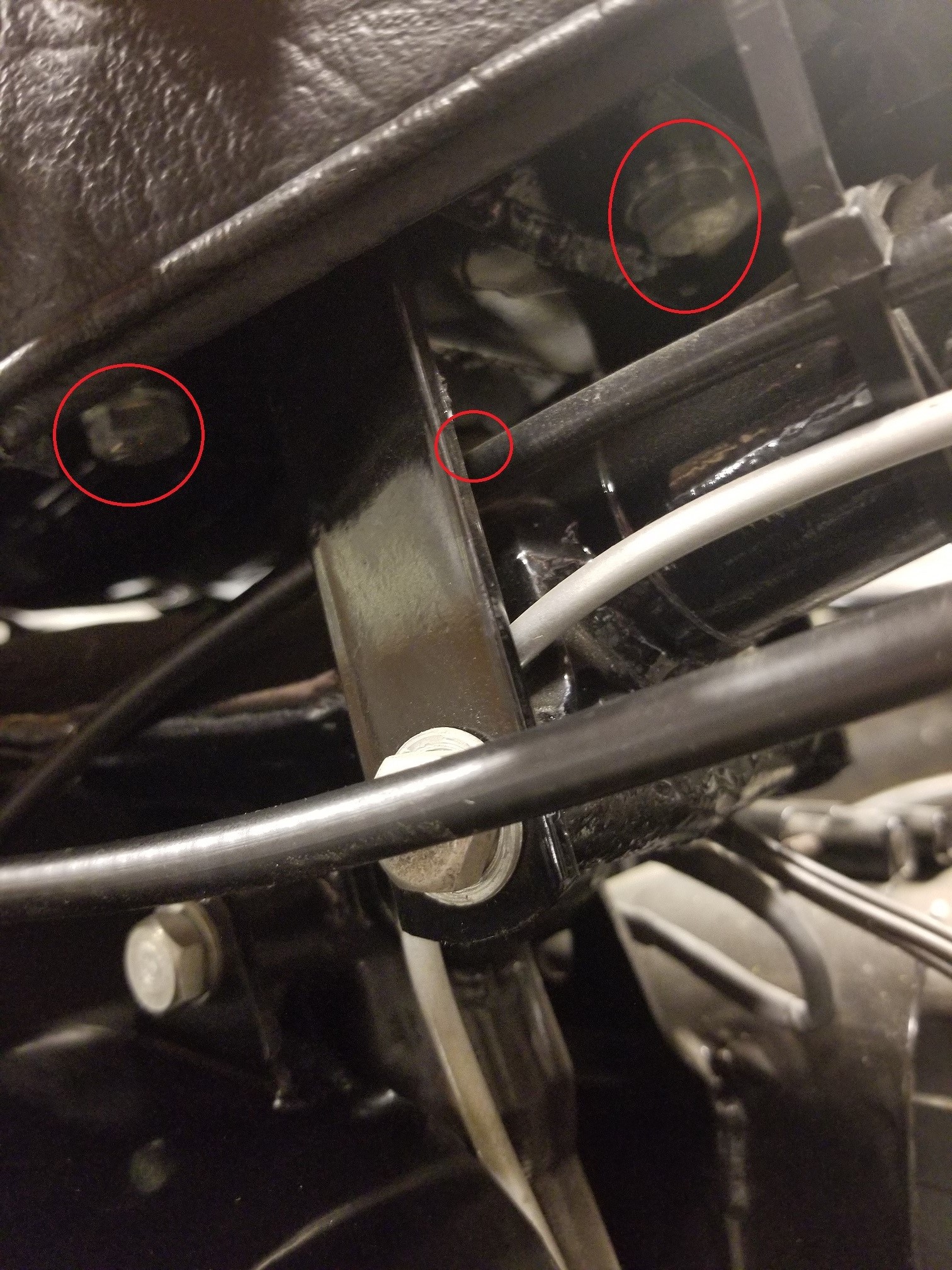

Now some shots of the 1954 seat (still on the bike). This pan appears to be mint and the seat's been nicely recovered. Note a U-shaped bracket connects the front three lugs on the seat pan to the front frame lug (no contraption as shown in Simon's first photo). I tried to circle the three bolts corresponding to the lugs on the seat pan:

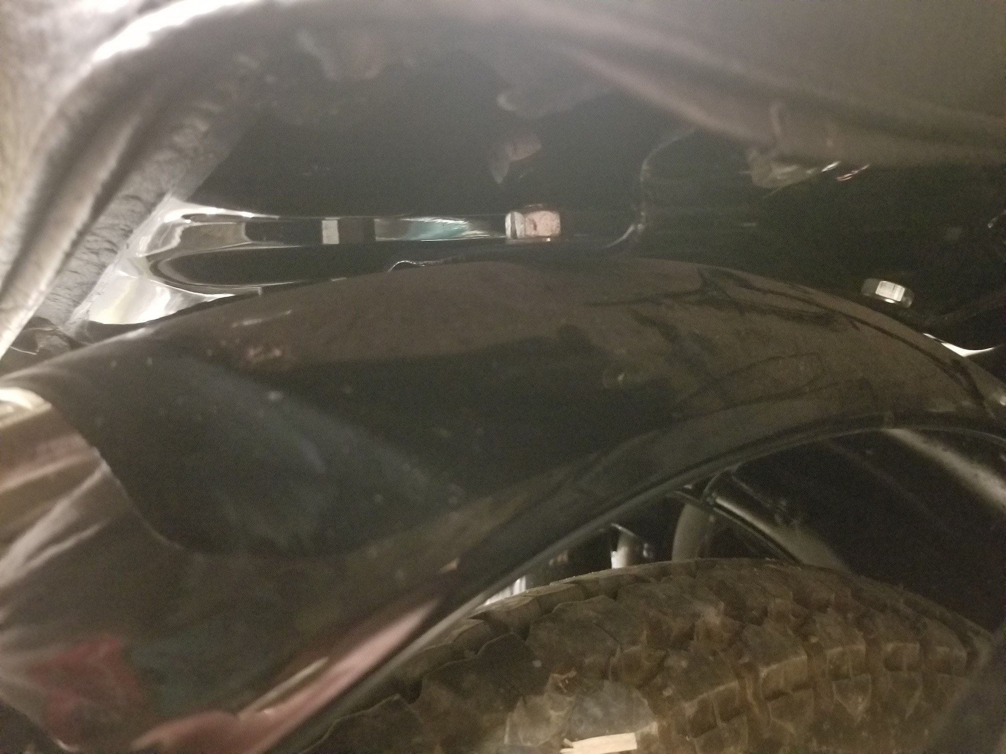

Now the rear is mounted with the same REAR bracket as Simon's seat (only half is visible in this photo):
I would appreciate everyone's input - do I have the real 53-54 seat pan and brackets here or possibly two later replacements? Or a mix?
I could really be wrong -- Chris' info seems plausible to me too (but doesn't match what I have here). The front lugs on my pan might fit a bar that picks up the shock mounts, for example.
