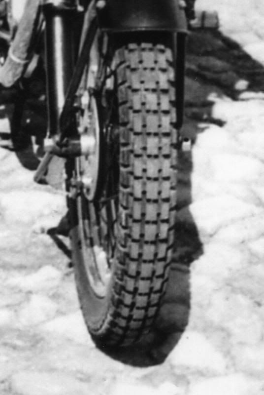

Hello Maurice, I agree, I have photos of my ES2 taken in 1950, when it was brand new and you can see this, silver in the middle and black spokes, I just would like to know if thespokes were painted or had some treatment, such as black zinc? Please see the photos.
