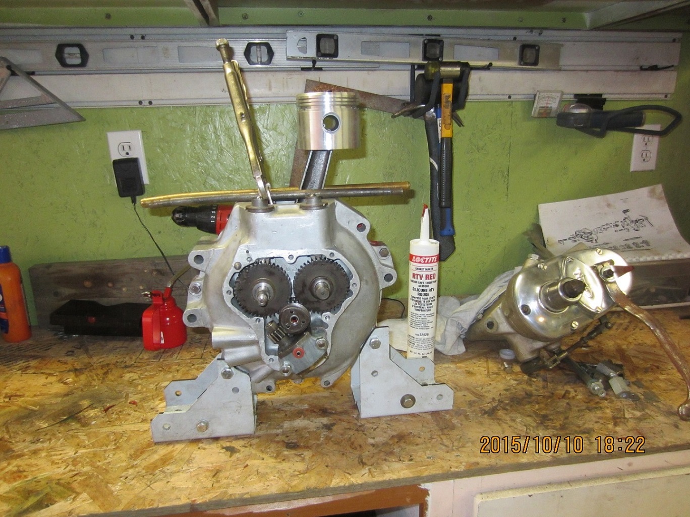

Evening, I made a bit of p…
Evening,
I made a bit of progress in the shop today. I attached a couple of pix.
Cheers from Halifax,
Bryon
Attachments IMG_0193.JPG img_0184-jpg- Log in to post comments
