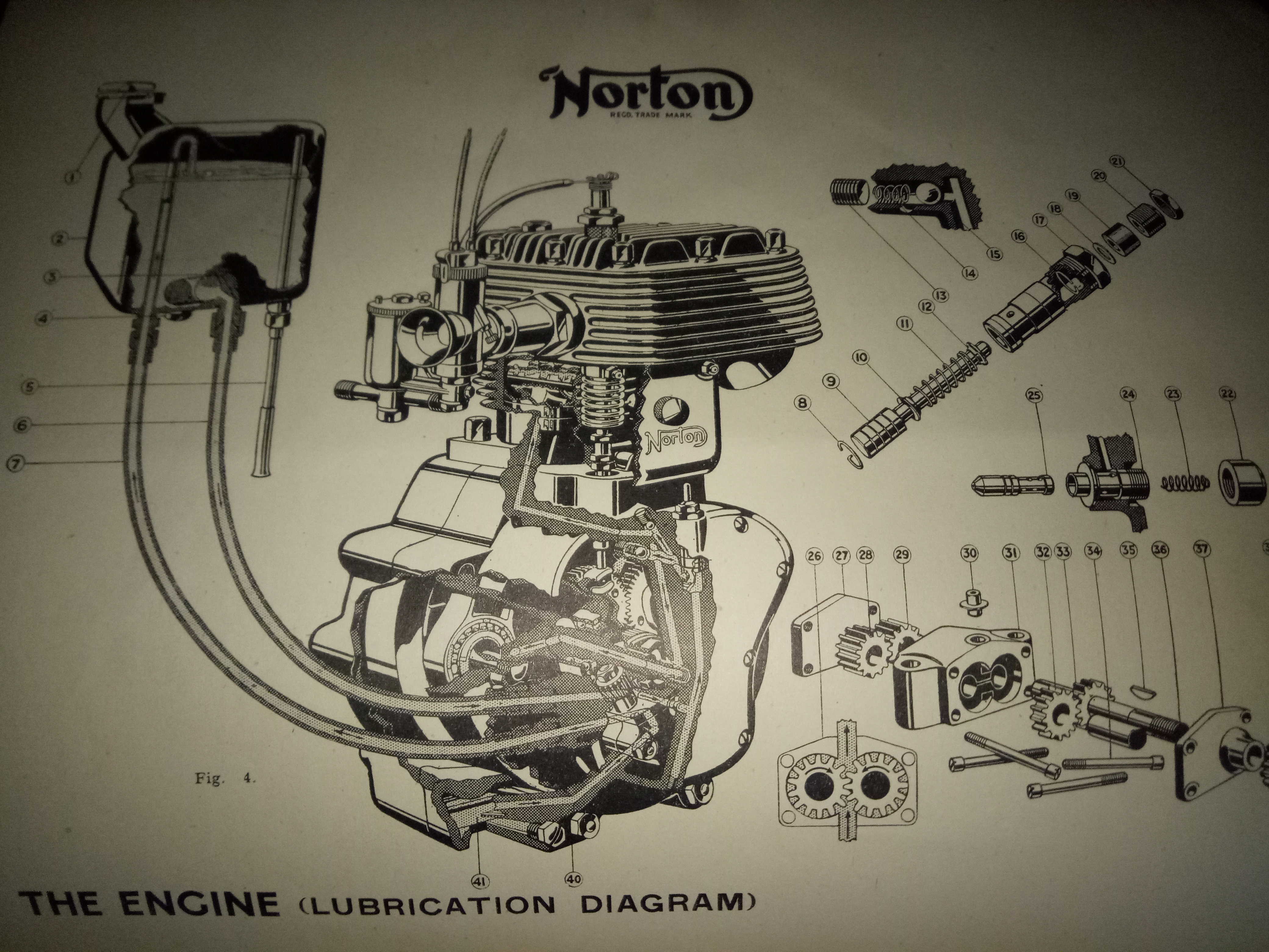

          Can anyone tell me how to pipe up oil tank to engine. There are 2 connections in bottom of oil tank, the feed has a filter so which port in the crank case does this one go in to. Obviously, the one below this is the return to oil tank, which crank case port does this go in to. The one in the back of the oil tank I assume is the air vent. I am wondering if this goes into atmosphere or back to engine. Much appreciated to anyone that can help. Mick
Crankcase feed is upper,…
Single oil lines
Yes David, 100% correct. Here's an illustration from one of my maintenance manuals.
Thank you so much, this…
Thank you so much, this really explains my problem.
The vent...
... just goes to atmosphere although I've attached a short pipe leading it to the rear chain on mine.
Crankcase feed is upper, return is lower. The cammy engines are the other way up...just to confuse.
