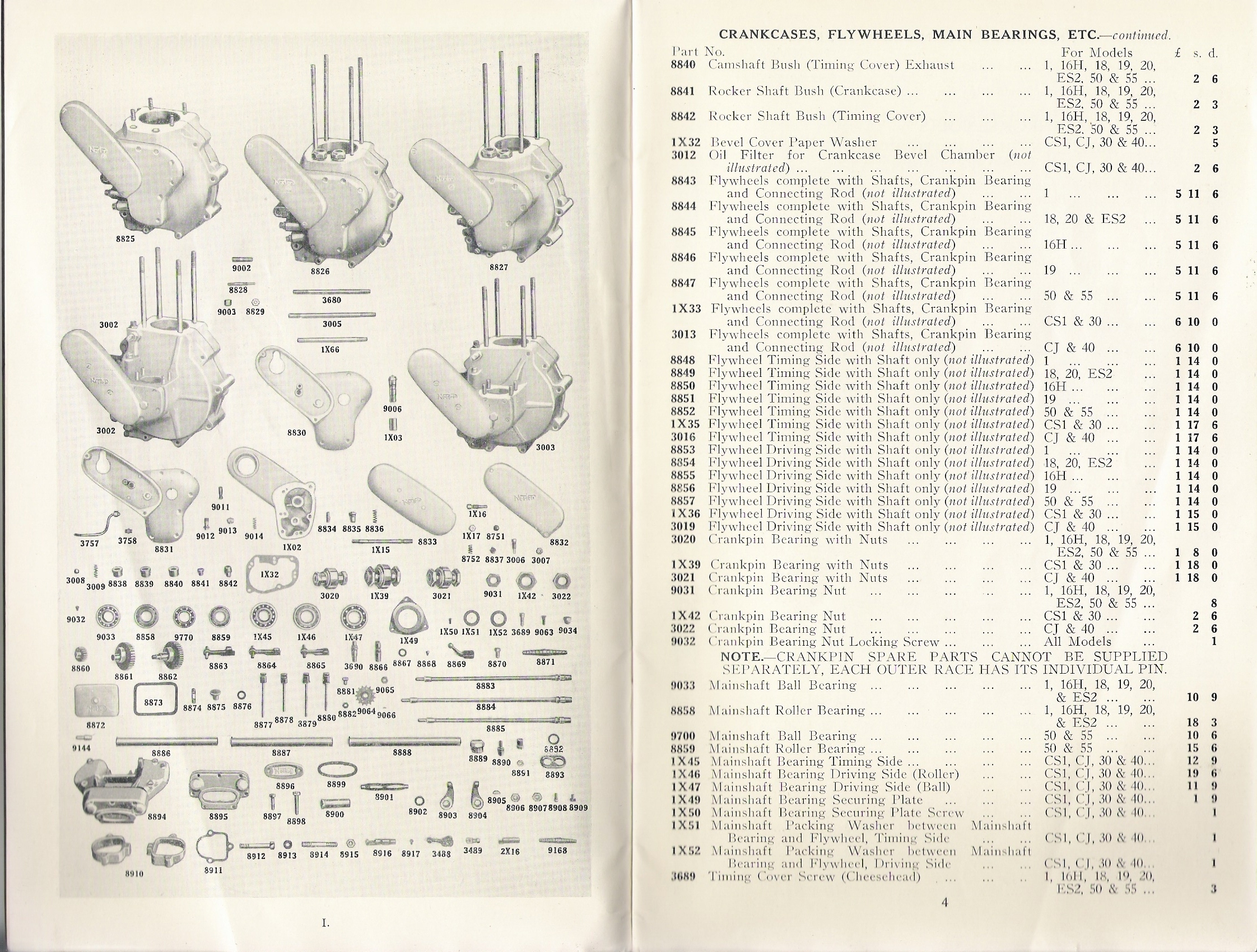

The immediate post-war lists are unillustrated and to make matters worse, they commenced a new system of part numbering.
However, the '46 machines re-used the 1938 pattern engine and the '38 books were illustrated, although in rather an old-fashioned way. John de Kruif's site includes a pdf scan.
https://drive.google.com/file/d/1kymcA4GBFwy00pG-wb5hE3XIqWpRnh1k/view
I've got an original if you need close-up images, but the images are quite grainy.1938
