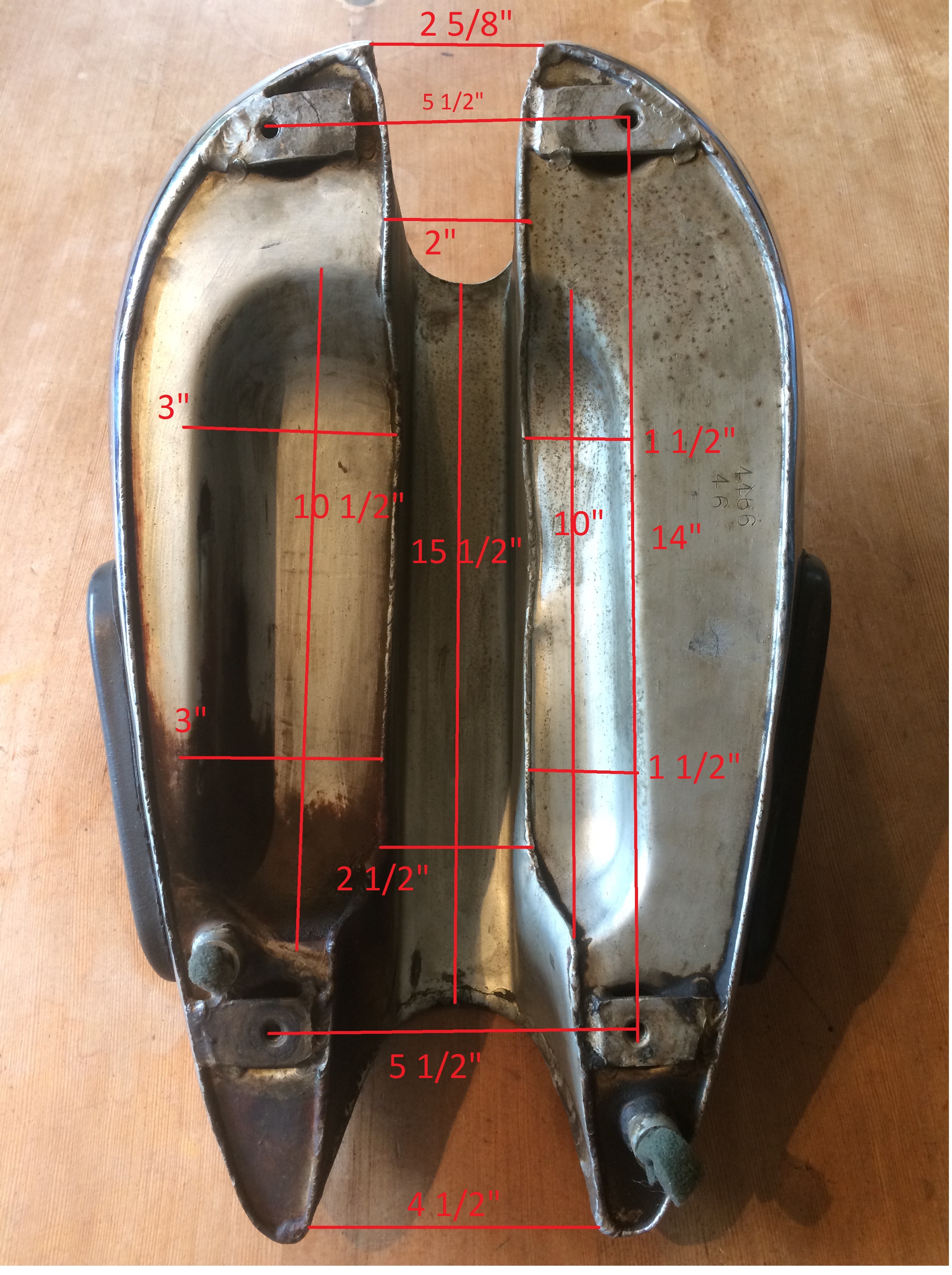

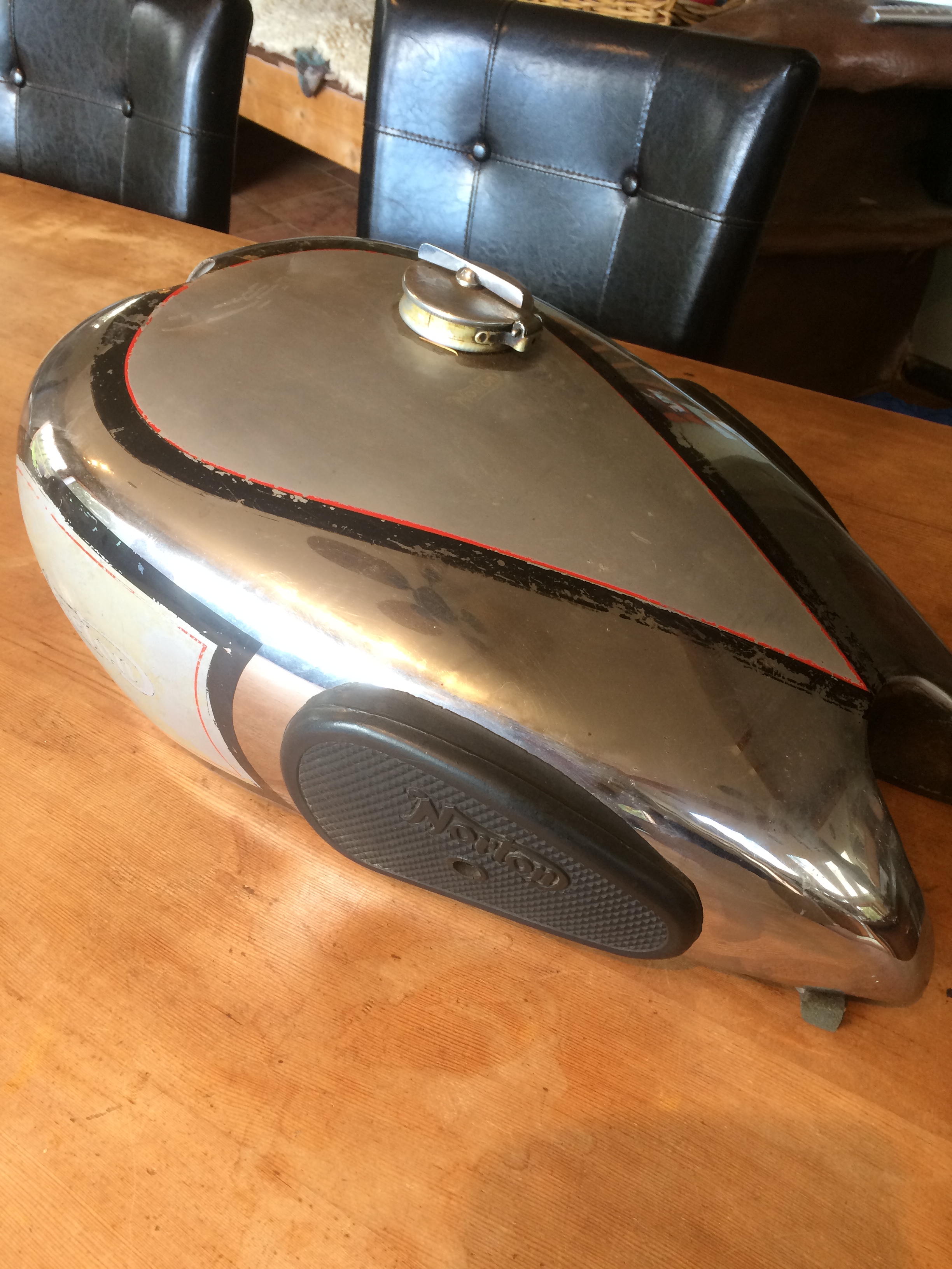

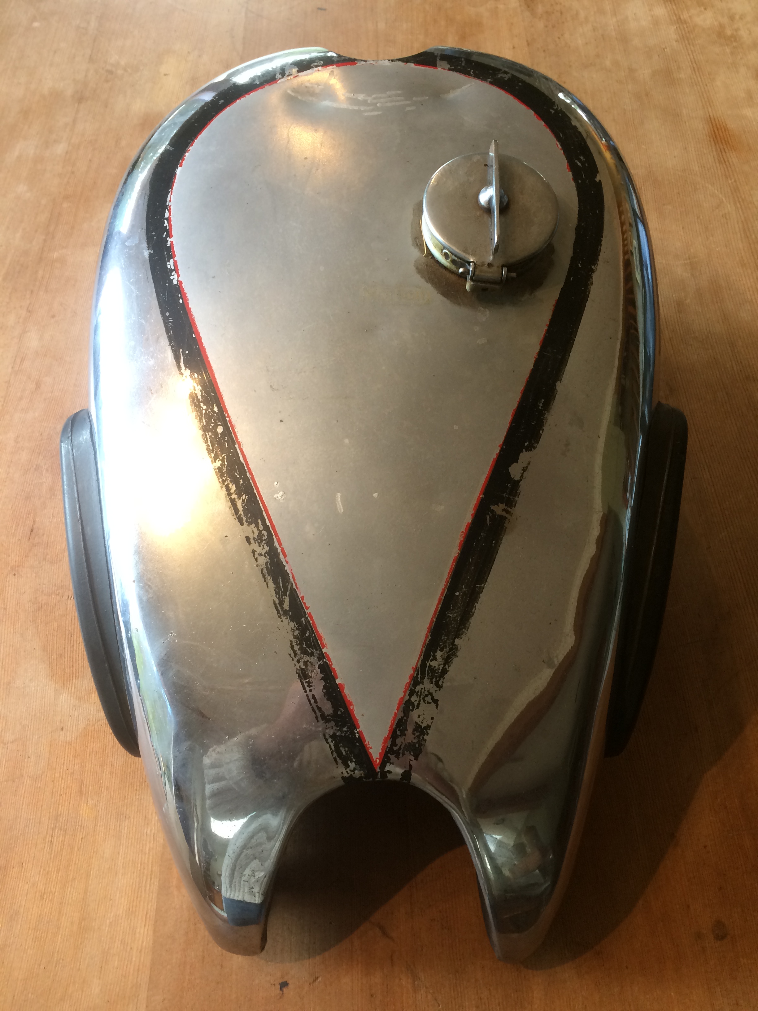

I would like to replace the tank; it is original and has a nice patina, but a lot of rust and scale on the inside.
Can anyone confirm that a 1940's 16H or ES2 tank is identical to the one I have?  Has anyone bought a tank from India that was a good fit for a 1946 Model 18?

BTW the bottom of the tank looks identical to my 1956 ES2. The fuel cap, knee pads and of course the badges are different.

The underneath of the tank is correct for an o.h.v. engine.  Clearance required both sides of the centre line for the rocker box. An ES2 or Model 18 from 1946 - 1950 will fit. A s.v. tank from a 16H will have a hemispherical dome to allow the tank to clear the spark plug.
I940's o.h.v. tanks have the knee pad held on by a single screw. 1951 had a different shaped knee pad held on by two screws

If it’s not leaking or too thin to trust you would be better off getting it refurbished.  Rust and scale  are easily dealt with.  If it’s in the underside you can repair. Top sides look dent free.  A good polish and relining  and you retain your originality.

The original tank has a nice patina, and is reasonable cosmetically, however has some damage to the paint and some small dents near the steering head.  Inside it needs some serious descaling and its possible that the process could further damage the original finish.  If I can find a good replacement tank, and keep the original safe and as-is, I feel that might be the better way forward.

   The shape of tank you have was first introduced for 1936 and continued until 1949. From 1950 the capacity was increased and the tank took on a more rounded and modern appearance. All these tanks have the same bolt hole dimensions. Pre 1946 tanks for 16H and Big 4, as Ian R says, had flat bottoms with the inverted dome to clear the spark plug. After WW2 production was rationalised and the OHV type tank was fitted to all SV models. If you are considering buying a new tank, try searching the forum on this subject as I think Phil Hannam bought a replacement Indian made tank and wrote some relevant information.

...are the only type that you have to avoid. Part No. 3723, introduced in the 1936 parts list as Richard indicates is listed for all SV and OHV models, including the 350s. The 'Flat bottom tank with recess for sparking plug' was introduced to increase capacity for the military models which then responded by breaking the front tank lugs....Any tank with the dome will be WD. The WD Big 4 had a large cutaway visible from the side, but mostly covered by the knee grip.
All the pre-war SV / OHV civilian tanks will fit although there were also panel and gate change options.
