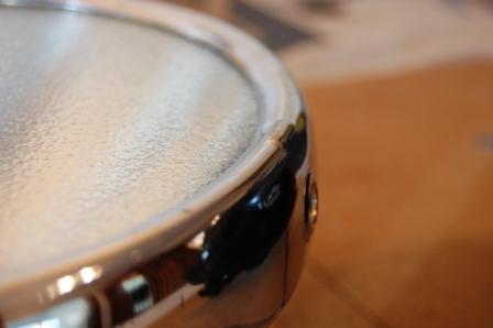

Picture of rim. Previously…
Picture of rim.

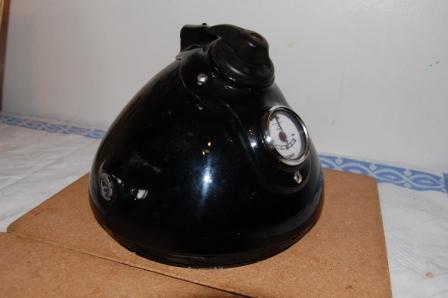

Picture of Headlight Shell…
Picture of Headlight Shell - Overview

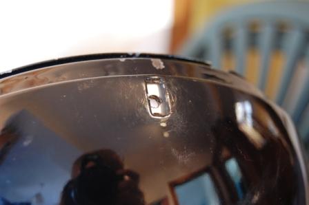

Close up of head light she…
Close up of head light shell showing where clip locates. Note that the aluminium with tapped hole that can be seen through the rectangular cutout in the shell is a non-standard addition (removeable)

It's quite different from…
It's quite different from my 1939 DU142 which has a flat glass.
[IMG]http://i248.photobucket.com/albums/gg164/commando16h/NOC/8inchschroefrand2.jpg[/IMG]
Thanks. Looks like my rim…
Thanks. Looks like my rim is the wrong type.
I take it that you don't have the clip for your headlight?
Richard

Hello Richard.
If I may, If you look, zoom âin on the bike profiles on my suggested web page it can be seen quite clearly these machines have a 2 part clip with screw between them, this seems to be an early type.
However web sites selling repro DH142 lamps show the clip type with rolled end to the rim.
www.draganfly.co.uk
The rectangular hole in your head shell is reminiscence of a hole for a captive nut, so it canât rotate, how are the actual headlight fixing arranged maybe there are similar. It would be a possible fixing for the clip end.
Ron.

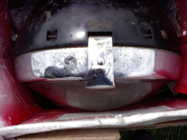

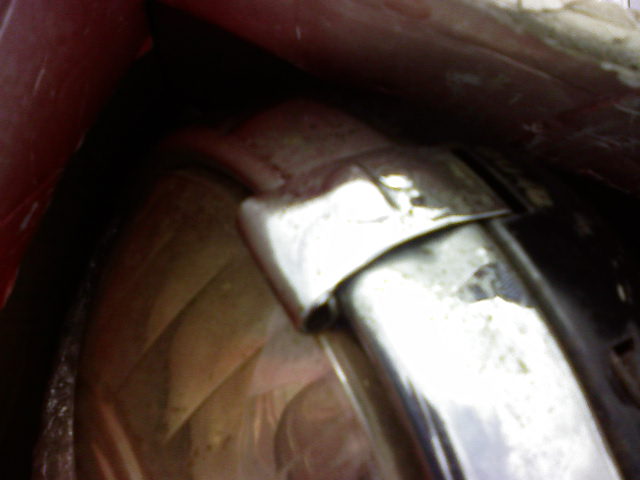

Hello Richard-attached are 2 photos taken of a headlamp at a autojumble,although the headlamp(original Lucas) is stamped DU42 you may need a similar clip.
Happy hunting--Ron Milton
