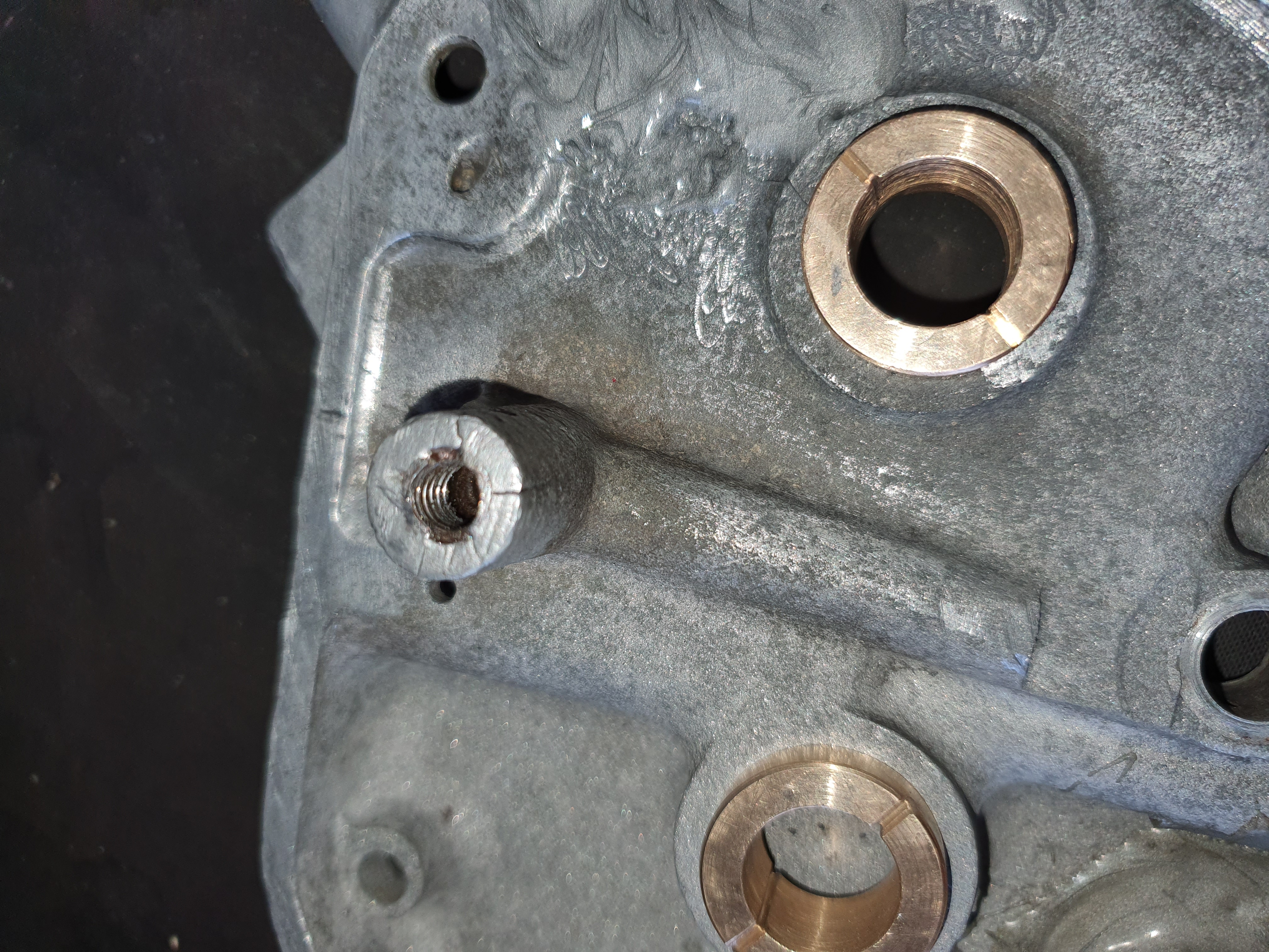

Hi Bob,
This is a photo of the oil pressure relief valve on a 1934 16H. Might be the same. the inside of the timing cover, Right hand side of the motor.
