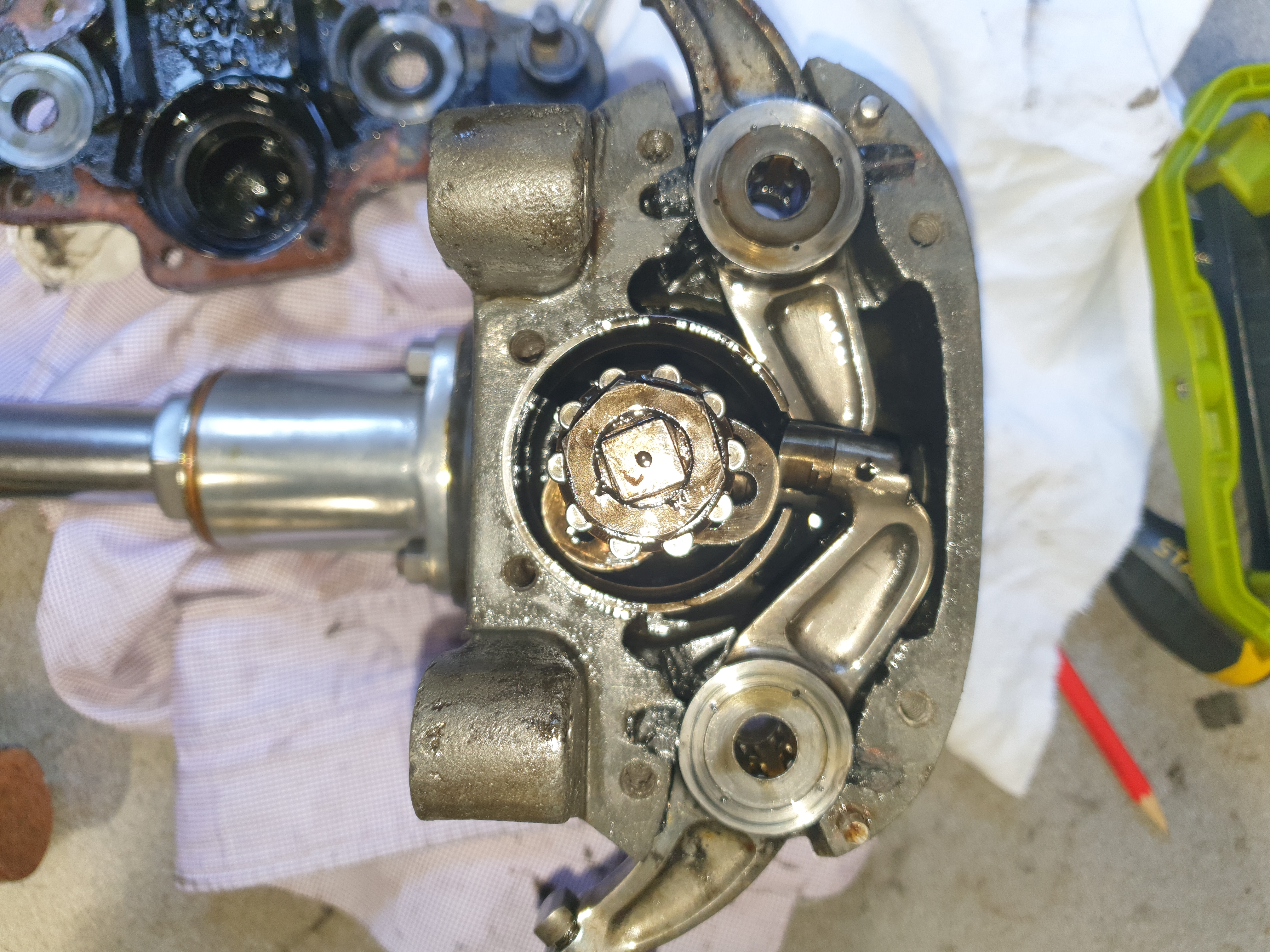

OK, there are one or two bits that still need some work. I have done about 50 miles on it so far and it's going brilliantly. But is leaking out the cambox even more than I would expect, so once its run it I will have the cambox off for another go at those wipers and seals. There are also a few bits and pieces still away being plated but nothing thats stopping me ridining it. And boy am I enjoying it, even though I'm taking it easy for running in it goes really well and handles better than just about any bike I have ever ridden!

An oil leak from the cylin…
An oil leak from the cylinder head ? You really should have held out for a side-valve, Andy !
Very nice. Did you find any trace of the works preparation ?
Yes. It had different cams…
Yes. It had different cams, flywheels, conrod, and big end to others I have seen. It also has the central feed oil in the cambox that was fitted to all the Manx's. I dont pretend to be an expert on them and I am sure there will be other things that I find out about later. But it was an interesting thing to work on!I have retained all of these parts in the rebuild (it has new cams but I went for the manx ones rather than inter ones), appart from the piston, I have gone for and ES2 piston to keep the compression ratio down and hopefully make it a bit more user friendly.
The crankcases are different too. An extra breather and no tell tail for the oil pressure. They also don't have the web for an enclosed primary chain case, I have seen magnesium cases like this, but never another set of ally ones. Has anyone else?
Having done about 50 miles on it the wipers in the cambox apear to have given up and I have oil everywhere. I think the rubber I used was too soft, so I am going to take the cambox off today and have another go. I know it will leak, but I'm determined to improve on what it is like at the moment!

Should either of you gentlemen have the need for cam box sealing wipers, Stu Rogers (SRS Norton) stocks them...
Rocker sealing wipers
Bottom ones look oil eaten; tops have the canvas insert which are much better. rest of t looks decent.
My 56 Manx with 38 Inter motor had adjusters top and bottom. Not sure if it was a factory fitting or a desperate attempt to stem the flow. Came out of George C's stable. She was quite dry...
Bottom ones are just oily…
Bottom ones are just oily. They seem to work as well as can reasonably be expected. No top adjusters. I think they won't fit on some frames. I imagine they would make it more difficult (if not impossible) to remove the cam box on some bikes. But I think the gap on top varies. Were there different top tube shapes?
Cambox / frame clearance.
Hi David/all,
Stu Rogers was modifying SOHC camboxes with 2 adjusters on each seal ( 8 altogether ) over 40 years ago, so these bikes may have been through several owners over that time. I can't remember anyone else doing this back in the day, but it is quite possible.
With a 500cc Model 30 and 30M engine in a rigid / plunger frame the clearance between the cambox and top tube is not much over 1/4". The 350cc 40M engine is slightly shorter and the Model 40 is 1/2" shorter still, so no problems there. In 1949 the Manx frames were modified to take the DOHC engine and the top tube became significantly re-shaped with a double bend to clear the elongated cambox. During 1951 the Clubman's Inter frame was being made using left over Manx lugs and a curved top tube which was then used to the end of plunger frame production. The 1930s CJ frame was lower than the CS1 so these clearance gaps will vary.
