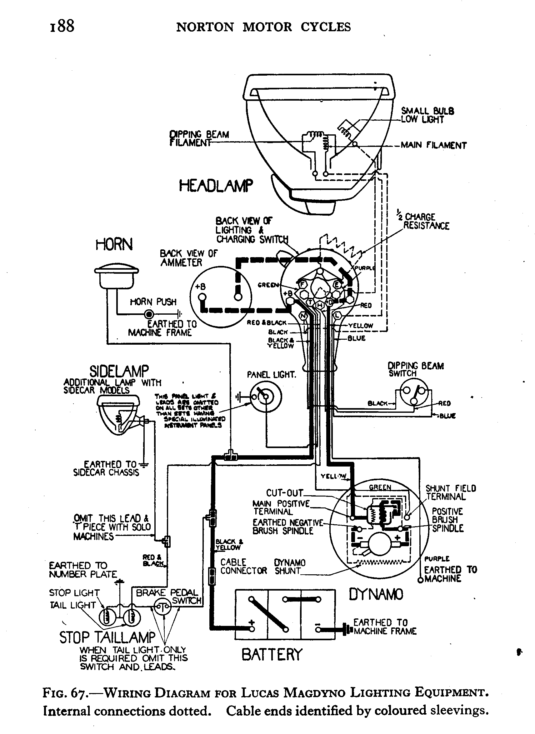

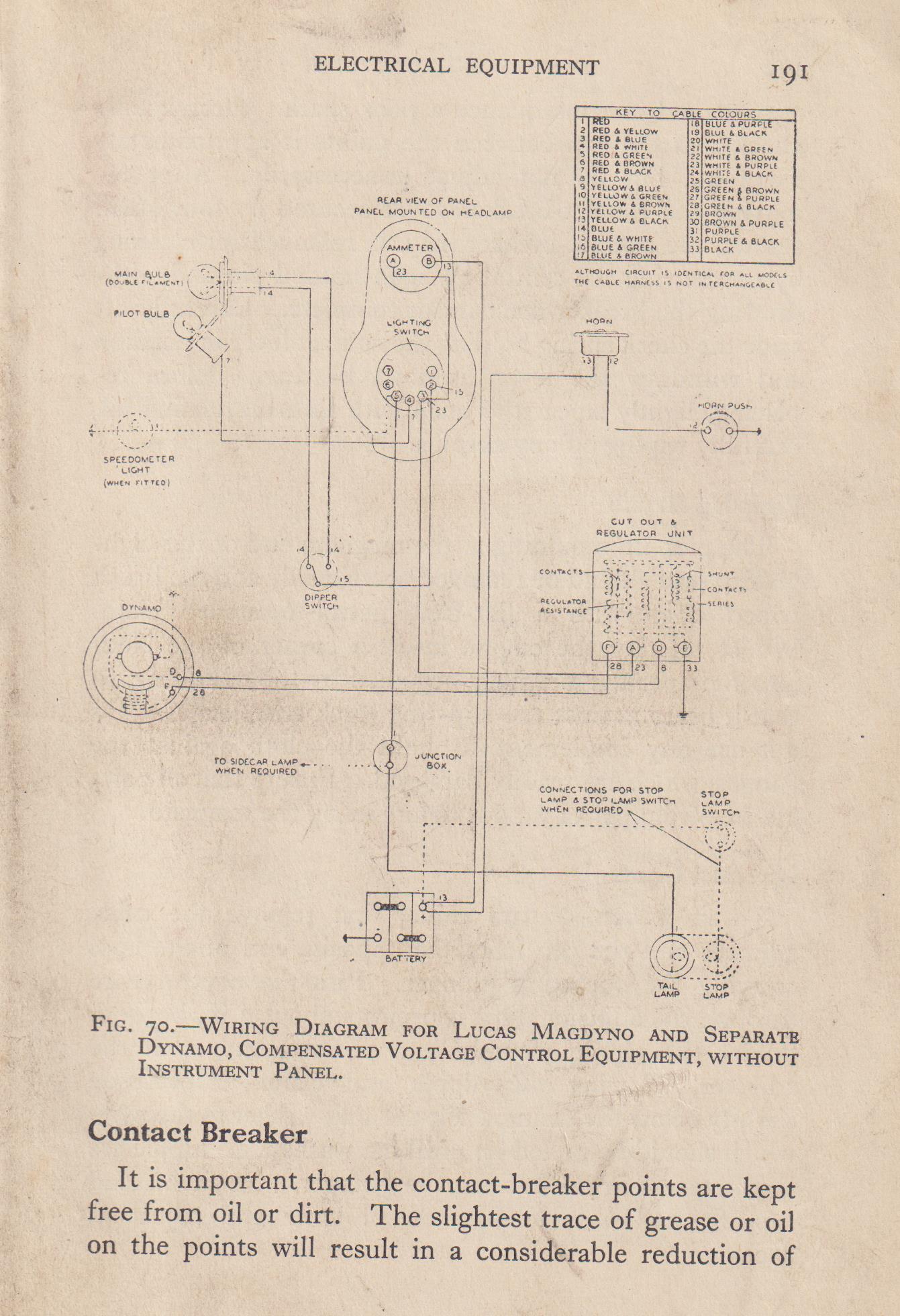

Hello guys. I am after an image of a wiring diagram for a hand gear change 1934 16h, quite rare l am told? It has all guages and switches on the tank. I have lots for my other Nortons but this one is significantly different and l am struggling.
Any help greatly appreciated..thank you
E.M. Franks Maintenance Book
My copy of the Franks Norton Maintenance book informs that from 1932 to 1962 there were only two variations of wiring for all the singles.
Attachments show both diagrams.
