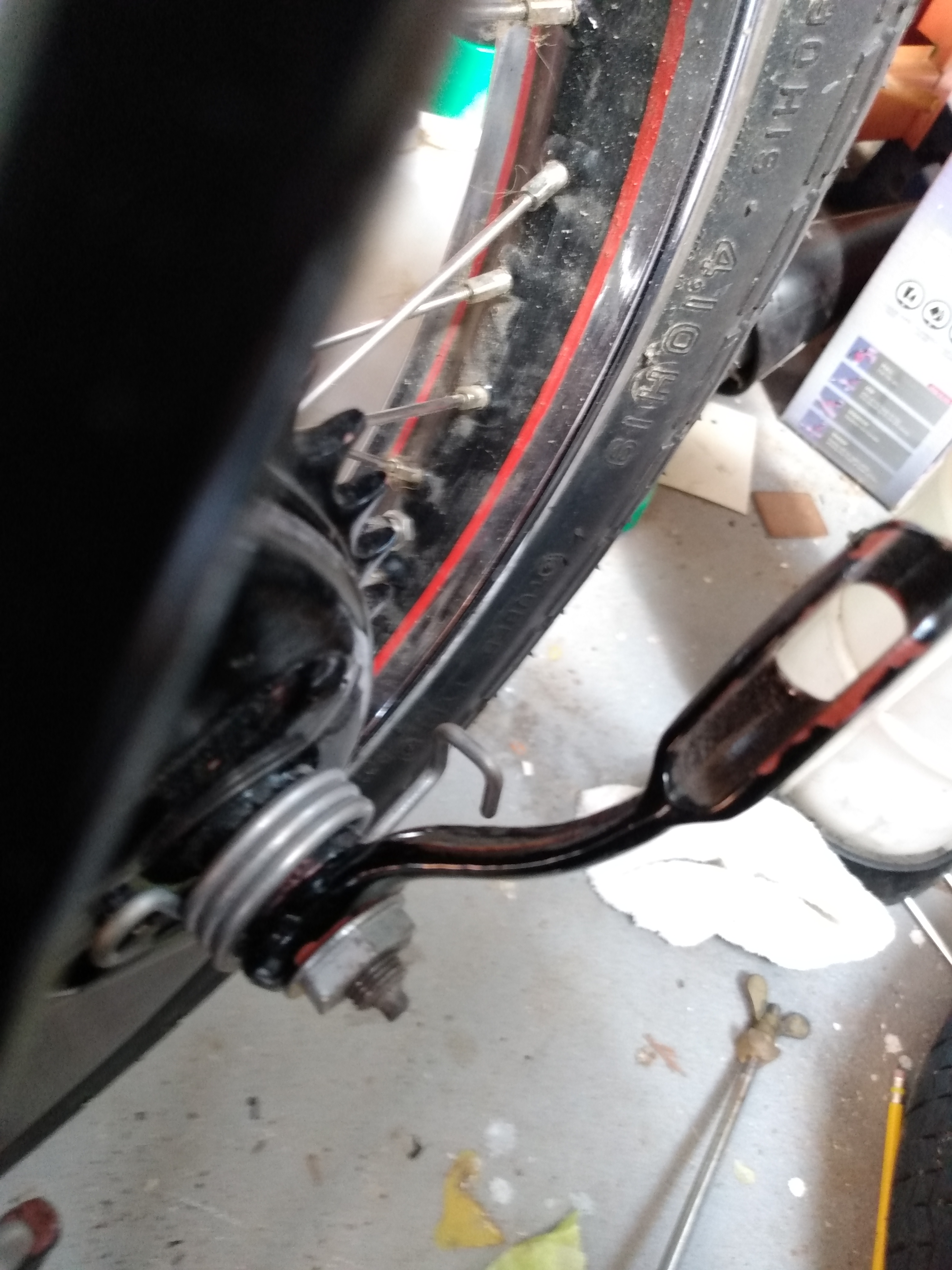

The rear brake seems to come back by itself easily. I was told that it actually needed a spring for the return. The spring is on but does not seem to work. What is the issue?

   The brake arm will return as there are return springs inside the brake drum on the shoes. The external spring is needed to return the long and heavy brake pedal so the hook of the spring needs to be around the brake arm.
