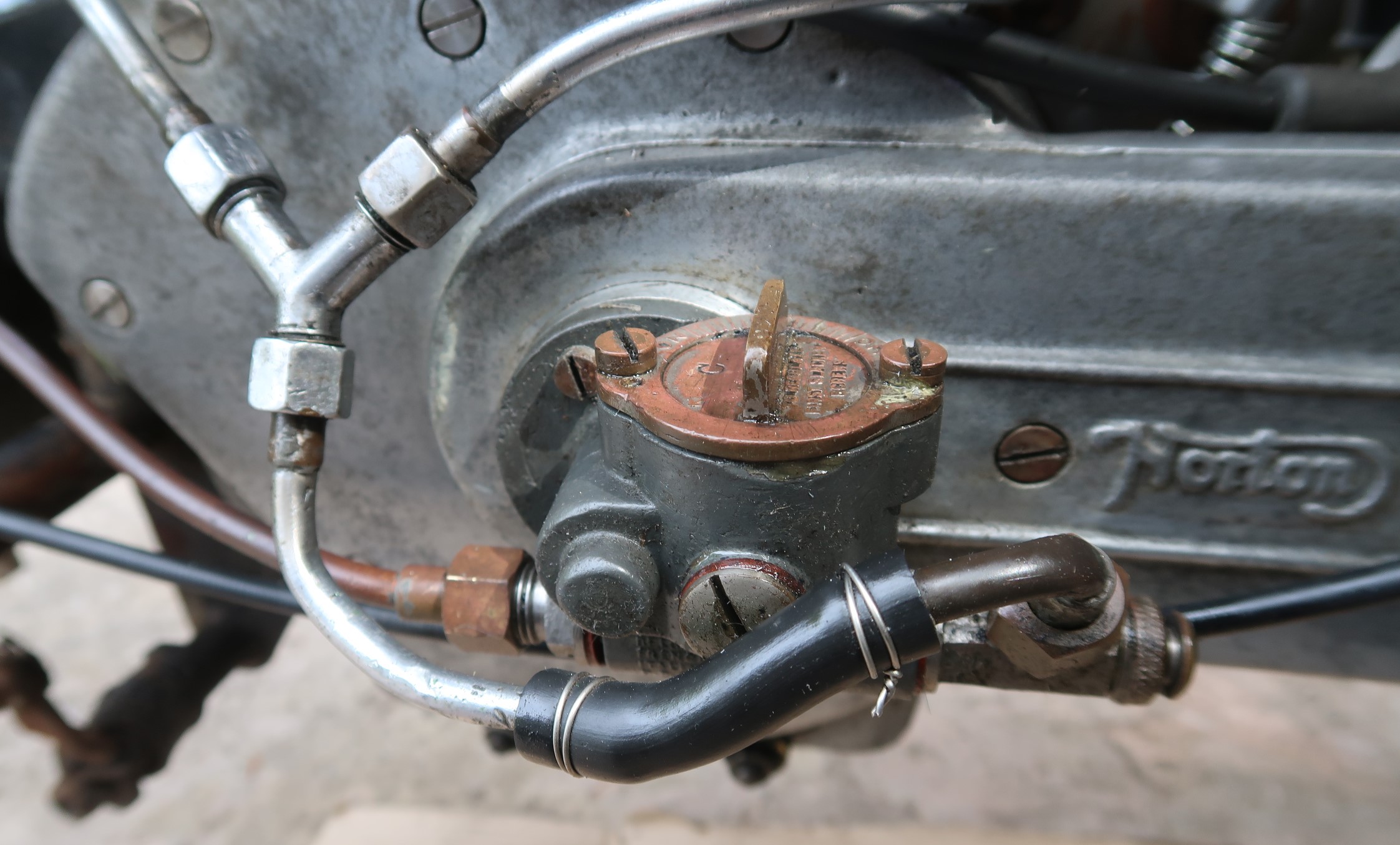

I need some help please. I've just taken ownership of a 1928 Model 18, in original condition and am re-commissioning it ready for the road i.e. new tyres / tubes and brake linings. But the oil pump drips and I would like to identify the make and model of the pump so that I can hopefully source some spares.
Hopefully the attached photo shows the pump for someone to identify.

It's a Best and Lloyd…
Best and Lloyd pump for Model 18

It's a Best and Lloyd Mechanical Mark II and looks like it has a plunger fitted to show the oil is circulating.
Same as my 1928 Model 18. Can attach catalogue drawings if they will assist.
