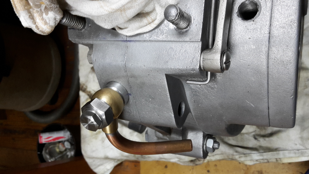

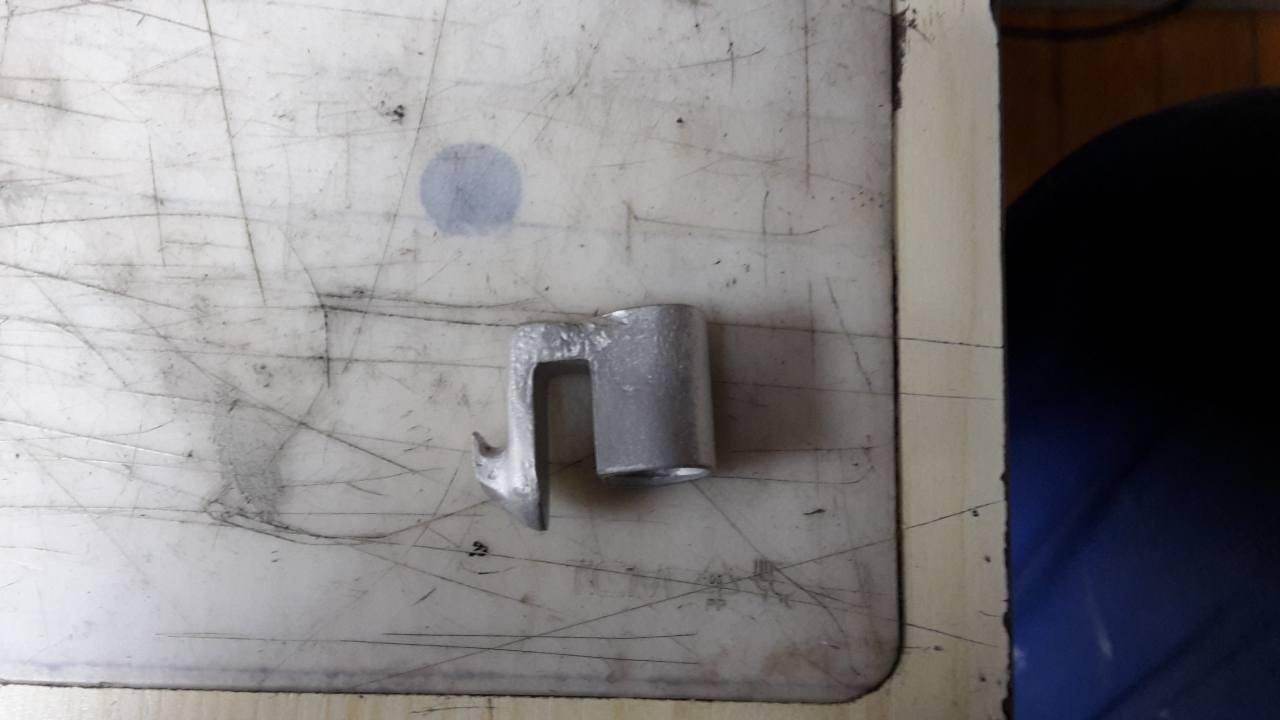

Hello,
can anyone thell me the purpose of the small hook on the side
of the valve lifter of my 1924 Big 4. See picture.
kurt

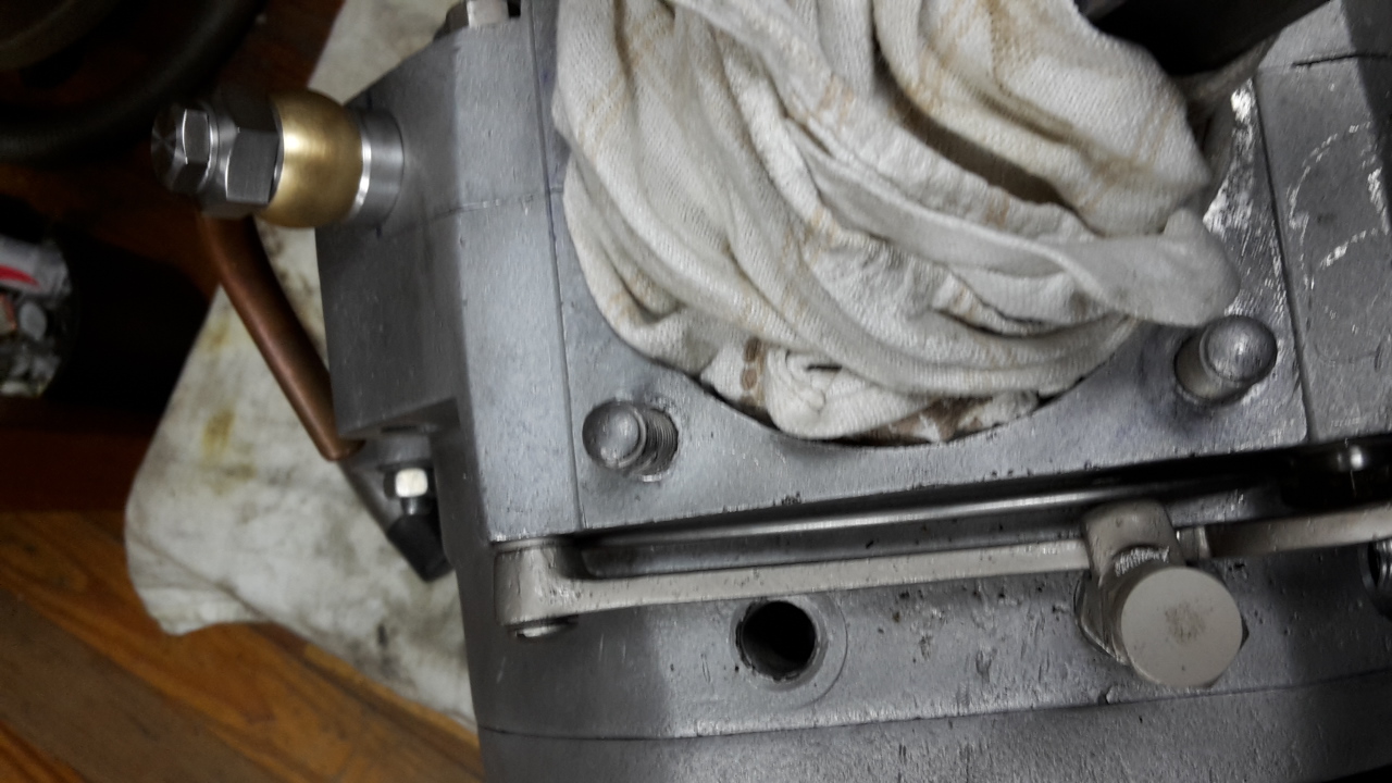

After seeing your post my curiosity started me down a pre-war Norton rabbit hole of online image searches.  Looks like a rod (maybe 1/8 in diameter) curls around back corner of engine case, travels below pivot point of exhaust lifter arm, and stays situated between lifter arm and engine case headed forward towards exhaust valve.  I haven’t seen a clear picture of where it terminates though.  No idea what it’s function might be either.  Possibly a tension spring as it looks like it might ride against forward portion of lifter arm pivot.
I will cite Bonham’s Autumn 2019 Stafford Sale of a 1925 16H with swallow sidecar as a decent visual reference of the rod in place.
Good luck hope that helps you out
Thanks a lot for Your very helpfull information. I think the long rod acts as a spring
to hold down the valve lifter. May there was no coil spring around the lifter cable in these
day.
I´ll find out.
