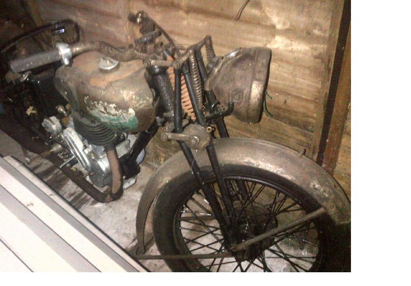

some bits for the bike plu…
some bits for the bike plus one of the spare engines
WOW! This is a real projec…
WOW! This is a real project to get your teeth into. We all look forward to following our progress.

Well its been 7 months and…
Well its been 7 months and ive only just managed to finally pick the old girl up!! luckily my friend is very understanding and was happy for me to collect when i could!! so heres another couple of pictures out in the sunlight after so many years! but her big question now is to fully restore or to leave alone as i rather like the worn look????
small001-jpg
all i have to do now is wo…
all i have to do now is work out what bits im missing!
small002-jpg
If the bike was complete t…
If the bike was complete then it might be nice to leave it unrestored and just use it, but as there is so much missing and the parts you find won't have the same patina, you wont get it all looking the same, so I'd strip it and restore it.
I've just finished my 16H and it's 1942 so an idea what yours would have looked like. Good luck with what you decide to do
