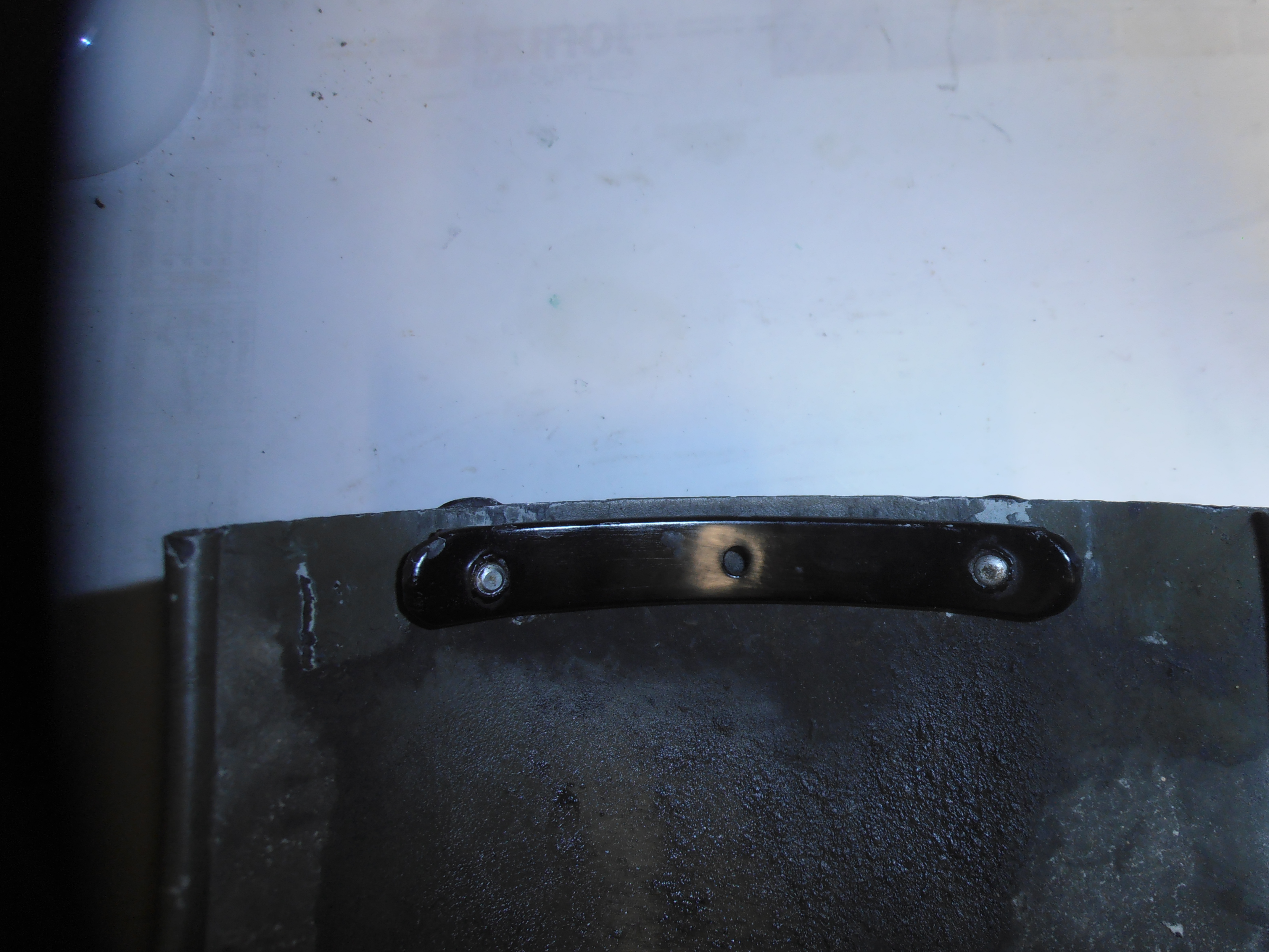

Hi Beverley,
There is normally a metal strap with 2 captive nuts attached. This fits under the main mudguard and when the tail-piece is fitted it clamps the 2 parts together. When you want to remove the tail-piece you just need to loosen the bolts and slide it from the slots in the main guard. You could make a new strap from a 1/4" x 5/8" metal strip bent to shape with 2 threaded holes which will be thick enough with-out nuts.
Fixing Strip
This is the fixing strip on the post-1937 rear guard (with double top number plate bracket fixing)

Thanks. that sounds rational. Will do that. I made one up but did not thread it!
