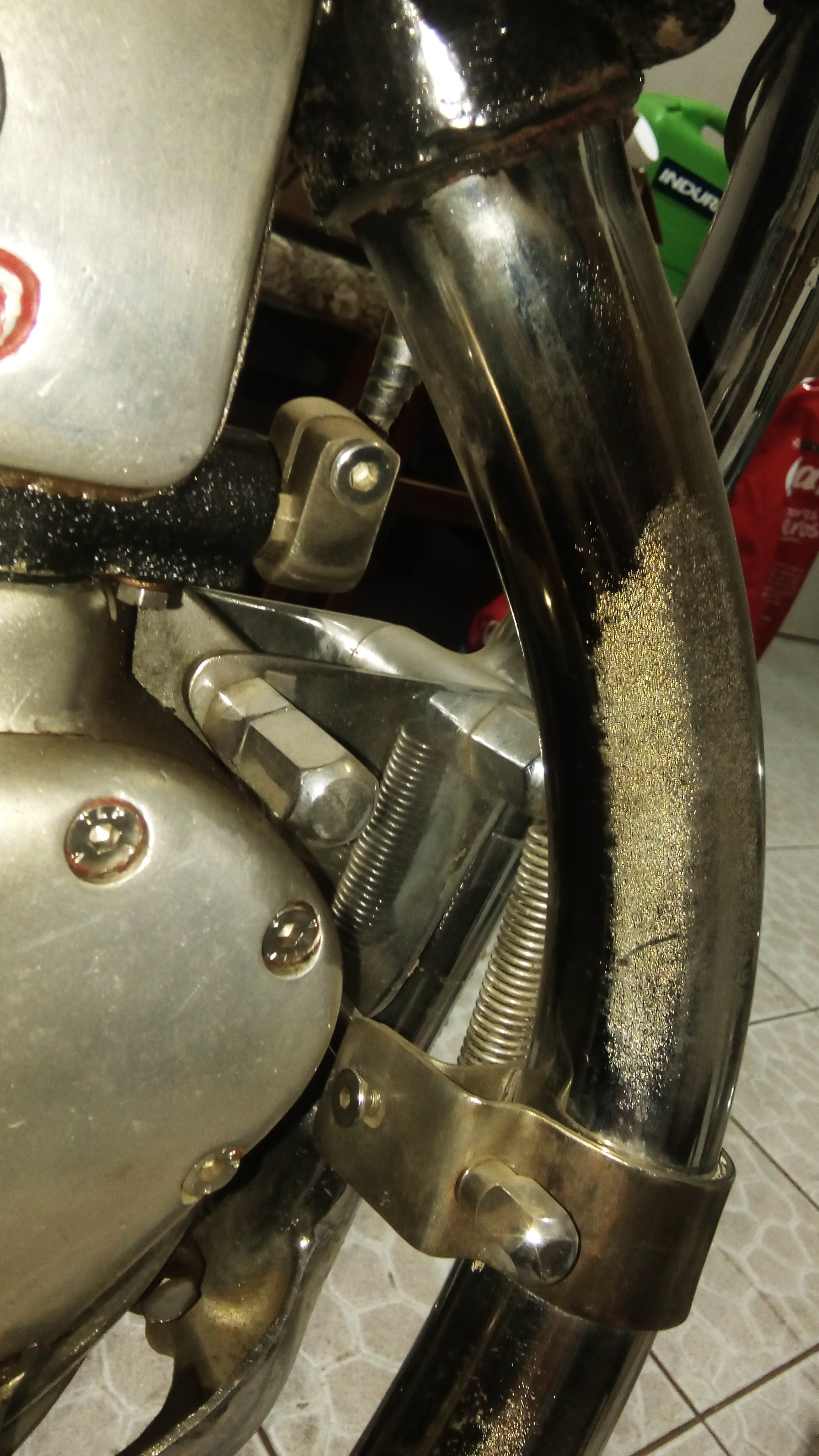

sello de amianto
Estimado Francis, mi solución fue además de juntas de amianto, un sellador de silicona de alta temperatura, además de un buen ajuste del tubo de cilindro, (el traductor deforma un poco lo que me refiero)
Saludos, Gerardo Zamparutto.

Neat solution if you have a…
Neat solution if you have a problem. The earlier bikes (before WD bikes) did not even have a bracket to the front of the engine.
Forward mounting
When my ES2 silencer bracket failed the other week (fixed temporarily with a Mole wrench - now done properly) the whole weight of the pipe and silencer was hanging off the cylinder head mounting. I'm surprised it was strong enough.....
