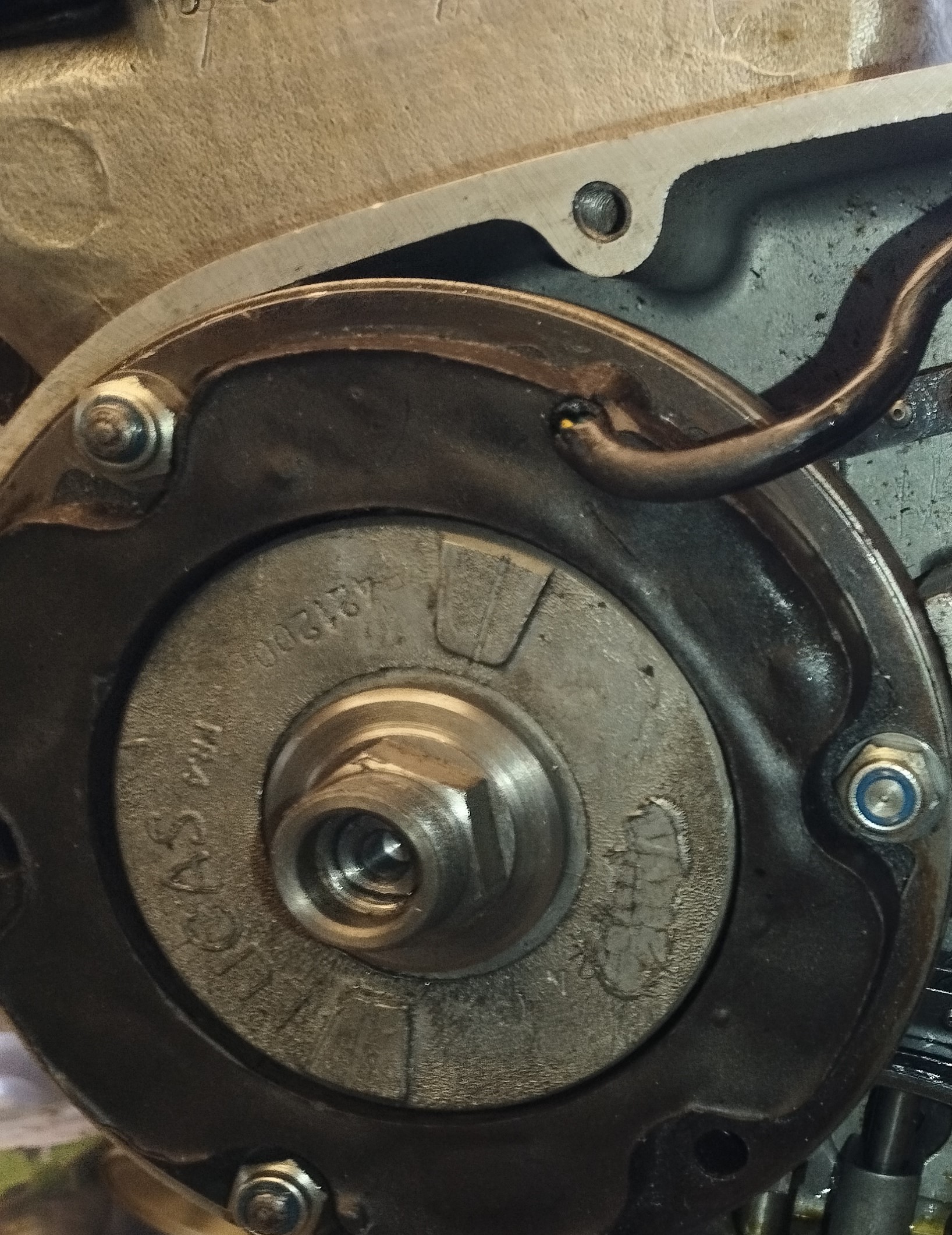

As for fitting Lucas equipment to the lightweight, what's that on the end of my Navigator crank shaft?

As for how I fitted the Lucas 3/4" bore rotor, I don't want say just yet, I've only done a few hundred miles on the bike, plenty of time for disaster to strike.  I will say I didn't bore a rotor to fit.  That idea, I have read, has been dismissed as not being feasible.  I'm not so sure about that, it may be just possible to open out the bore enough and get a keyway in to it to fit a lightweight.
I've made a number of significant modifications to my Navigator engine, when I've proved to myself all is well (or not!) I'll write something about them for "Roadholder".
