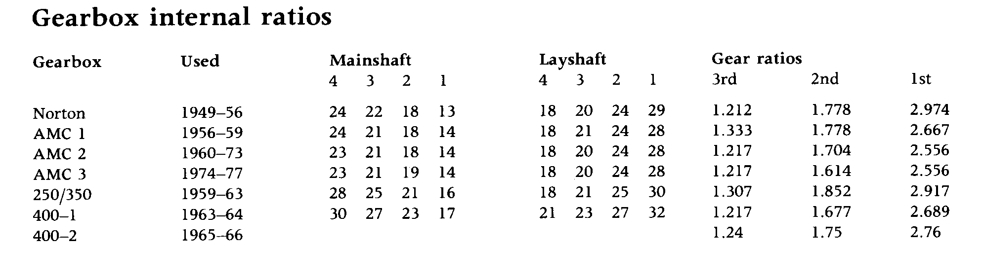

The attachment shows the standard gearing of the relevant Nortorns twins. There are variations of the close ratio 4 speeds which generally result a very high first gear.
Good document to have.  I was interested to know if there are visible external difference or markings to identify an AMC 2?

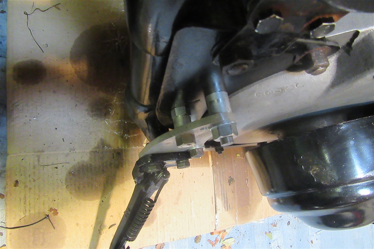

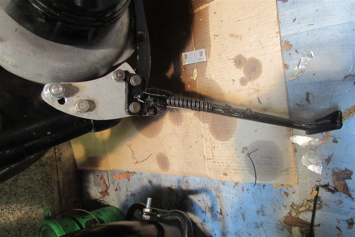

In terms of side/prop stands, I posted some time ago about the one I have fittted to my bike using a Kawasaki item and an extra front engiine plate - it works very well. I agree about the centre stand which is a nightmare on my plunger framed bike and sometimes needs my wife's help! I attach a couple of photos of my prop stand.
