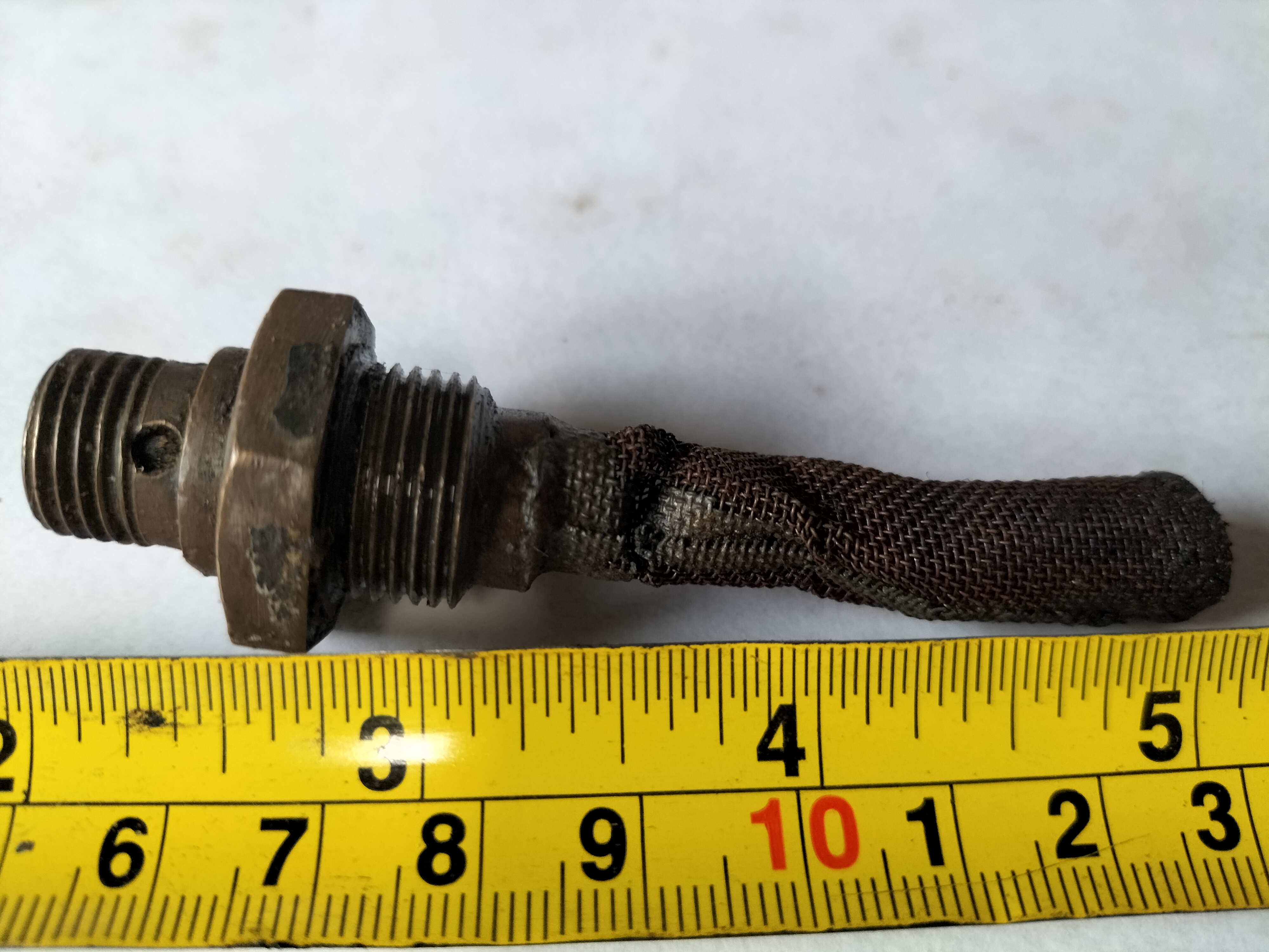

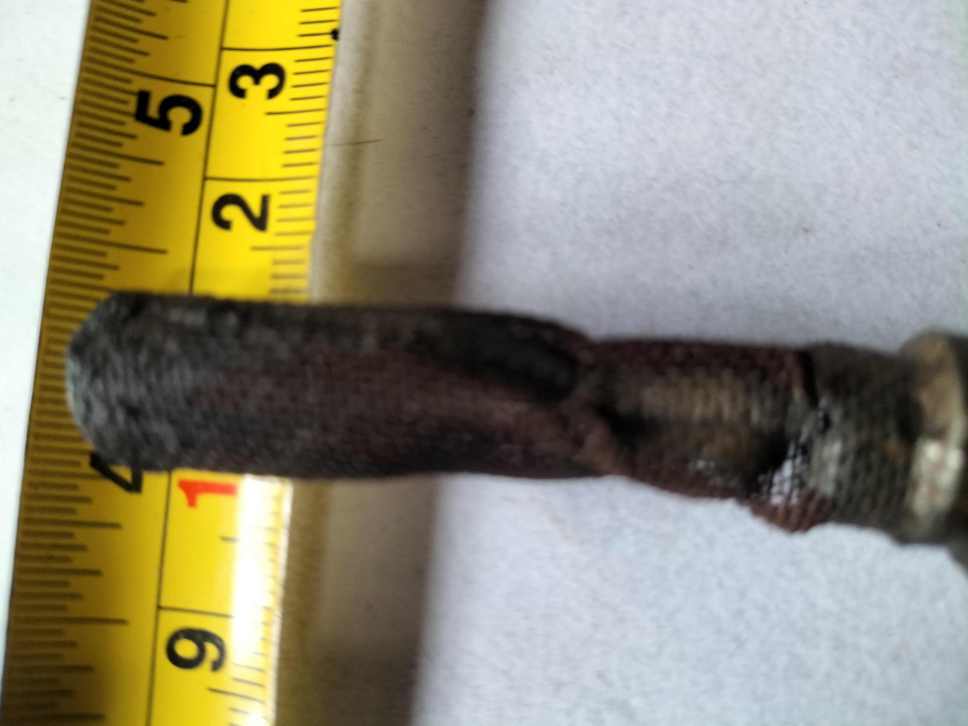

Oil filter union
Alan,
Here's a couple of photos of the filter union that was fitted in a very old CS1 oil tank I have picked up.
The union looks original as the tank was unmolested and the union tight in the tank.

Hi Steven,
Not sure I fit the bill. I have a 1929 CS1, but it is all together. Restoration pretty much complete, just need to get it sorted and out and on the road. Nb I acquired it as a partially restored machine.
One query I have is the Oil tank filter. I am looking for a decent photo with dimensions as I am not sure the gauze element on mine is quite correct.
If your bike is disassembled, would you be able to take a pic of your filter ? Much appreciated if you could do. Otherwise, more than happy to to try and answer any queries you may have.
