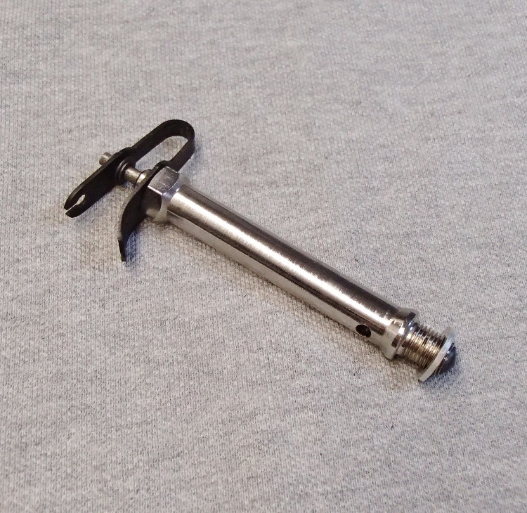

Other option is a chainsaw decompressor on each cylinder which is used on hi compression 850's and 920's but it must be done with care.
I agree in  theory a wilder cam should help , but I have  a full race cam on  my 250  single and  you can stand on the KS   or lock the wheel bumpstarting   and thats only 9 to 1 comp.  Chainsaw decomps  sounds a good option.
