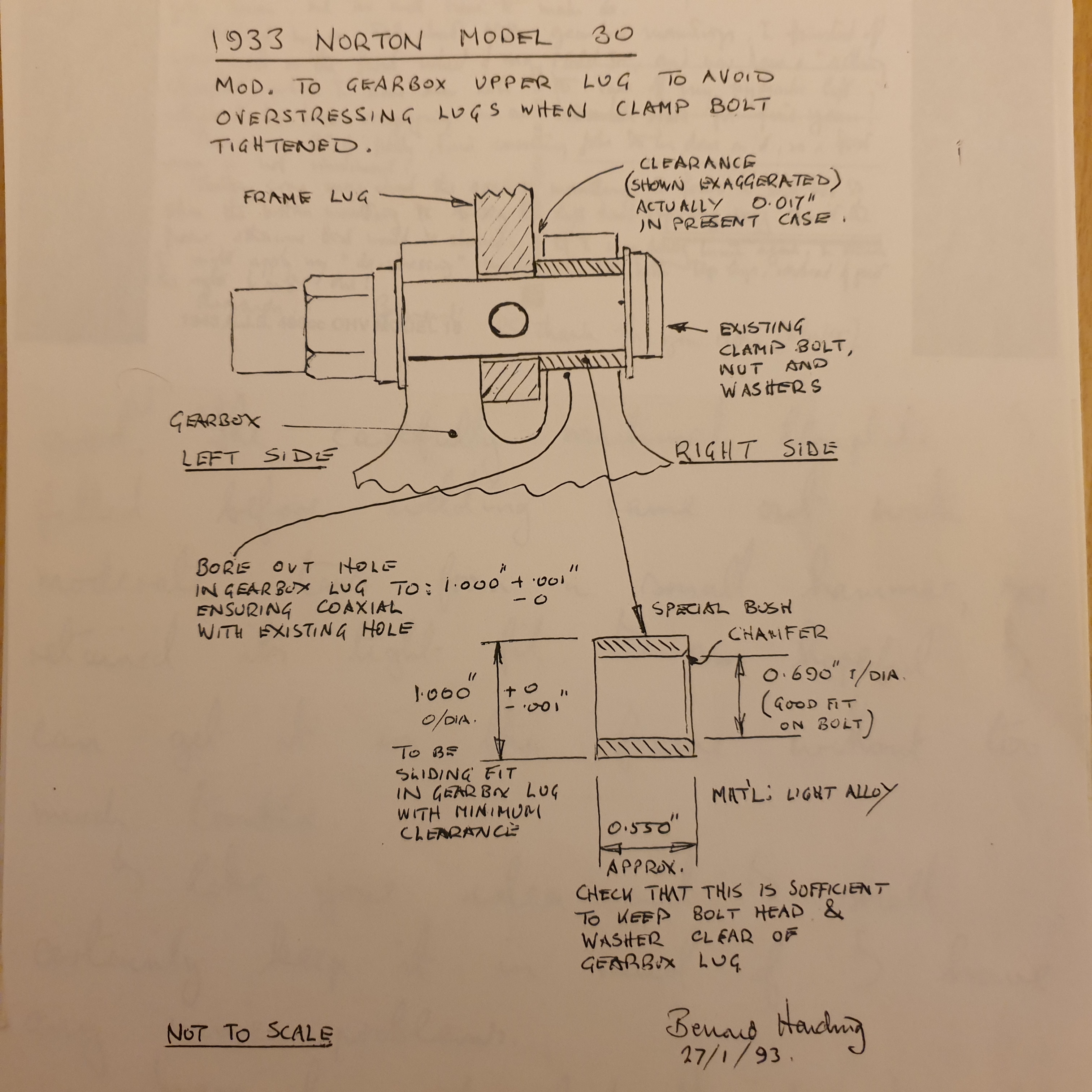

The previous owner of my Inter made the mod in the picture attached. It seems to have worked for a couple if thousand miles so far. The lugs are too thick to bend safely. The bush must be a snug fit in the lug.
Have a good look
at the state of the lug on frame and gearbox. A lot depends on how much wear there is. If it's moderate, you may be able to shim it up. The modification described by David Cooper looks good to me.

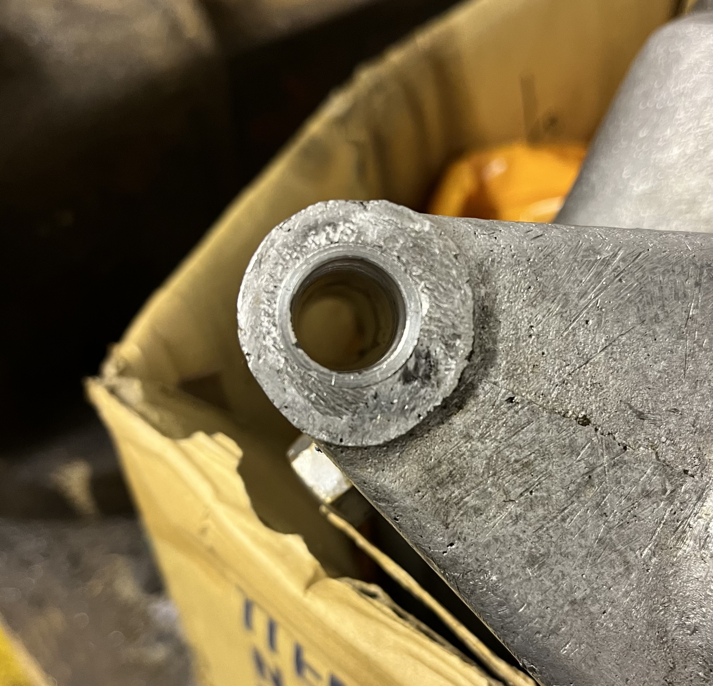

A quick update
I’ve just got the gearbox back and have had the bottom lug bored and sleeved and the top lug has had the modification forwarded by David Cooper.
They have carried out a first class job on the lugs and I would say it’s got to be better than it was new!
