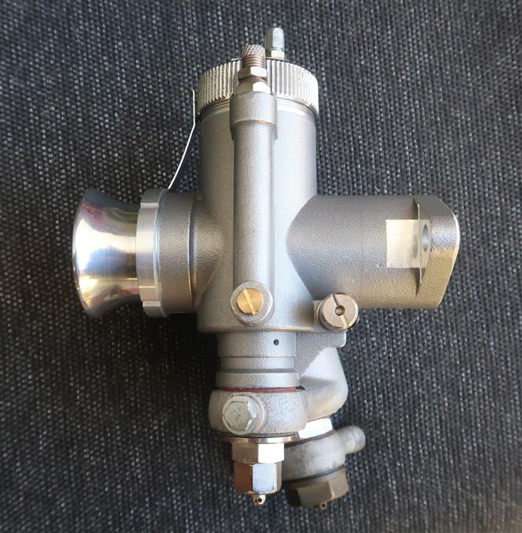

When I first got my bitza '48 Inter, it was fitted with a TT carb with the float on the right side. Not having an encyclopedic knowledge of a possible application for this odd thingy I'm hoping that someone here will know what it was meant to fit. I eventually found the correct carb and float but am still curious. Marked 1-1/8" but bored to 1-5/32".
Enrichment device
RIchard; isn't the enrichment device on the right on a gold star? Be interesting to know the angle (and direction) of the float mount.

BSA GS 1949-54 it is.......
....as I now see listed on the Amal 1940-54 parts list though actually finding a photo with the right hand float isn't easy. Everything I find is a left hand float TT or a Monobloc. Interestingly, the only other application I can find on this list is for a Grey Flash and Black Lightning.

15 degree it is....
and I also have a pre-war brass version, long body w 15 degree float. Even if this were painted, they would give themselves away with their internally threaded bell mouth. I'm also puzzled as to why Amal would make an entirely new carb for such a limited application.

The 15 degree float, is it for a left side or right side mount?
Best regards
Each of these carbs has the appropriate sided float bowl ......
.....both 15 degrees. I looked for years to find a good TT sided correctly and finally bit the bullet and bought a new one from Burlen. Big ouch. 1-5/32" being the correct size.

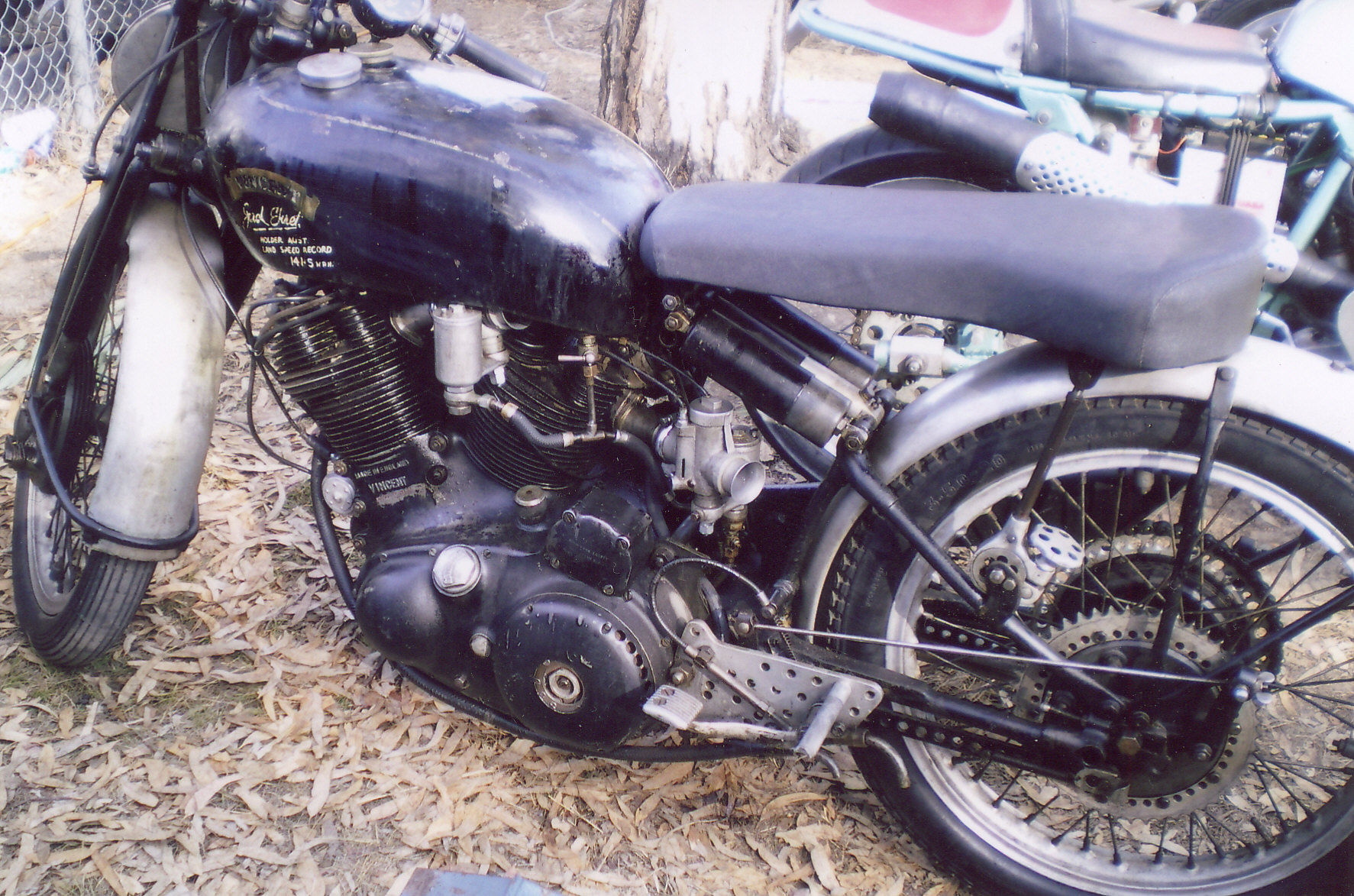

Yes Jon, I think you are right about the BSA fitment for the air slide. I thought the monobloc carbs didn't come out until 1954, but I may be wrong. Norton didn't fit them until the 1955 season (late '54). I think all the road spec series C Vincents used 276 and 289 side float carbs and series D used 376/389 monoblocs, but you would need to check with a Vincent expert for that. TT carbs were not fitted to road spec Vincents, unless to special order. The racing Black Lightning engines used a front type cylinder head on both cylinders to enable a larger inlet port, which was not possible with the rear type head.
David/Michael, the aluminium used on the TT, RN and GP racing carbs was a better quality than the Mazak used on the standard road types and is a lot more robust. The brass TT carbs were made along with the aluminium ones and I have a brass TT38 with the small later type bellmouth as used on the later versions. PHEW it's a minefield to track down all the variations.

I replaced the correct narrow parallel slide return spring in my early brass TT carb with the later conical type after I had a couple of random incidents of the slide being reluctant to drop back down. The conical spring needed small tweeks to fit. I imagine it was introduced for the same reason. Another little change. The biggest change being to the intake ( which opens out much more quickly on the early carb) and the corresponding bell mouth which is simply screwed to the outside.
And talking of bell mouths for the early TT. They are not made to the original design any more, but the later large size for concentrics will fit. But you should use a spot of Loctite or it will come off on the road (like mine did...)

A R/H Bowl TT was fitted to the 1954 BSA Road Rocket. The TT carb with the external thread for the bellmouth is I am 99% certain an AMAC carby. The AMAL TT was an AMAC copy with small alterations. Mod 30 International Nortons had 1 5/35 long bodied brass TT9TT carbies with a L/H 15 deg. float bowl. I have a handed pair of GP Carbys which I am told came off a GP Triumph. The only Lightning I have had anything to do with had TT's on it. This bike had only 3 owners and 2 riders before I became aware of it in 1962 and had been parked up since 1957. It exists today externally correct but internally de tuned and still with the TT's The clip fitted, handed TT's can be seen on the bike in the picture. The picture was taken in 2009. The AMAL parts list for 1950-1954 lists the Lightning carbys as being bolt on, but, all the others are clip mounted including the Grey Flash which has the same mixing chamber part number.

If this is a short neck body and 15 degree float, it is most likely to be from an early BSA Gold Star ZB. There may have been other appliations, perhaps Excelsior Manxman or similar.
